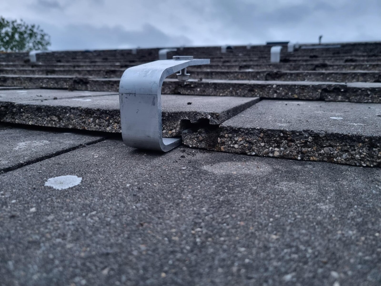

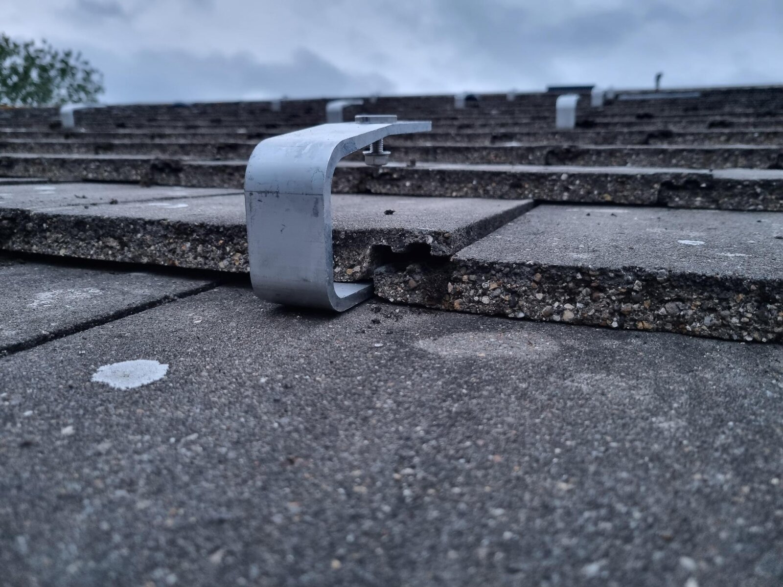

Hello
My roof has Redland Mini Stonewold roof tiles. I am having solar PV installed and the installer has gone round the roof and placed hooks everywhere.
However, every single tile with a hook is raised and does not now sit flush. I think this will lead to leaks or wind noise and potentially other damage.
Could any roofers and others let me know your thoughts on this and whether I am being over cautious? Thanks.

Garbage. Lazy garbage at that.
Can't add much to what the others have said, except it isn't professional to leave it like that.
Thanks I will be raising this with the installer.
One other question for people: within this video
The installer shows how he cuts notches in the tiles but also states that he raises the hook to ensure its not on the tile as otherwise it will causes the tile to crack.
Looking at the hooks my installer has placed down they seem to be on the tile too - have others had similar experience of tiles cracking due to this?

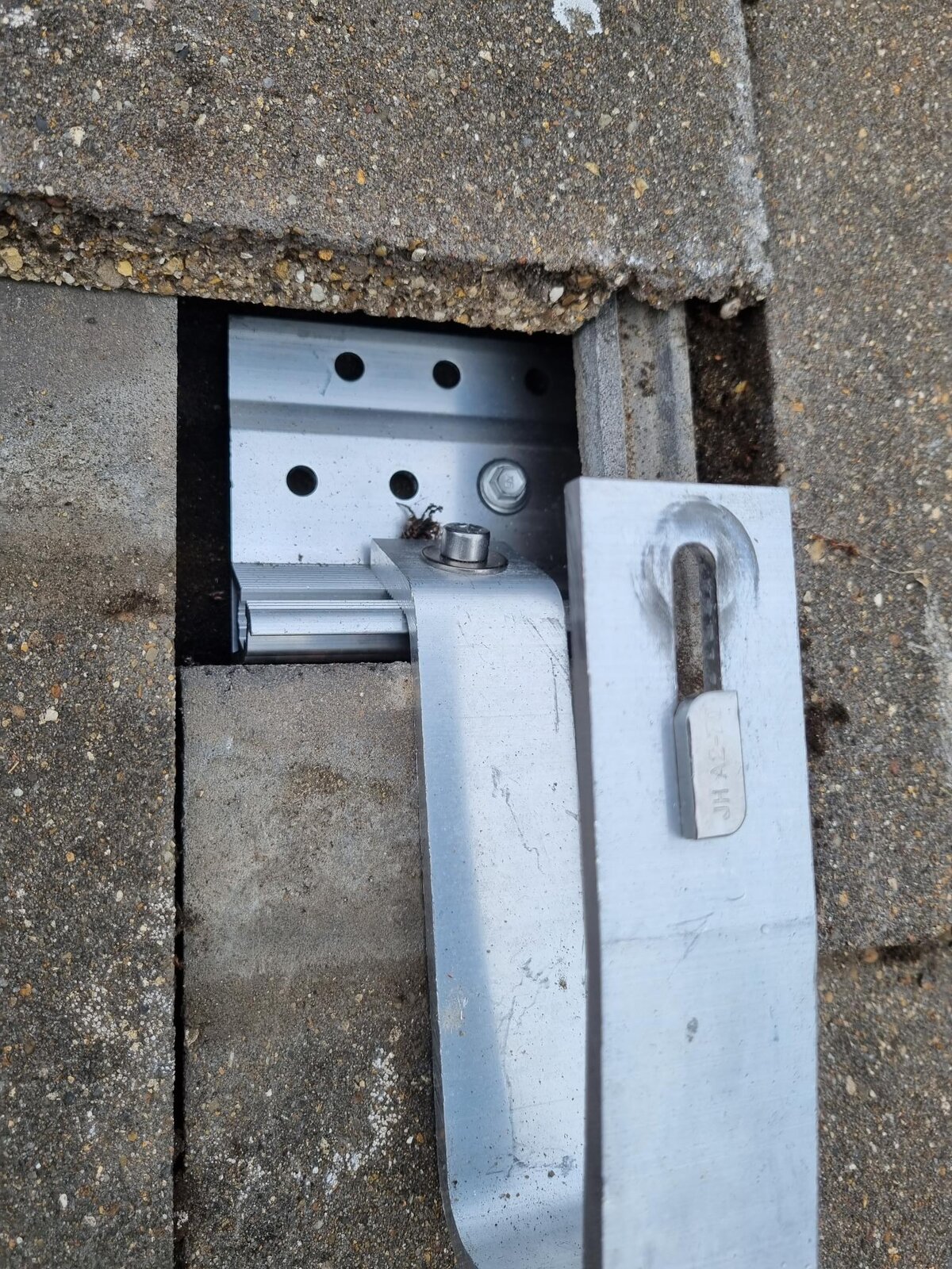

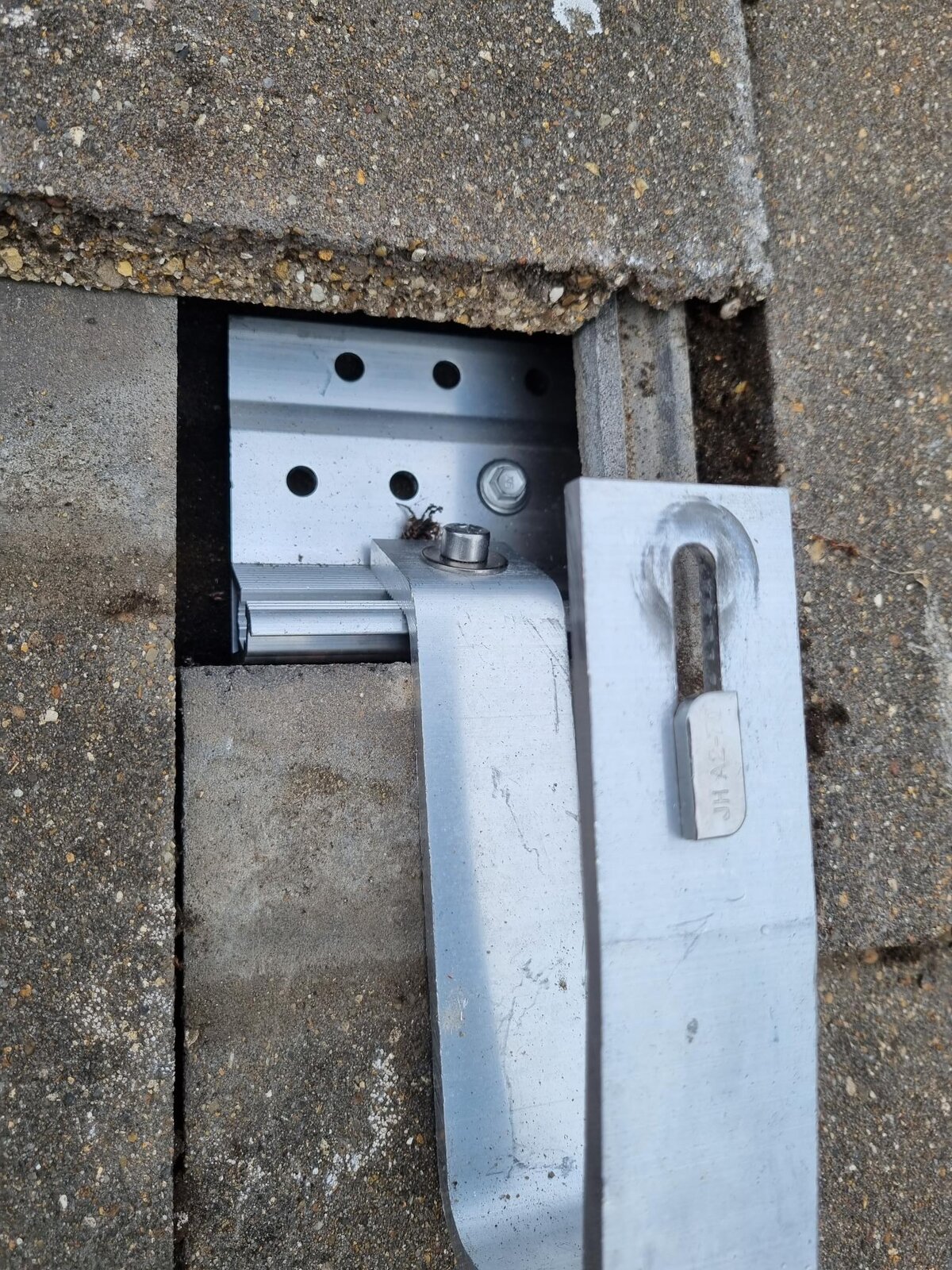

I lifted up one of the tiles and the solar installer only put one screw on the hook. The video I posted early states to put in a minimum of two. I will check what the MCS requirements are.

Check the hook manufacturers instructions. Probably specs 3 fixings? Those tiles need grinding as you have mentioned...
