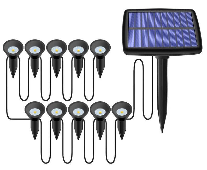

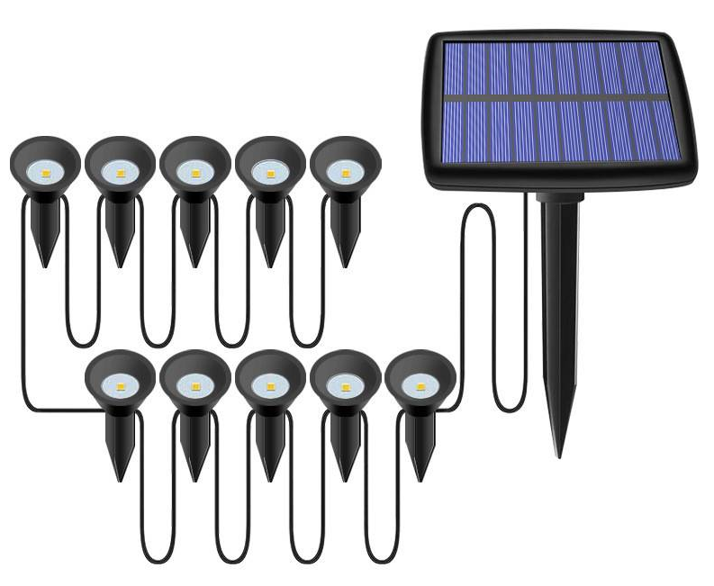

Likely you could build some yourself, use a solar panel designed for a caravan to keep battery topped up with a few 3 volt lamps maybe 3 in series so 9 volt instead of 12 volt, some thing like this may produce enough however I went to using two 12 volt batteries and swapping them around as the solar panels did not seem to cut it.
Maybe some thing like this 1700441867614.pngwith the panel outside may work.
