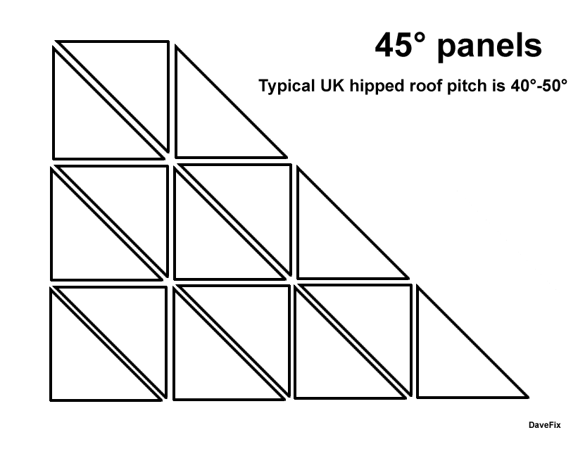

You could still use the same triangular panels throughout, but have two where you would normally have a single rectangular panel. So only one string should be required.
Since solar panels shouldn't be placed too close to the roof edge, 45° triangular panels should still suit the typical 40°-50° UK roof pitches.
