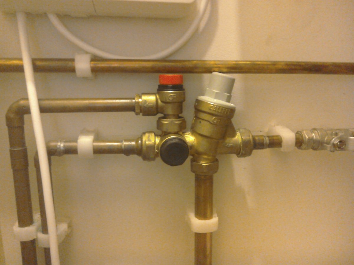

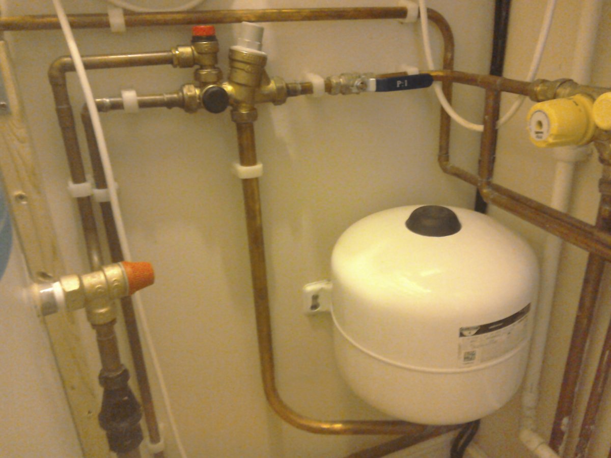

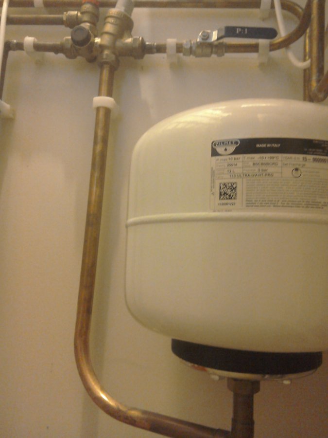

We have a leak into the tundish valve on a solar tank installation .
After doing some research we suspect that the original installation is in correct .
The e\v appears to be piped into the balanced cold take off on the cold inlet valve assembly.
Please see photo
Can someone please confirm this is ok?
Many thanks
Stewart d

Yup, you're right. That EV is as useful as a chocolate teapot at the moment, being before the check valve!!
Get in touch with the original installers ASAP if it's a newish install, how long has it been installed? Even if it's been a while there should be a case to go back to the original installers anyway as that's not been installed correctly. Alternatively contact a qualified un-vented professional to get it corrected ASAP. Whatever you do, do it as soon as you can.

Couple of things to think about -
  • The TP Valve should not have overflowed, the outlet of the tundish should be adequately installed to cater for the flow from the TP Valve without backing up.
  • 2 issues (leaky PRV and TP valve failure) after only 18 months
  • An EV that isn't connected correctly, which may or may not have caused the previous issues
  • and .... did someone fixed these issues without noticing the EV wasn't fitted correctly, it should have been one of the things to be checked if a TP relief valve had let go.
I'd maybe get a reputable independent in to give it a once over safety check, any un-vented should be yearly checked, solar or otherwise as they can be dangerous. Make doubly sure they have an un-vented (UHW) G3 qualification, it's not a given. Have you manged to check the benchmark, is it completed correctly and do you have a notified cert from the LABC/CPS?

The immersion heater in your cylinder should have both a temperature control thermostat and a separate manually resettable overheat cutout. For the T&P valve to discharge due to temperature, both of those devices are either not present, not properly connected or unexpectedly both failed at the same time ! The latter is most unlikely.
So the expectation is that the cylinder is potentially unsafe.
Since the problems probably result from an incorrect installation, I would also think an independent engineer would be preferable.
