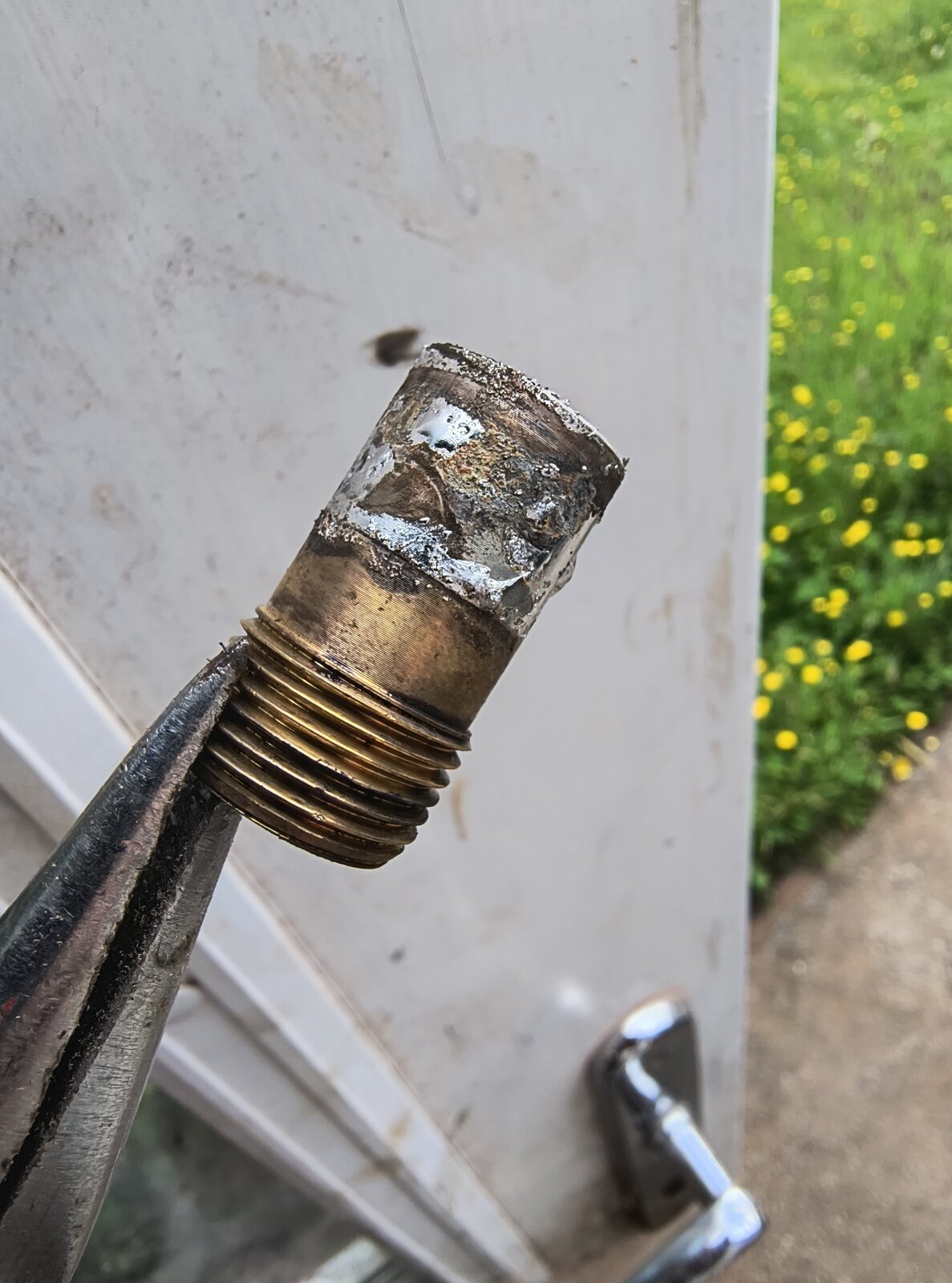

It's the brass tap connector. I'm (clearly) not great with soldering. It was cleaned and fluxed etc but weeping. Is it possible to "repair"? I think better to just redo it - can I just clean up the copper and brass with wire wool (do I have to get all the old solder off?) or just start again with new?
I would suggest the section that has the weep is replaced and make sure you use an active flux and even add a small amount of extra solder to each joint just to be sure of full coverage. I prefer the bare type of capillary fittings and then add my own solder after using an active flux.
The post mortem result is in - clearly the OP is crap at soldering. The other 2 joints on the tee were fine when dismantled, nicely tinned throughout. The failed one was cleaned and fluxed but as you can see is crap - no Idea whether it needed more or less heat because it's brass or whatever. Need to watch some YouTube videos or travel back in time and swap my sociology A level for a plumbing apprenticeship!
Yup, not a normal way to connect those flexi tails TBH. They are usually mounted into a compression fitting being either an ISO or brass coupler.
Given it's thicker brass it probably didn't get hot enough before the yorkie's solder ran and the brass then wasn't hot enough to take it. If it had been end feed then it could have been heated that little bit more, brass will always take more heat than copper before the solder will take to it.
Getting the right amount of heat can be difficult especially when not doing plumbing soldering regularly. May suggest you try the following :-
take all the copper pipework away from the plastic, (should be obvious but we all make mistakes especially when in a Hurry),
Clean up the brass element, (meth's, wire wool and or abrasive paper) you want it all to be clean and shiny,
If the existing copper to copper joints are still pressure water tight leave them alone,
Clean up the inside of the 'T' fitting where the brass element will go,
Flux all the joint faces,
Hold the brass element with something that doesn't conduct heat,
Apply heat to the brass element - when it gets hot apply a little more flux - when that bubbles than offer it up to the copper still applying heat,
When the brass fitting slides fully into the 'T' then apply plumbers solder to the joint edge and check it runs all the way around the fitting.
When cold re-assemble and then check for water (air) tightness.

Have to disagree - we were always taught that the flux should only be placed onto the pipe, not into the fitting. If there is flux in the fitting then that will be pushed into the fitting internals when the pipe is inserted, That excess flux will then pull solder into the fitting, rather than just soldering the pipe section, not ideal, especially if the solder snots, as it could then cause a restriction/noise.
I also have to say too, once a yorkie has been used it shouldn't really be re-soldered. Was always our best practice to heat & demount and use a new fitting, as you never know what effect that extra heat may have on the other joints.
Again though, those tails adapters aren't usually used for soldering, they're more designed for compression fittings unless soldering into another brass fitting.

As madrab has said not the right way to do it and the other thing is that solder on piece can cut the rubber washer in the flexi - you can get flat top ones or some people file the end flat
