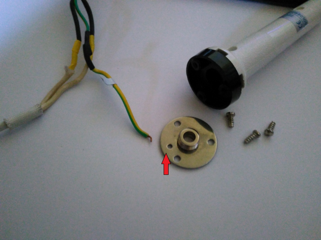

This is a cheap soldering iron with a ceramic core.
(Actually this one https://cpc.farnell.com/duratool/zd...ldering-kit/dp/SD01157?st=30w soldering irons but there seem to be similar ones out there)
It stopped heating and I replaced it with a better, more adjustable one.
Then I discovered that it is possible to repair plastics by melting them together with a soldering iron. Wouldn't want to use my more expensive iron for that so I took the cheap one apart to try and fix it.
Found out I could buy new heating cores very cheaply but with longish delivery times and it isn't a priority.
Iron has sat around in pieces for a few weeks - screws were in a magnetic dish/white board on my desk. One of my children has been fiddling and admits to dropping it - so possible I've lost a screw.
I can't remember or work out where to attach the earth cable....there is a 'spare' hole (red arrow) if I had a suitable screw I'd think it was attached to. If I thought it wasn't obvious I would have taken a photo... if it is supposed to attach with a screw I can probably find one I could use.
But looking at images online of similar irons I can't see clearly whether they do have a screw in that hole or not...in fact in one it looks like it doesn't. I could attach underneath one of the other screws.
Is it ok that it attaches so directly to something you touch?
When it so close to being 'fixed' I'm reluctant to give up -but I don't want it not be properly earthed/dangerous ...or block a hole that is for cooling or something.

Duratool have a website with a contact email, it might be worth asking them direct (I have had replies to similar enquiries made direct to a far East manufacturer in the past).
duratool.com/aboutus.html
The earth connection is needed because the metalwork is exposed, so it is perfectly possible that this small hole is for the earth fitting. But you don't necessarily know what else has gone missing/is broken so ultimately it might be wise to scrap it given the price.

I think I might email duratool ....not sure how helpful they'll be, but worth a try.

Just looking at the length of the wires, and the fact that the arrowed hole doesn't look as if there has ever been a screw there......could the earth wire pass through that hole, and attach somewhere in the ceramic holder?

It all depends what your going to be soldering, many soldering irons do not have directly grounded tips.
If you do a bit of googling, an Ian.M suggests why they should be grounded at:
http://www.eevblog.com/forum/chat/does-you-soldering-iron-have-grounded-tip/
However many well known brands do not and simply have a ESD ground point for users to use.
Cheap ones most likely do not too.
I know that having used a grounded soldering iron on a TV that was unfortunately still connected to the main caused a big bang/more damage many many years ago when touched with the iron (oops!).
