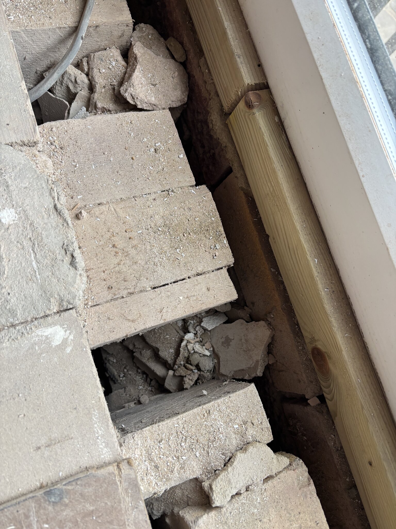

I’m having sliding doors fitted. I already have the opening in place and just had the survey for a 2 pane, 3.7m glass sliding doors. The back of my house is about 3ft higher than ground level so we have decking that you step onto and down stairs.
The doors have a 125mm track and typically sit about 25mm back from the outer edge of the outside course of brick, so basically I need 150mm solid base for it all to sit on. My outer course of bricks are 100mm wide but then there is a cavity approx 50mm wide then joists (see image). What is typically recommended in this situation to strengthen/widen this area ready for the new doors?
Can they just over sail into the cavity a bit? Or has someone specifically said the whole 125mm needs a solid base. I’d think given the doors are fixed at the sides and possibly the top, you should be ok…

I’ve only heard from the surveyor / sales guy of the doors. He told me they need ~150mm base (125mm track + 25mm sat back from outside brickwork) for it to all sit on. So not an actual door installer or builder yet.
I was thinking is there any benefit in buying some sort of steel plate to sit on the top and cover the cavity gap? Maybe 150mm-200m wide so it sits on the outer course of bricks, covers the cavity and then sits on the inner course of bricks & joists?
Don’t think there’s any point in a steel plate. You could shove dpm down into the cavity to form a trough and pour concrete in, up to the level of the top of the joists which is made a bit more awkward by the joists being there but guess it’s an option. But I’d check in more detail whether that’s really needed from the door perspective

Go back and tell the surveyor that brickwork is typically 105mm wide and the doors can sit on that. (y)

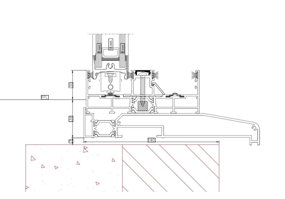

Every door system will have a sectional detail for the threshold, so get hold of that
Thanks! The doors are sold as a Cortizo ‘GS20’ sliding door, they are 2 pane / track. Is the sectional detail something readily available online? Or will I need to wait for the survey info to be sent over do you think?
