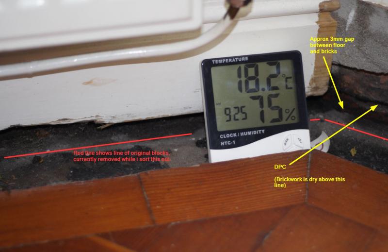

Original floor in 1920/30's bungalow, solid floor is getting damp patches at the wall/floor junction which is causing skirtings to rot where there is excess rubbish accumilated behind the skirting (saw dust from sanded parquet floors I believe). This is also causing woodlouce etc internally.
I've hacked off the skirting and cleaned out in another room to some succes but yet to tackle the worst room. In the past I used roofing felt adhesive.
I am going to tackle the last and worst room shortly, as it smells, but wondered if there is abetter product for lappgin the parquet floor adhesive (bitumen) up to the DPC (bitumen) as currently the wall/floor junction is exposed brick/concrete.

Out of interest I put a humidity metre on the floor near the damp..
Wondering now if the humidity could mean condenstation between the wall and floor which is showing up on the brick work and then making the concrete floor damp? There is a vent behind this section of wall which i guess could cool the bricks (vent doesnt appear on inside of wall).
I put a camera into the cavity recently and it appeared to be empty, or rather, wasn't obviously full of rubbish.
Wondering if the high humidity is caused by the damp, or the visa versa? This humidity meter is normally on a desk in this room, and has never shown this high... 76% at time of writing this.
In the pic above you can see the dampness on the floor - this exends to where the blocks originally were. The ones i'd removed from this section of floor were so wet i could squeeze moisture out like a sponge.

EDIT: now at 77%, so still climbing! BTW there is a radiator immediately above this which to confirm, is not leaking. And I know this damp is relatively minor (its concealed behind skirting) but this does actually extend all the way around the room. There is a smell of rotting wood in the room, small amount of fluffy mould at the base of one skirting (opposite side of room to this photo and actually an internal wall) and there are always woodlouce around!!!

If the walls are cavity and are clear, and there is that gap between floor and DPC, then rising damp my be the cause. Also, if there is no mould then rising damp would be the main suspect
If you have done the other rooms and this has worked then just carry on.
You can get bitumen based paint from the likes of wickes.
Or you can go for some professional products such as RIW, Superprufe or Ball Stopgap F75 or F76. All these may only come in quantities more than you need and may be relatively expensive to buy if you only have a small area to treat. These would be painted along the floor edge and up the wall past the DPC to form an internal surface DPM.
Then plaster down to 20mm above the floor and fit new skirting

Any moisture at that location is going to affect the humidity right there in the corner, so its not really an indication of the cause of any damp
Some readings of general room temperature, room humidity and local surface temperatures could be taken, as could a plot of a range of readings with a moisture meter, which would give a good guide if condensation is more likely than rising or penetrating damp, but you would need an experienced person to do that and make a correct interpretation of the readings and what is going on.
Limited use of a hygrometer or moisture meter won't be any good as correct interpretation of a wider area is essential.

If you take off an area of plaster you should be able to see that the brickwork below the DPC is visibly wetter than that above.
All brick below DPC level and in contact with the ground will be permanently damp despite the weather
