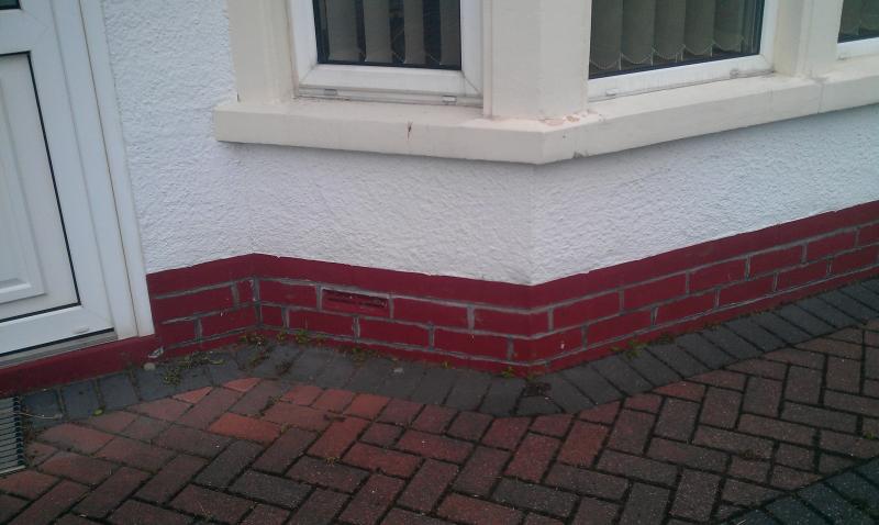

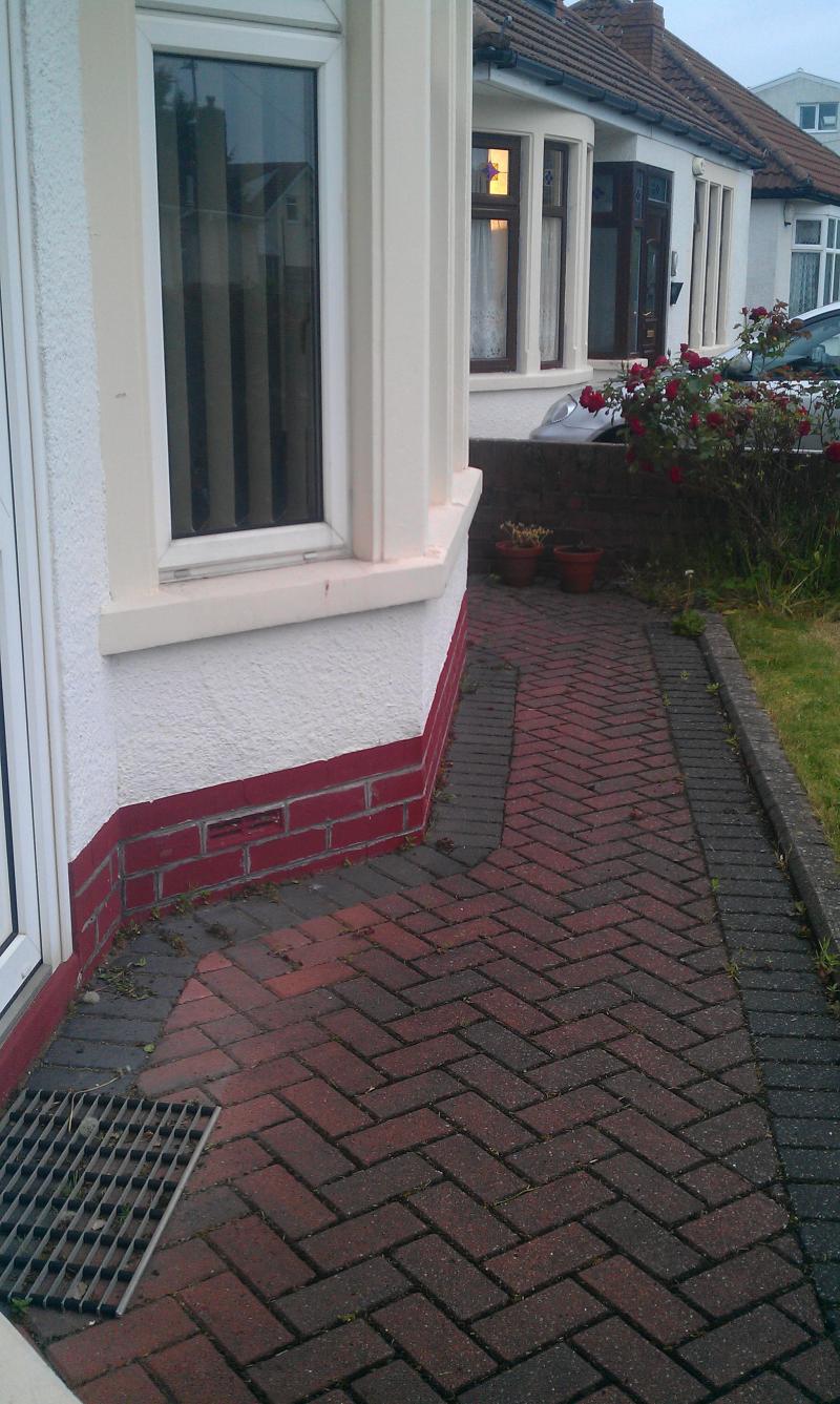

Have you got a general view of the external wall - from say 2m away showing the ground and wall, and one showing the elevation?
Thanks, like these?
The prior pics are under the left side window (seals etc look good to me, damp is all round anyway)

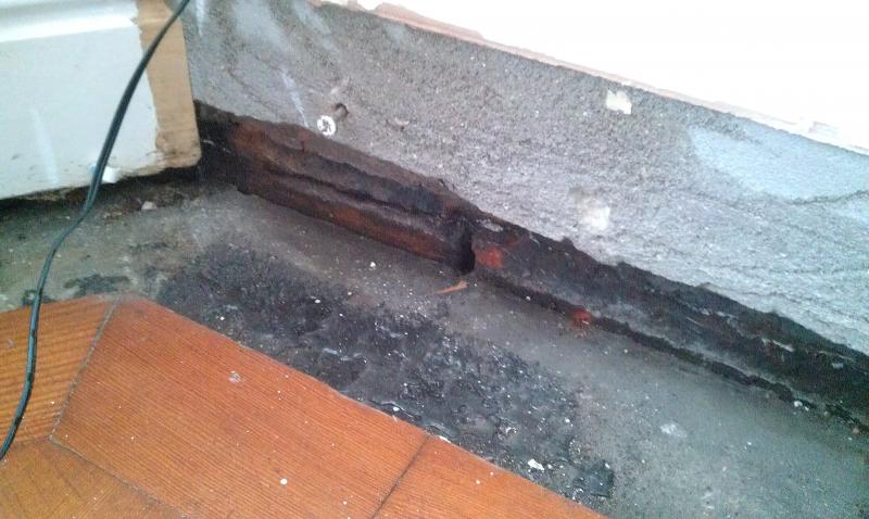

Original floor in 1920/30's bungalow, solid floor is getting damp patches at the wall/floor junction which is causing skirtings to rot where there is excess rubbish accumilated behind the skirting (saw dust from sanded parquet floors I believe). This is also causing woodlouce etc internally.
I've hacked off the skirting and cleaned out in another room to some succes but yet to tackle the worst room. In the past I used roofing felt adhesive.
I am going to tackle the last and worst room shortly, as it smells, but wondered if there is abetter product for lappgin the parquet floor adhesive (bitumen) up to the DPC (bitumen) as currently the wall/floor junction is exposed brick/concrete.

This DPC (bitumen) is it sandwiched between two bricks ie horizontal and you can just see the edge or is it painted vertical on the bricks?

Hello - it is sandwiched horizontally. There is nothing on the face of the bricks below that line of bitumen. Below the line of bitumen, it is wet in places, which is then causing a damp patch on the concrete floor. I've "fixed" it in the other front froom (second bay) by painting bitumen based roofing felt adhesive into the face of the brick and the concrete floor, effectively lapping up the bitument under the parquet blocks into the wall DPC. That worked for the most part, those in places you could see it was a little "blown" I guess caused by moisture coming through.
I am tempted to try squeeze silicon sealer down the 2-3mm gap between the floor and the wall, to see what happens..
It looks OK from the outside ... if that render is in good condition
I just wonder if the painted red bricks are preventing some natural evaporation of moisture, and instead containing it within the wall. Perhaps not a cause in itself, but just another factor to cause a wall to be wetter than it should be
If your previous methods have worked, then just carry on
Silicone wont help, and might react with any bitumen product. Just seal it all with bitumen or a different surface DPM product

Im not sure if its related but some patches of the brickwork on those bays seem to take a lot longer than the rest to dry out after heavy rain, almost looks like water is coming out of tge wall through the pointing/mortar. Maybe the paint has something to do with that as you suggest.
Render is in ok condition, i had the pointing redone 2 years ago too as it was full of gaps, didnt make any difference at all. I guess because its a cavity.

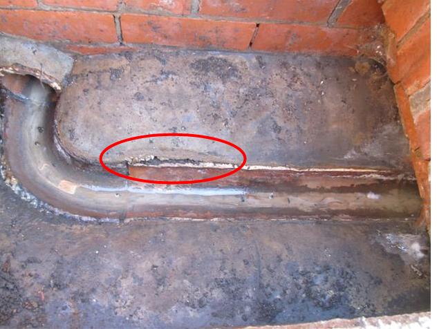

Just a thought, two houses 1930s, in my street had damp problems around the bay, both had broken U bends at the bottom of the down pipe.
Another on a 60s house was full of roots from a hedge, 4M long! He was complaining of his gutter overflowing.
Pred, thanks - was that shown up on a CCTV survey? I am thinking of getting one of those done as a sewer does indeed run via the front of the house underneath that path. No other signs, but for £100 odd it may be worth it for piece of mind.

EDIT: I lifted the inspection cover which is by the side of the damp room and near the damp soil and it was free flowing with no build up of anything, however where the toilet empties into the chamber the "jet" of water seems to have eroded the concrete near the clay gulley. Similar to this picture (which is not mine as I didnt take a photo but does demonstrate point) though my crack is slightly bigger.
Once the flush water emptied into the chamber most of it quickly disappeared down the gulley but some of it could be seen sitting inside the crack. Thats a meter below where any of the damp is appearing - can't be helping though? or is that normal?

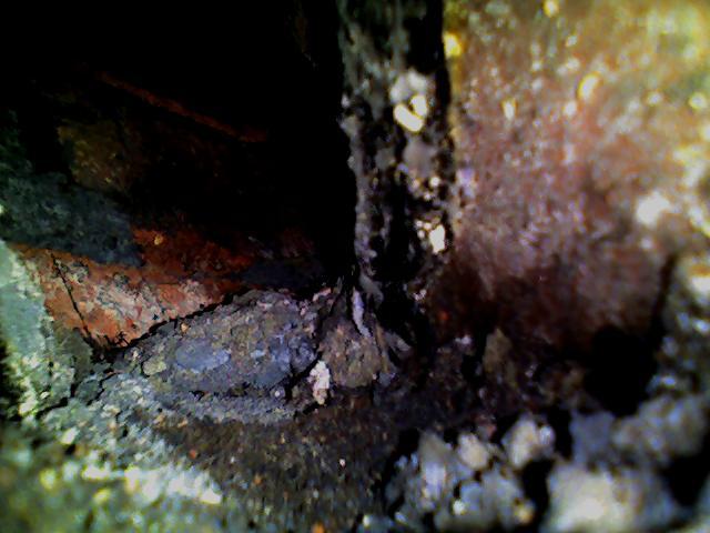

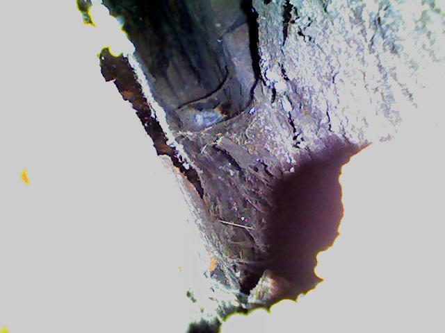

Sorry if i'm boring anyone with this but i managed to get an old laptop cam onto a stick along with the flash LED from an old blackberry, in order to get some hi-res shots of the inside of the cavity of the front bay, right into a section of wall either side of this damp spot (which incidentally, is much worse than shown in this pic, at present):
It looks like the cavity is indeed blocked up in places after all, something that I couldn't figure out on my cheapo clas olsen flexible camera as its too low res.
This shot is looking to the left, and the wall on the left side of frame is the inner leaf. The black bitumen DPC is visible, so we are just below that height:
Another left hand side shot, looking further into cavity (does look dry in fairness?)
Next shot is looking toward RHS but also upwards slightly (the DPC is vertical thick black), and clearly shows a damp spot on the rear of the inner leaf (right of frame) which corresponds to a damp spot on the inside wall.

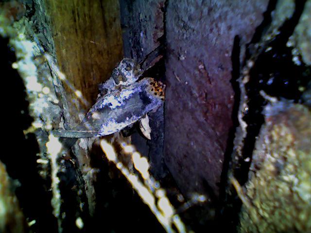

Finally, looking almost straight up into the cavity, you can see the external wall DPC on the right hand side of frame and also an old rusted wall tie. Above it is a piece of timber which bridges the cavity. Could that have been put in place by the brickie in order to keep the gap consistent? There is no damp on the internal wall above DPC level so I dont think it is causing any problems:
Any thoughts on the above would be appreciated.. havent had drain survey out yet, is booked for next month.
Me again - the cavity is pretty much full in the places i've looked, and makes it approximately equal to external ground level height and internal floor height, so the damp could very well be penetrating via the bridged cavity to the internal floor level.
What I don't think that explains, is the damp at the base of internal single skin interior walls, or could it?
