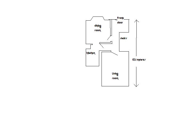

The run from the front of the house to the back is about 9 metres. Will 10mm clearance either end be sufficient for this long-ish run of solid wood boards?
One concern I have, is that there is a L-shaped wall which will be "floating" Island-like if you will..... in the middle of the expanse of the flooring. The long side is about 2 metres, and runs the same way as the boards, and the short about 70cm. I guess a more extensive dry-run all the way around this before glueing is going to be essential to make sure it's all square and looks right, but are there any specific issues with boarding around an Island I should know about?
If wood expands it is normally more in the width than in the length direction. The expansion gap has to be calculated based on the width of the room. For solid Oak is it 3 - 4 mm per meter width of the room with a minimum of 10mm. I suggest you keep the same rule of thumb for your pine boards or even a bit more.
Most important issue around your island is to make sure you leave a wide enough expansion gap around it.
Okay, all good info, many thanks!
The wood is solid Acacia. The distance i actually 10.1 metres as you walk through the front door into a small square hall, then down a 1 metre wide passage to the doorway into the living room, which forms the final 5.8 metres of the run to the back of the house.
On your advice that makes for about 30-40mm total clearance, call it 15-20 either end? I'll have to check how wide the beading is.

I've done a simple floorplan picture(In Ms Paint incredibly!) showing the layout.
The boards will run across the house, left to right if you will, so the maximum number of boards adjacent to each other will be from the front door all the way through to the far end of the living room, the 10.1 metre run.
Am I asking a lot to have no T-bar between the hallway and the living room? Is it just a bit tricky or a complete no-no? Ignoring the wide archway between the kitchen and dining room areas, maybe with the intended board direction, it might make sense to use a T-bar between the living room and the rest, creating two areas only?

Specially hallways should be treated as a separate area - the temperature is normally different than in other areas: thresholds!
Another benefit of using thresholds is that you can change the direction of the boards in all areas to the most eye pleasing one = lengthways mostly
And if you are the one hoovering, just be careful over the T-bars - you'll thank me in the long run by adding these to your floor.
