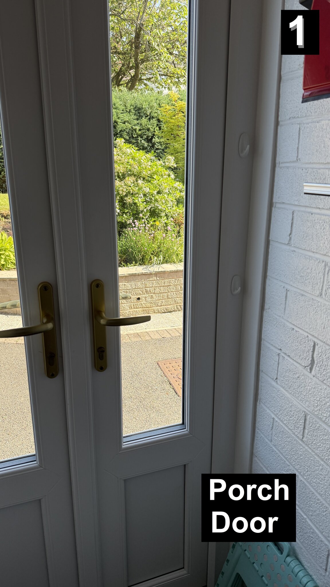

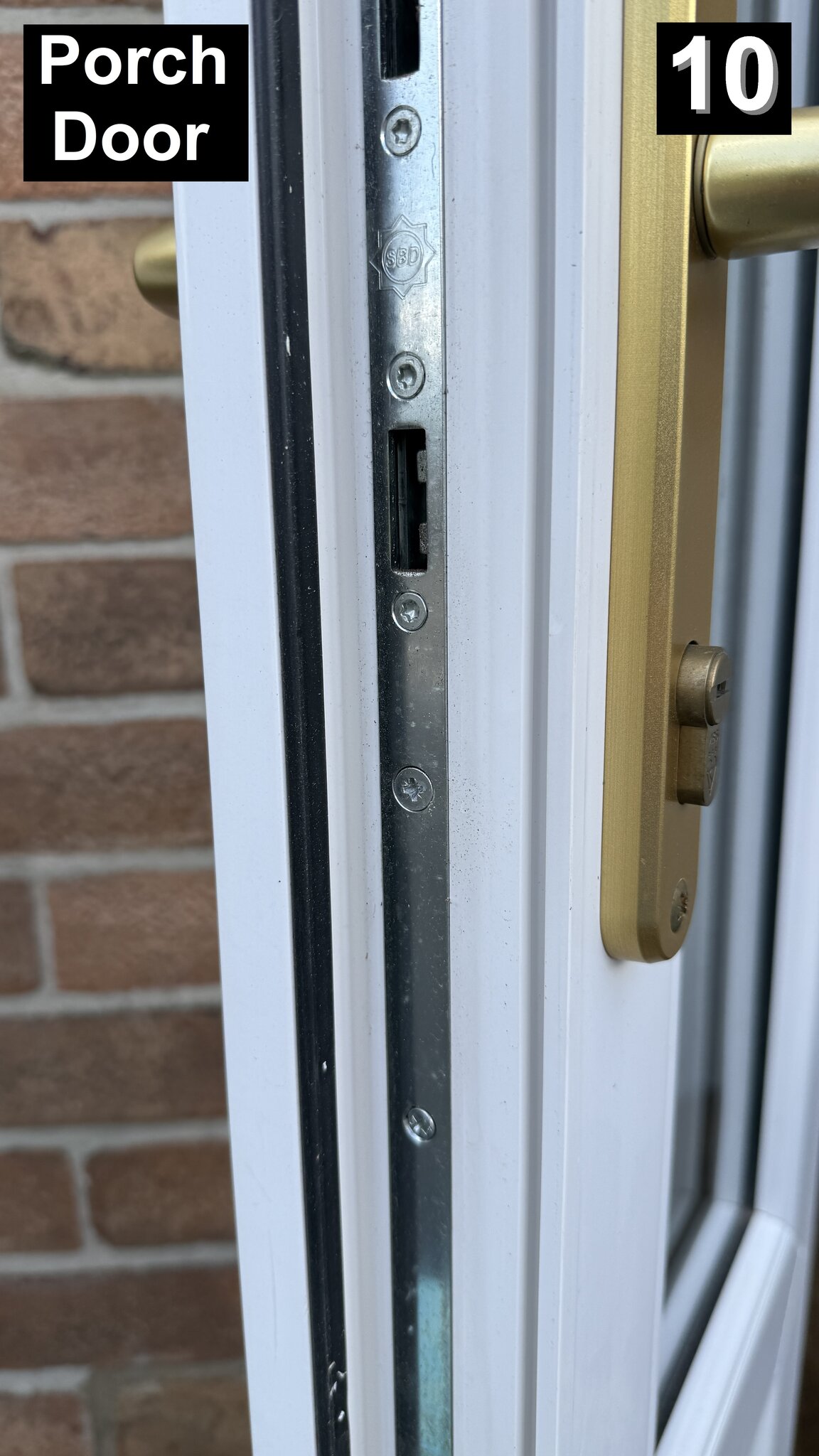

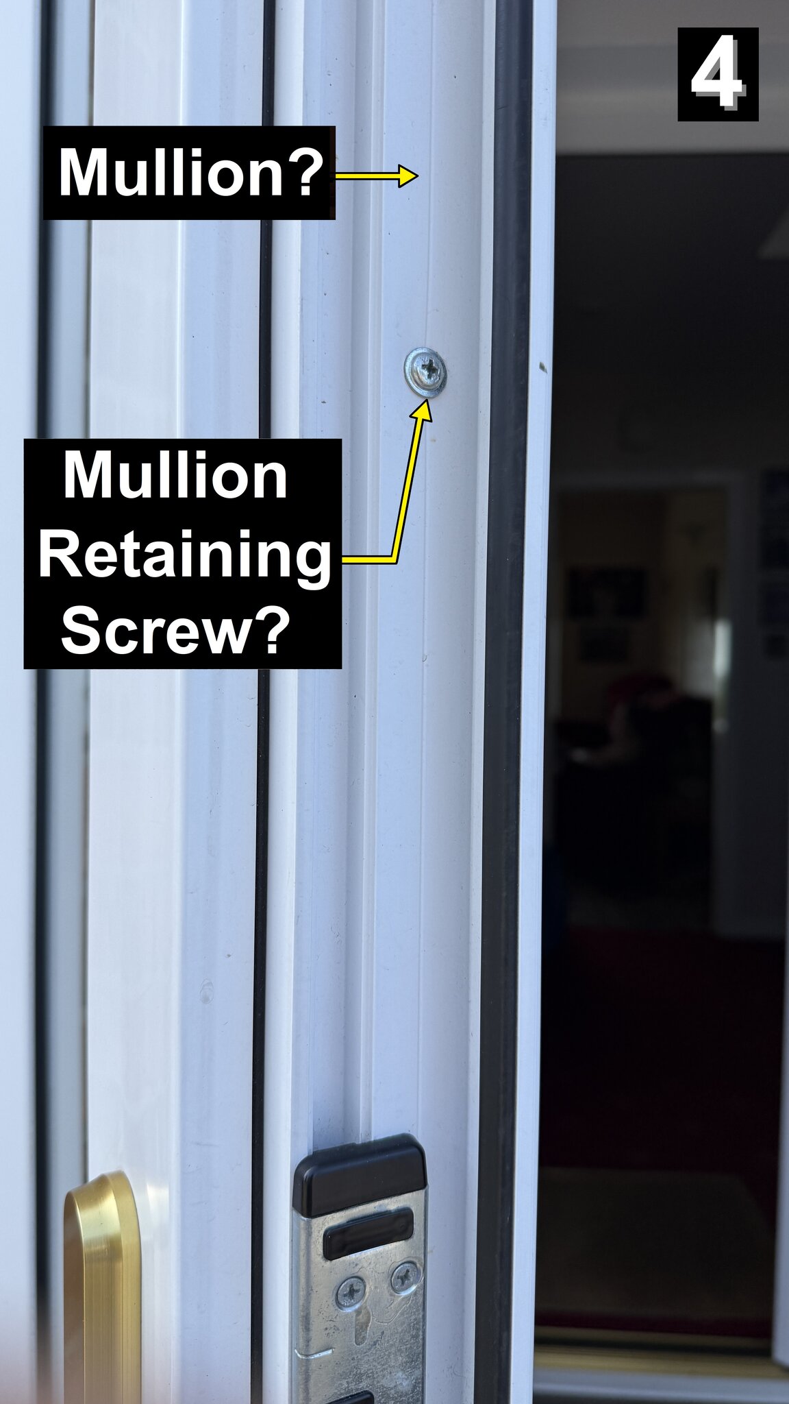

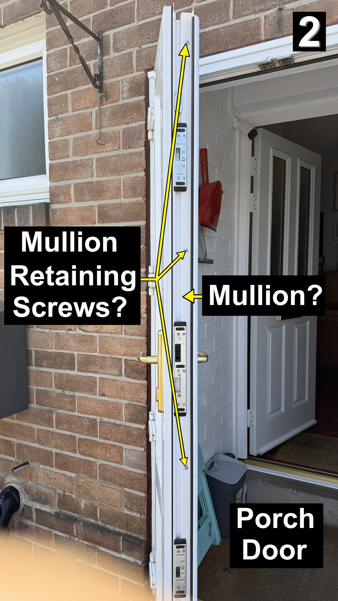

The other door is one of an outward-opening pair of half doors on the porch (looking from inside, the left-hand door - the one that is opened first - has an easily accessible retaining screw, the right-hand door is the problem door). This will be referred to as the 'Porch Door'. I gather that the second door of the pair to open is referred to as the 'slave'. On some of these doors there is a mullion that needs to be removed to reveal the lock retaining screw - but as far as I can tell there isn't a removable mullion.

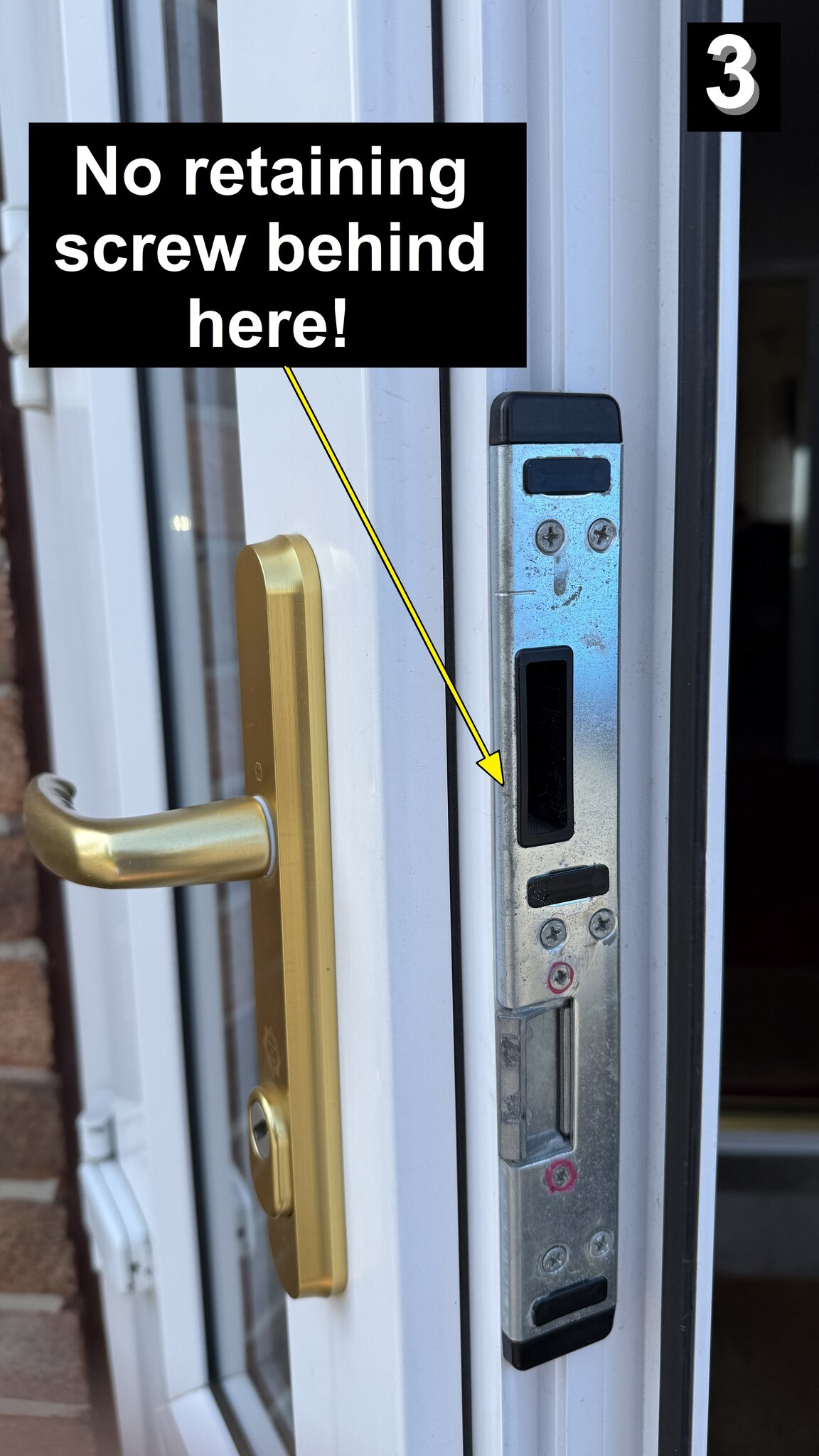

I've taken off the catch plate/striker plate (not sure of the correct term) from the right-hand porch door, thinking that the retaining screw for the cylinder was behind that - but nope! There is nothing but solid plastic behind and no 'hole' for a retaing screw.

Pictures 1-4 are of the front door.
There may be an attached bit to the right-hand door (mullion?) There appear to be 4 screws that may retain this but I havent tried to remove this piece yet!
There is no lock retaining screw behind the catch plate/striker plate (not sure of the correct terminolgy here) shown in picture 3.

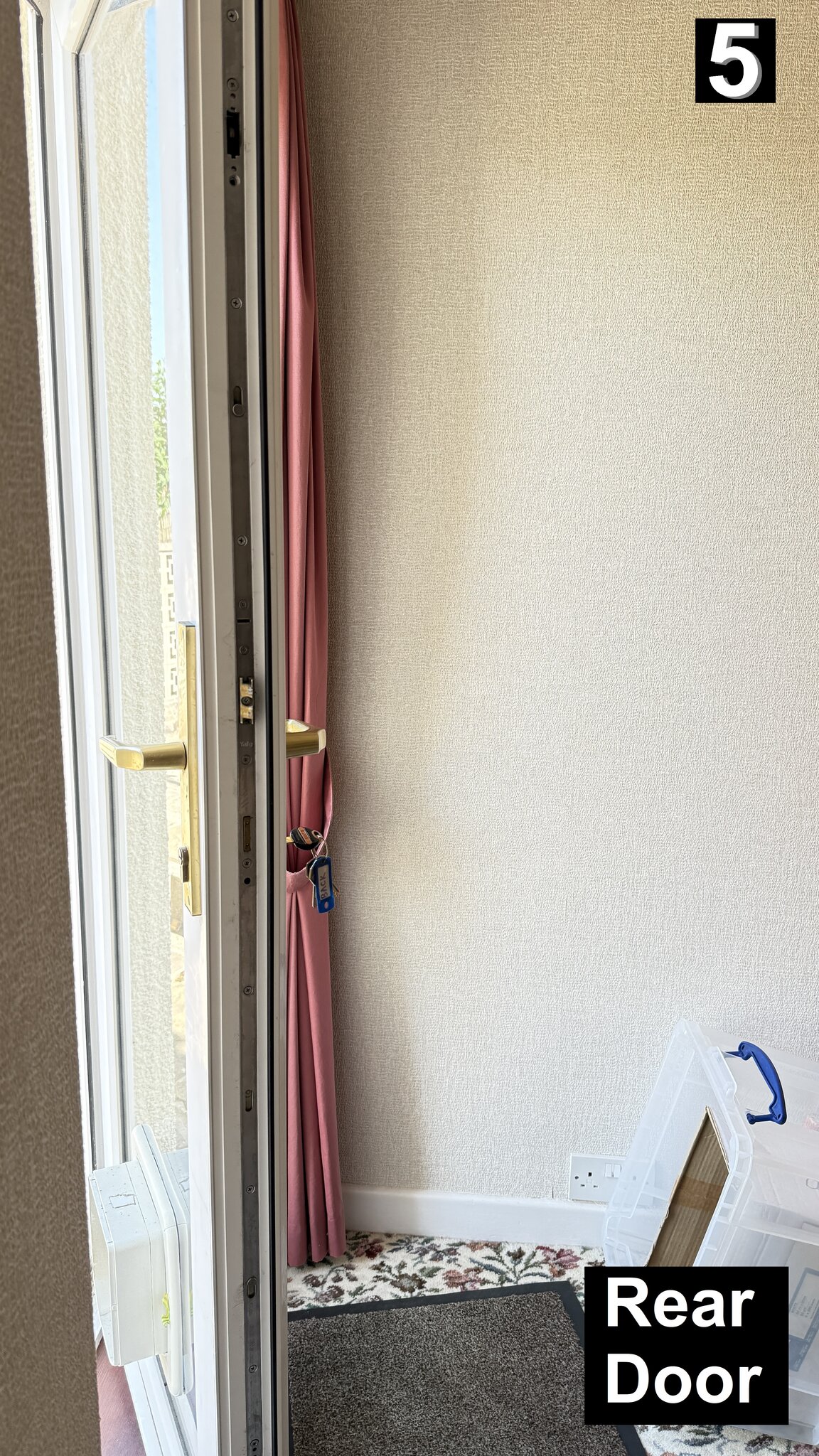

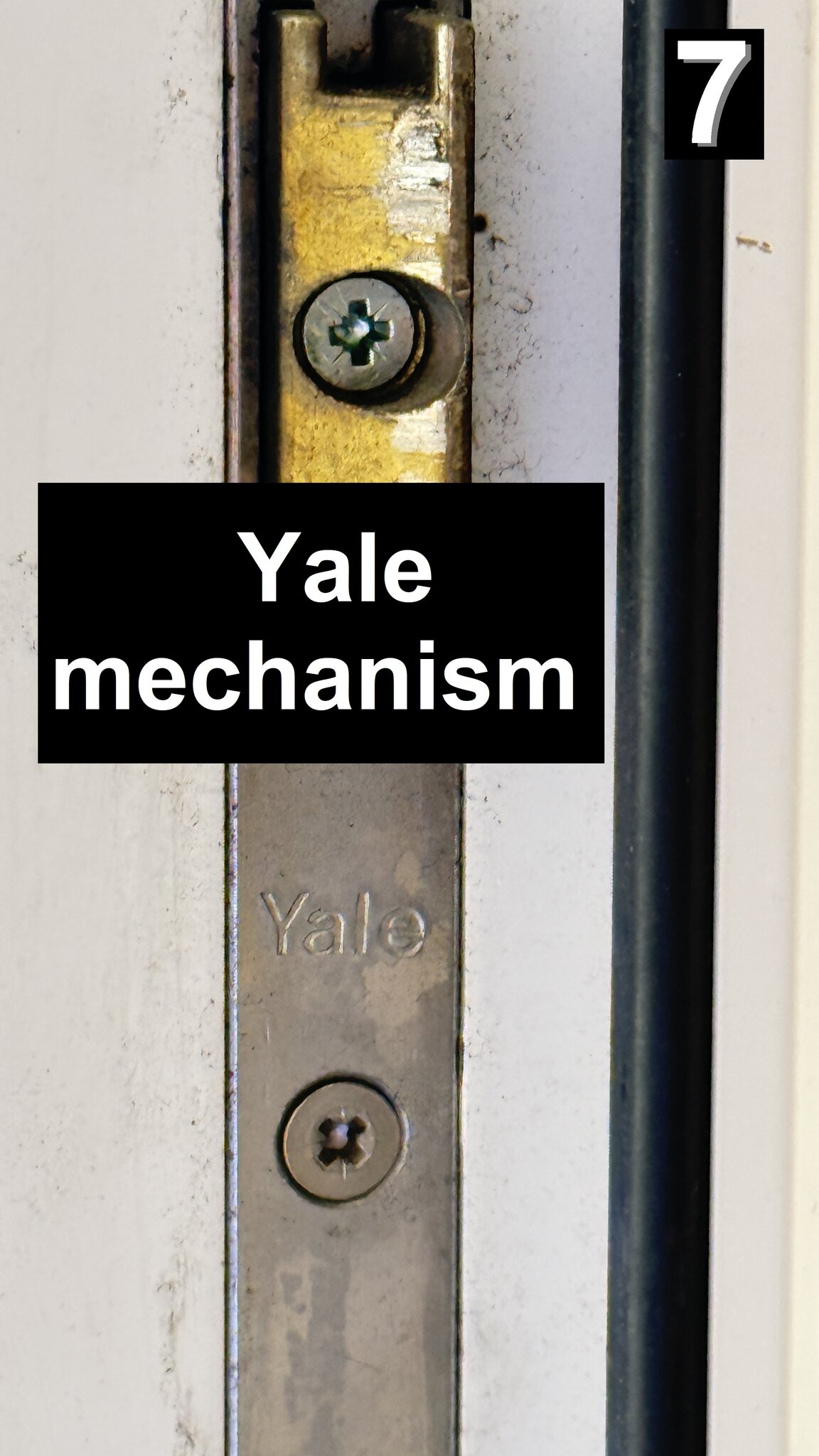

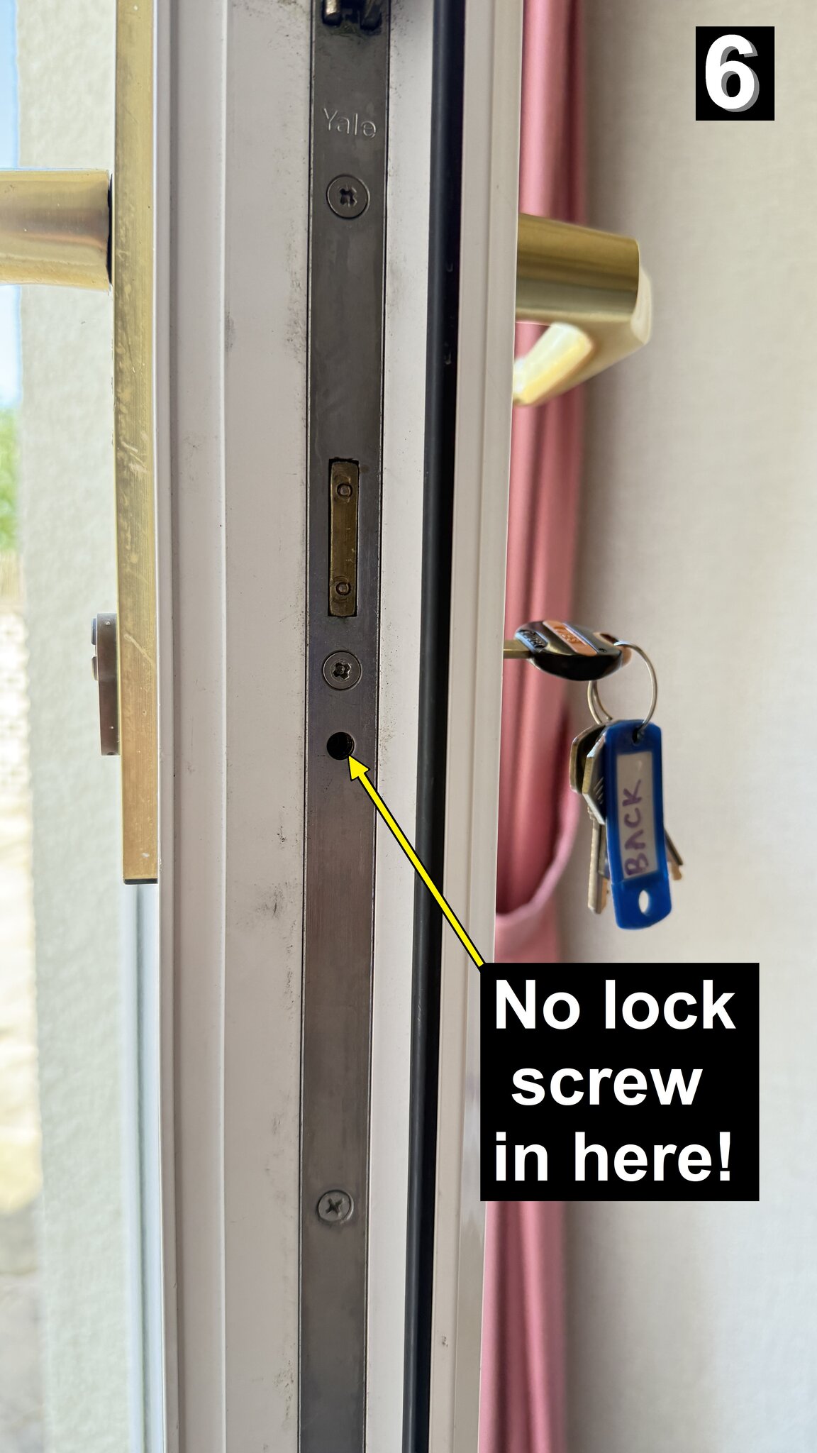

Pictures 5, 6 & 7 are of the rear door.
There is a hole in the side of the door, directly in-line with the place where the retaining screw should be - but there is no screw that I can see in the hole and a screwdriver certainly doesn't find one.
The side of the door has a metal plate which is retained by around 10 screws. There are two 'hook-shaped' arms whose mechanism screw to this plate. There is, of course, the main mortice lock in the middle of the door.
I don't want to have to dismantle the locking mechanism (if that is what is needed) amd will resort to calling a locksmith or window company to replace the Eurocylinder for me (the dimensions are 45/55 - external number first).

I'm game to remove the mullion (if that is what it is) on the porch door to see if I can see the lock retaining screw behind it but I DO NOT want to take apart a complicated locking mechanism on the rear door and end up with a door that I can't lock.

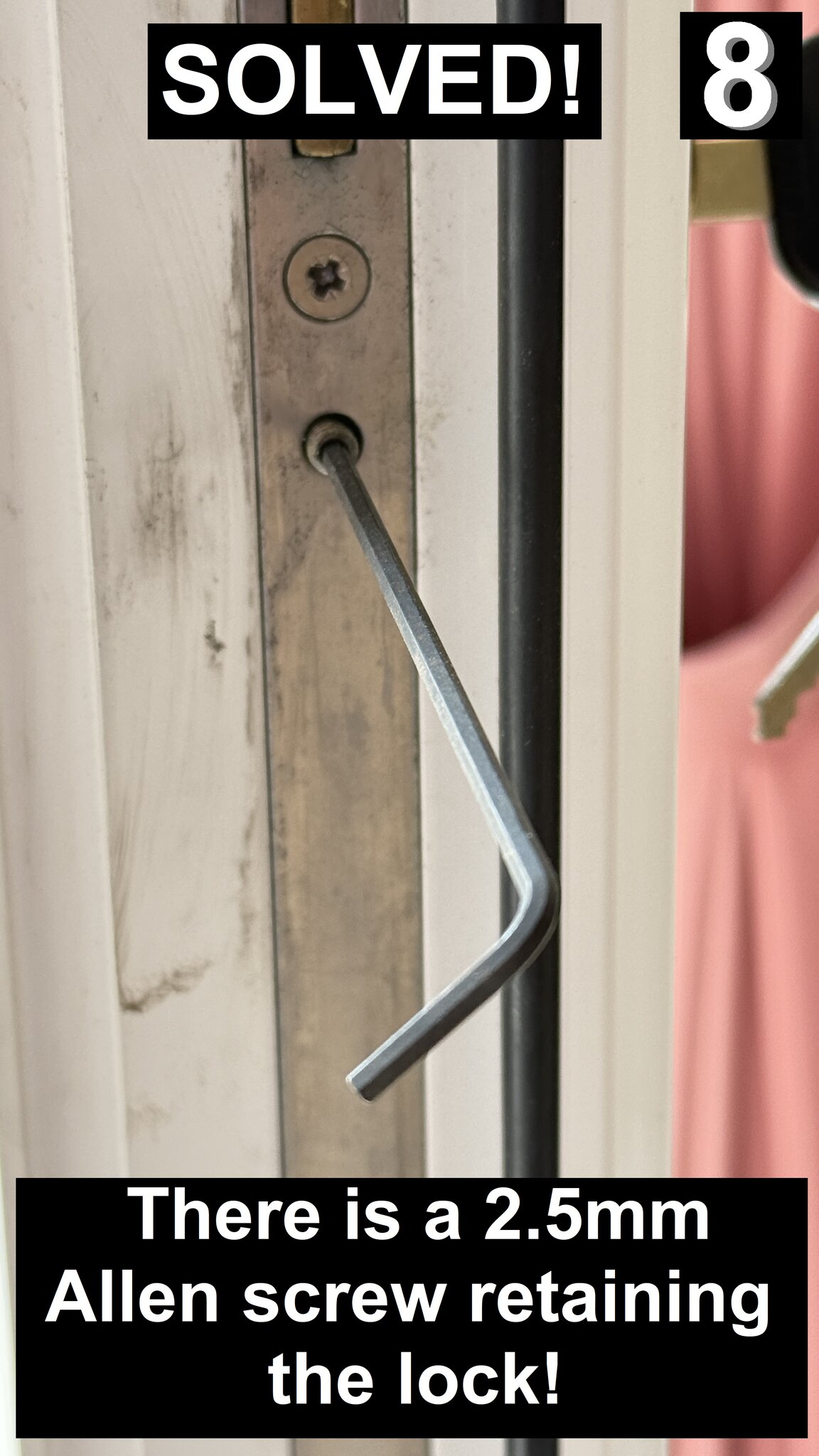

Rear door is solved!
There is a 2.5mm Allen screw retaining the lock.
I was pretty sure that (a) we hadn't given the company (Everest I think) making the door a lock to fit and (b) that I'd replaced the lock myself sometime in the past.

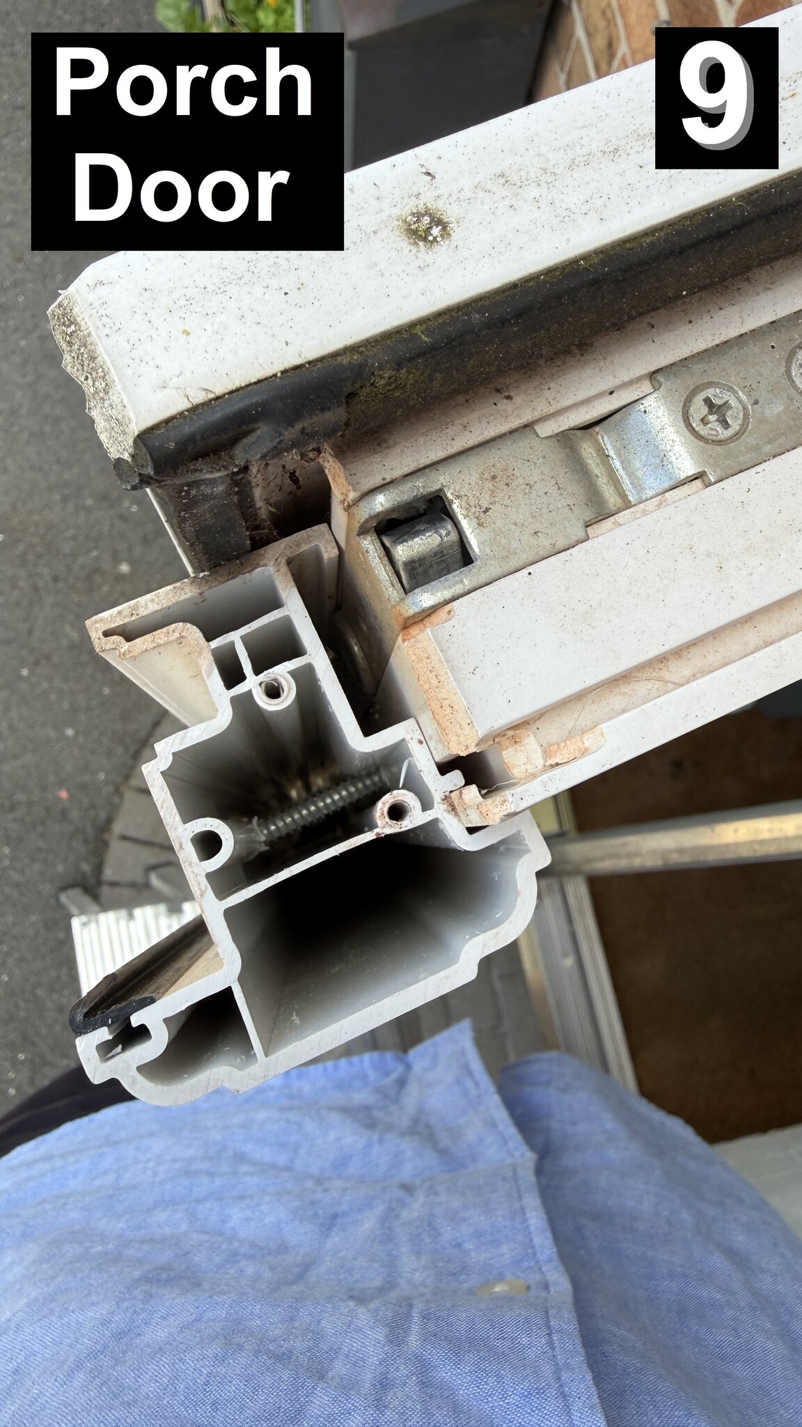

You need to remove the mullion to expose the locking mechanism then it's as simple as removing the cylinder retaining screw
Sorted.
I managed to do this before I saw your post, but thank you nevertheless!
