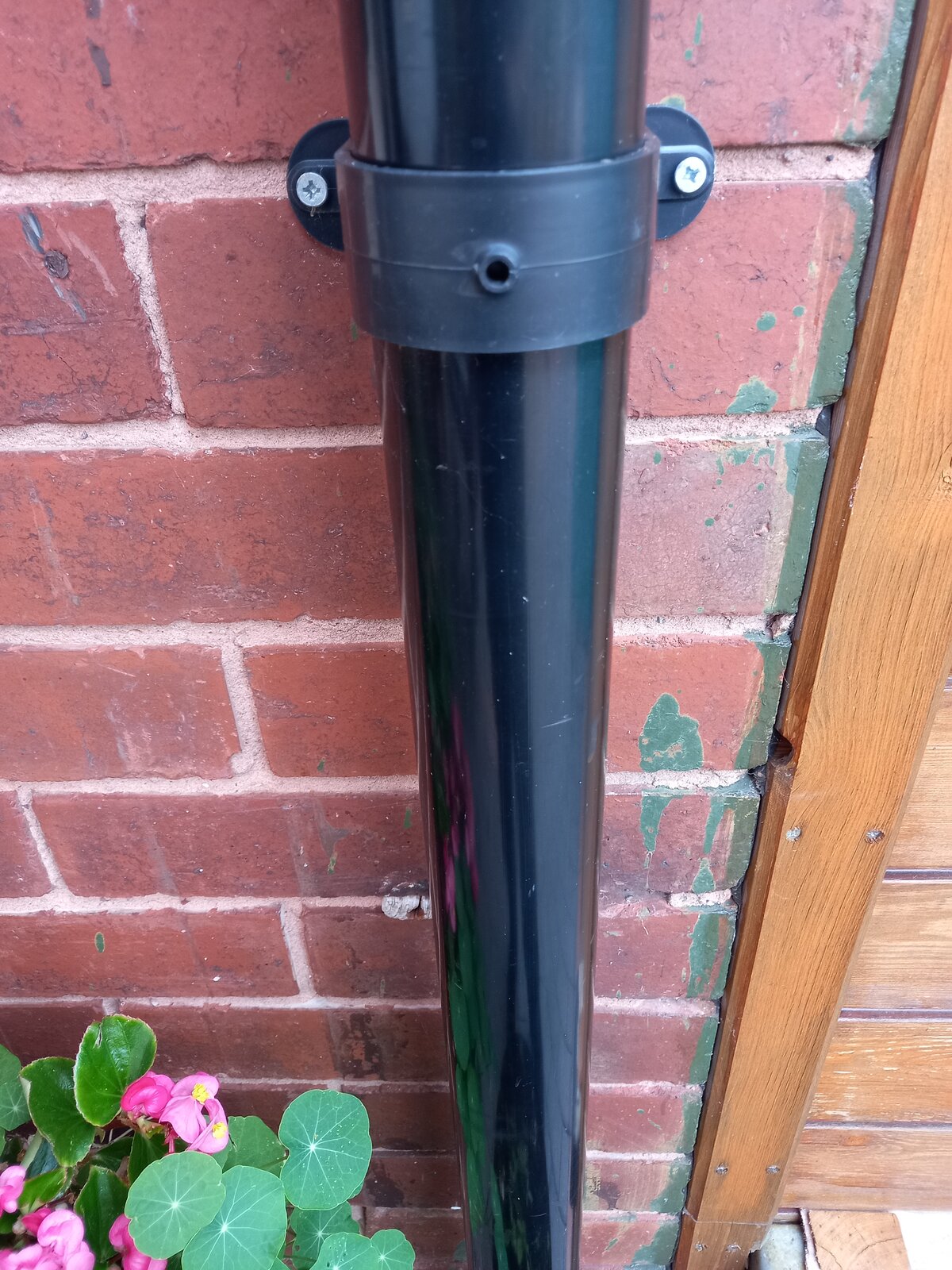

Just use small screws just one normal required.
Back in mist's of time key terrain made brackets that were made to take a screw to stop this problem.
I've still got a few see pic.
