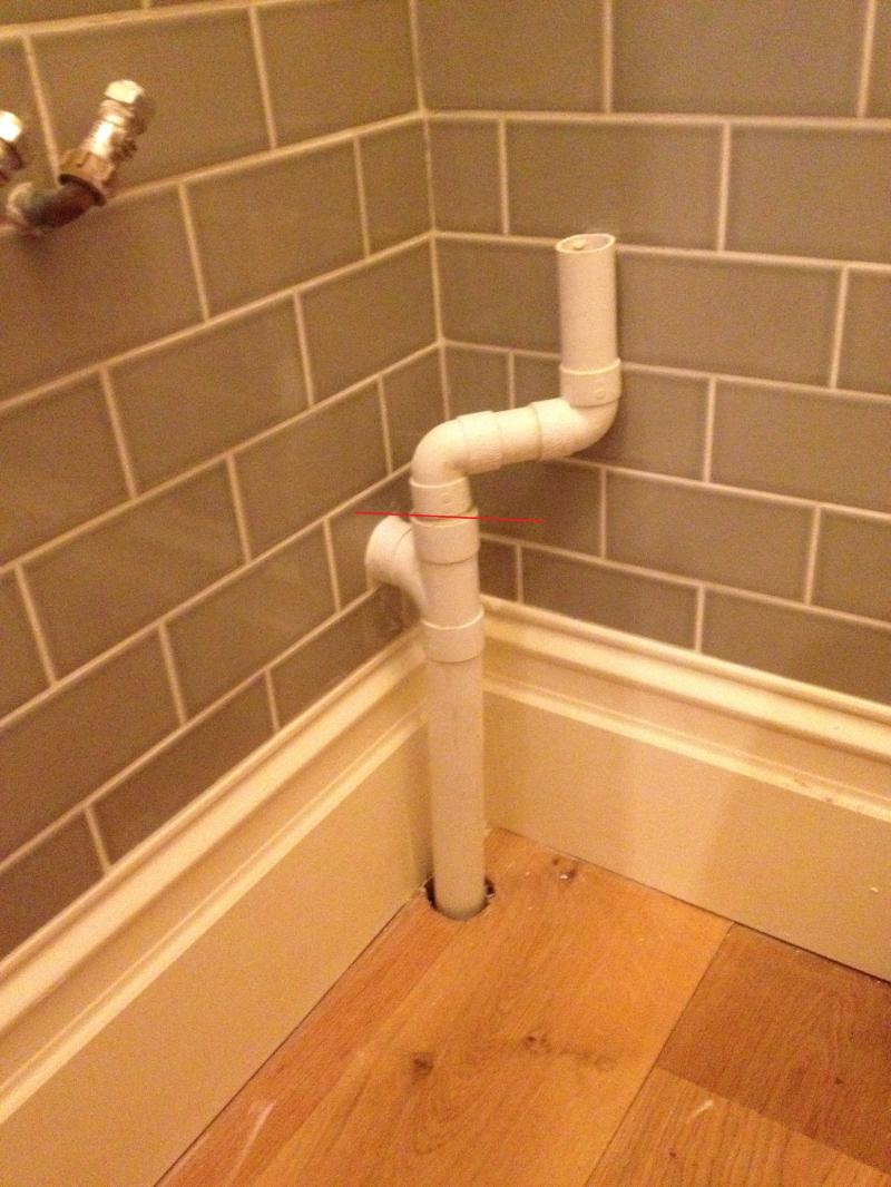

Does anyone know if it's possible to get a solvent weld coupling or adapter that fits INSIDE 32mm ABS pipe?
Basically this,
except that's American and PVC.
If I am to simplify my waste pipe run so it doesn't look like a dog's dinner, I would need to cut off the existing solvent welded pipework at a point where there would no longer be anything left to attach a new fitting to, unless something like the above existed... but I can't find such a thing :(

I'll have nothing for a normal joiner to attach to, though... will post some pics later if I get a chance.

OK, here's a pic. I wanted to cut the top section of waste pipe away where the red line is.
I could then have rerouted the pipe to make it easier to box in, or at least change it for chrome so it looks a bit smarter and box the lower portion in.
One thing I did think of, was whether you could get fittings that go over the top of fitting collars; I doubt that even more than finding an internal coupler, to be honest.
Is it not possible to gain access on the other side of the wall so that you can replace as required from the floor up?
The other side is behind kitchen units, so not readily accessible without pulling the backs out of those. More hassle than it's worth really, just for me being picky about piping ;)
Juat wondering I don't have any to hand a present to try but if you are boxing in suppose you cut the elbow above the tee leaving the outer part of the socket might a 40mm compression elbow fit on to it? Then drop back to 32mm again to connect to the basin.
If you cut the socket of the bend vertically without damaging the pipe its stuck too, you can peel the socket off and weld a new one on :rolleyes:
