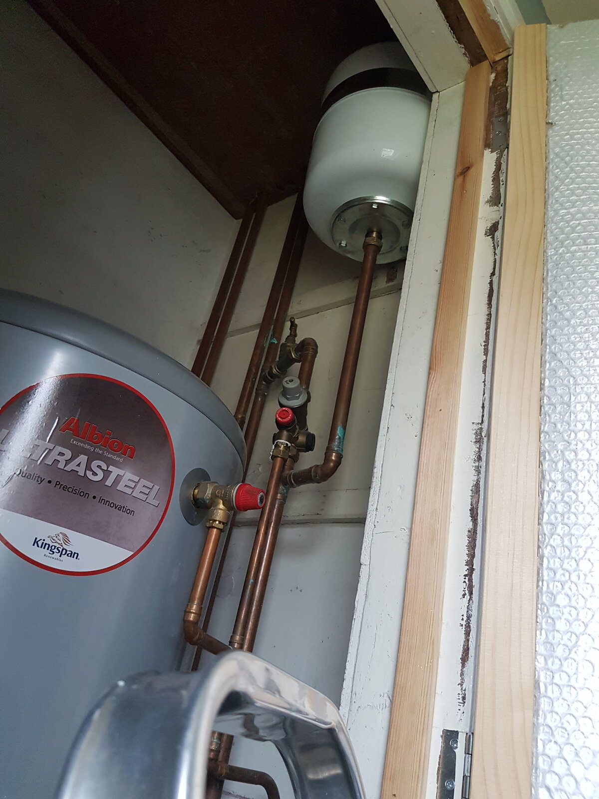

Just an update on my problem. Oilhead mentioned "failed expansion vessel" and, after genning up on the subject, I discovered that there was no air pressure in the EV and by tapping it, it was obvious it was full of water. It was a simple job to drain and take off the EV, pump out the water and repressurise to 3bar. Glad I didn't have to get anyone in the house as our wee village now has several Covid cases after someone came from Glasgow to visit a friend here. Thanks again to all (especially oilhead) for their responses on the forum.
There was no need to drain or take it off, you just needed to add air to the correct pressure, which would then force some excess water out via the PRV.

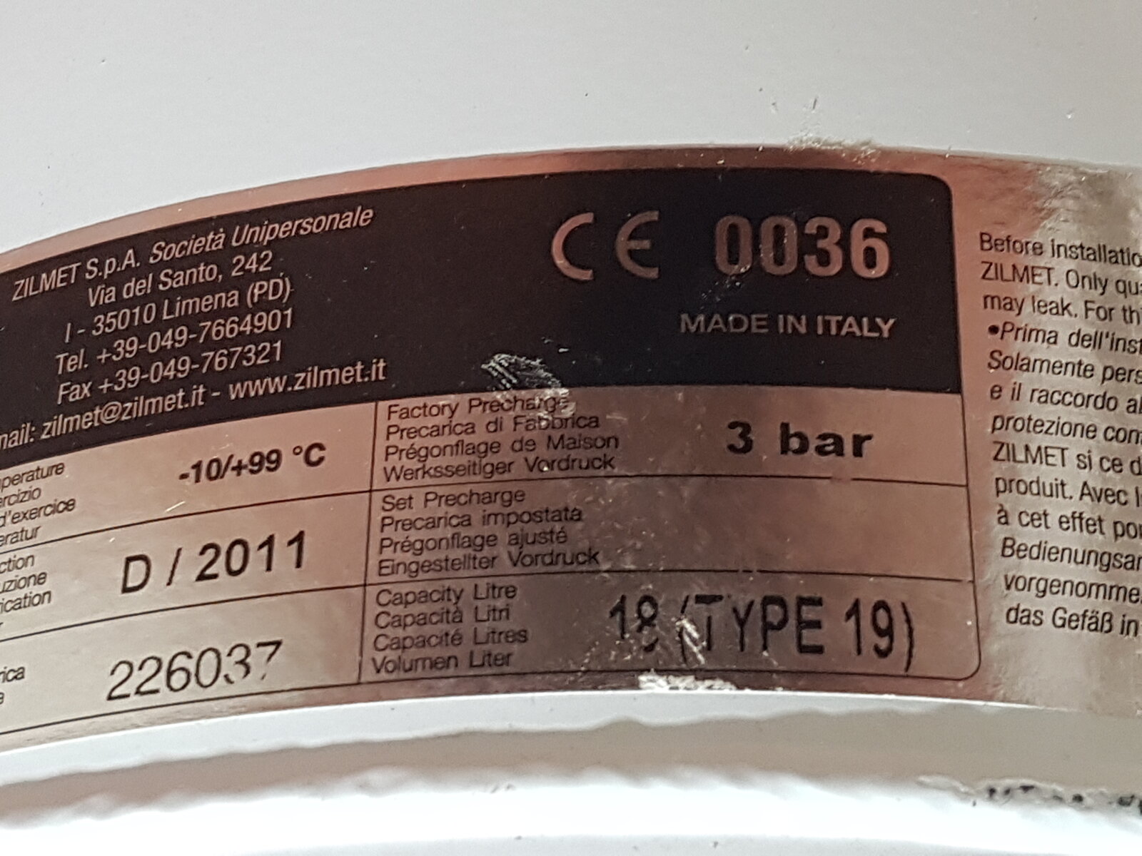

For Harry Bloomfield. Believe it or not, I couldn't manage to stand on the steps and operate a large car tyre footpump by hand. And anyway with only about 45mm clearance from the ceiling there was no room to get the valve connector onto the valve. Another 5 mins to unscrew the pipe and unhook the PV from it's mounting. Another 10 mins to service and replace, job done.

For ianmcd
That is the potable water (Drinking water) expansion vessel for the unvented HW Cylinder, has absolutely nothing to do with your oil boiler, it uses a completely different expansion vessel usually charged at 0.8 Bar , most likely to be inside your boiler , if that vessel needed charging then so mote it be , but really you shouldnt be touching that you are not qualified to work on that , all Unvented HW Cylinder work needs a seperate qualification, it should be serviced every 12 months and the vessel checked as part of the service , this will not have made any difference whatsoever to your boiler problem

He's right, if it's the white one in your pics you adjusted, that is the EV for the unvented HW cylinder not the boiler, which you shouldn't really be adjusting ..... the EV for the boiler is different, usually red and can be found within the boiler case a lot of the time
Irrespective of the colour, following the pipework, which is clearly visible, would enable correct identification of the unit referred to.
I am happy to offer advice, but am disappointed when good clear advice and assistance is acted on indiscriminately. Mains pressure hot water cylinders are not something to be trifled with, and professionals have to be suitably qualified to work on them.
Well I am qualified to work on them , and that is the EV for the unvented HW cylinder and not the boiler
i think the op has created a bit of confusion with his description of "boiler over heating" it looks more like the t and p valve has been opening when the hot water is being heated and he thinks it was caused by over heating, repressurising the expansion vessel on the unvented has cured the fault.
