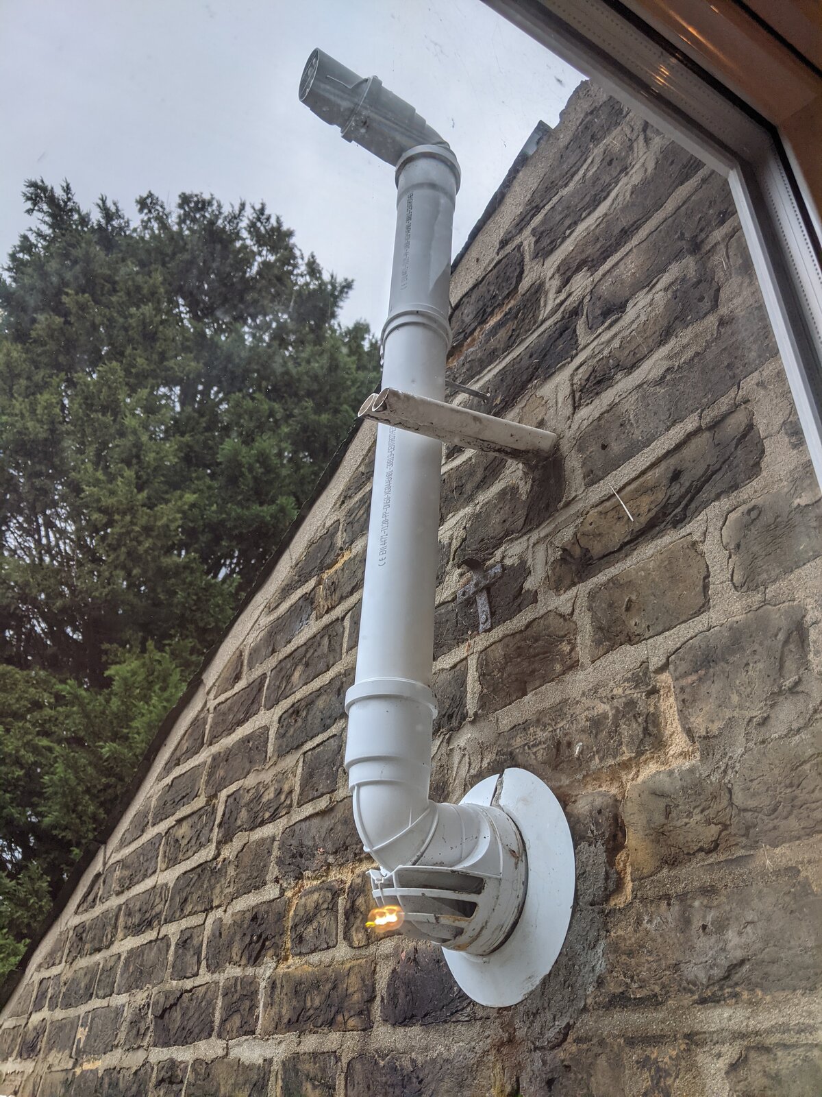

Hello all!
During lockdown in April we moved into a new house and on day 1 found a gas leak which required a new boiler system. Our options were limited due to full lockdown so we got in touch with the closest boiler installation guy we could find, willing to work during the lockdown.
Long story short, they did a decent enough job but there were a few leaky pipes (both copper leading into boiler and waste leading out of boiler). As a pretty competent DIYer I fixed these myself - I initially told the plumber about the leaks (he came and fixed one, I fixed subsequent leaks) and he said it's normal when switching from tank system to combi boiler - not sure how true this is.

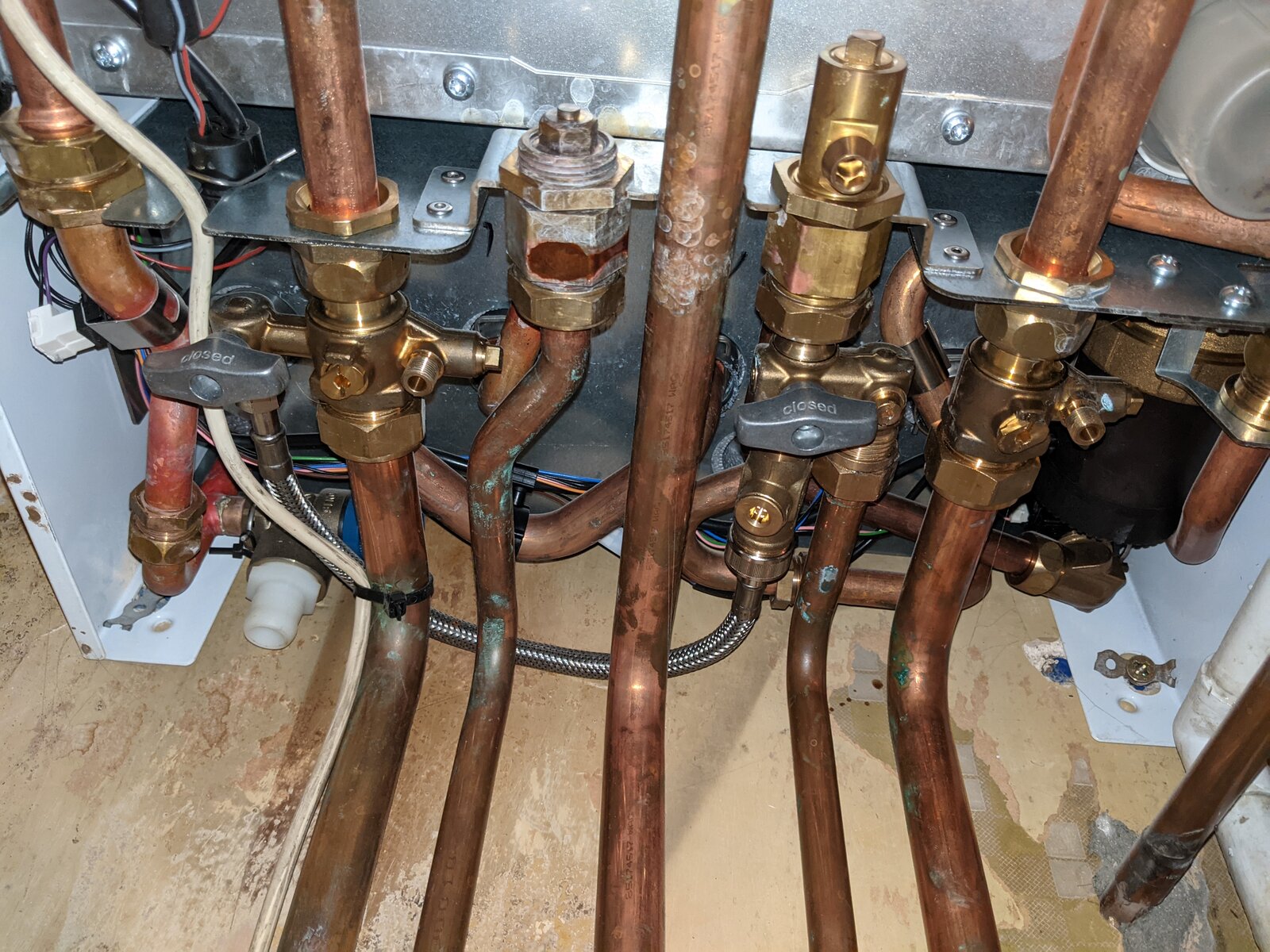

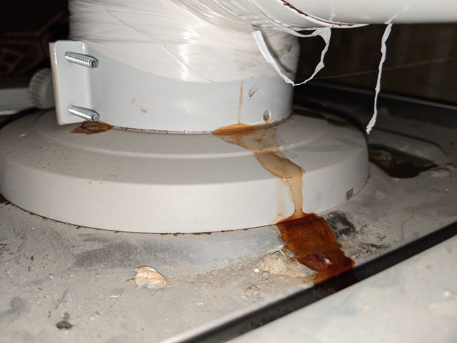

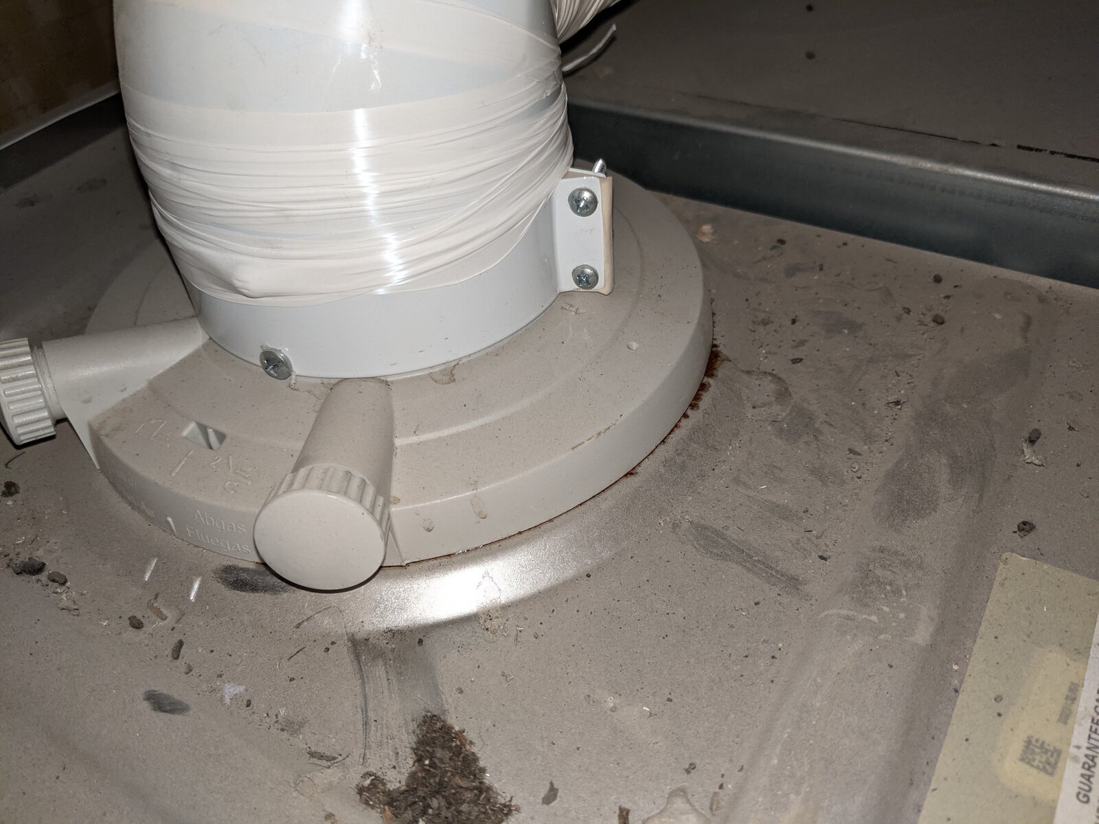

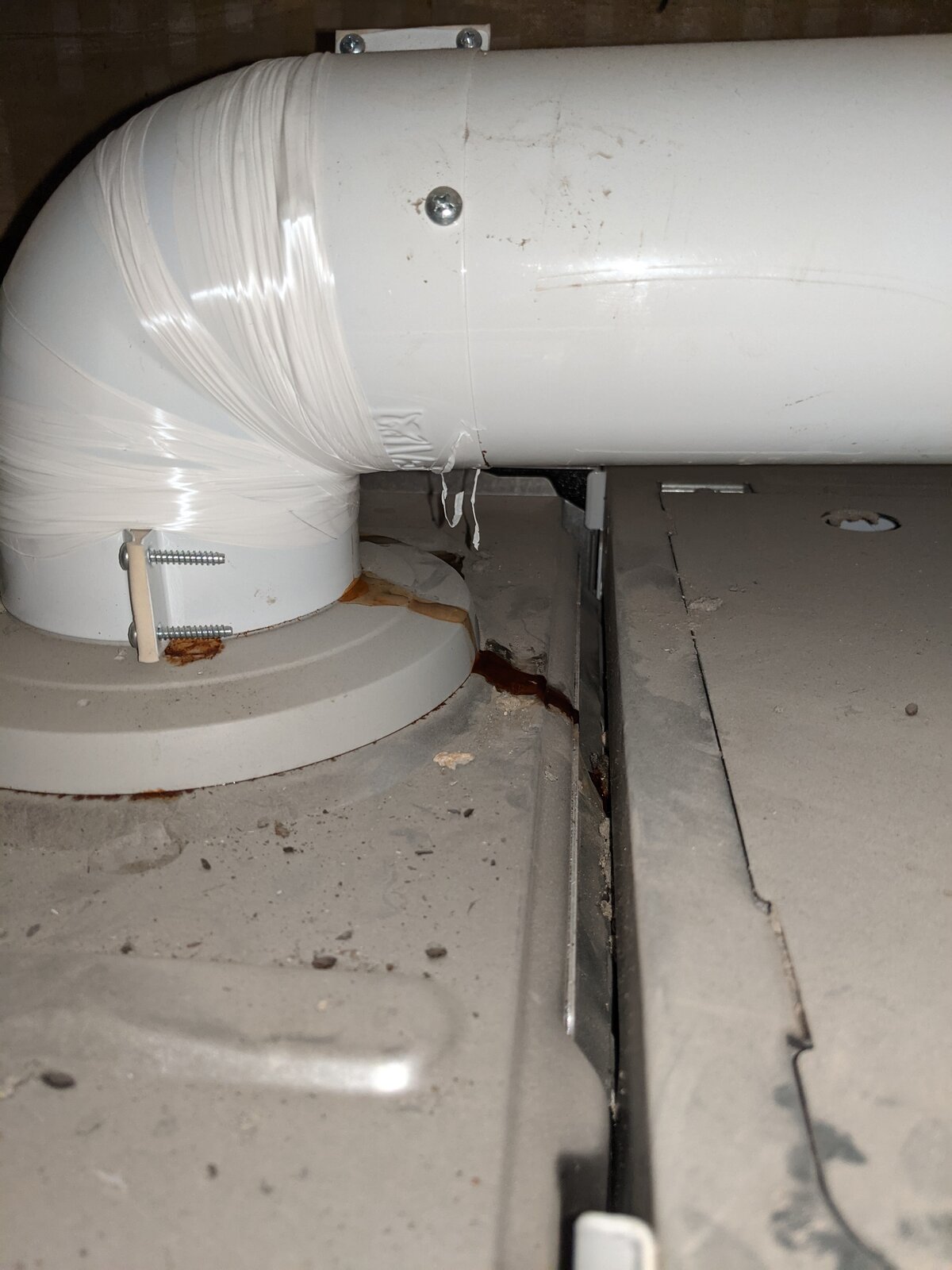

Anyway, flash forward to today and I discovered water dripping out the bottom of the actual boiler. Probably not a great sign, right? I've located the leak to the exhaust flue at the top of the boiler - pictures attached. I initially tried to prevent water leaking by wrapping the joints in plumbers tape but this hasn't worked.
I don't really want to have anyone in the house unnecessarily (COVID) and this plumber is obviously a bit of a cowboy, so I'd prefer to not have him fix it. In normal times I would be tempted to just pay a good plumber to come in, check everything over and fix any bodge jobs, but we're not in normal times. So is this something I can fix myself? If so, what do I do?
Any help, advice etc is very much appreciated!
Cheers
Auric

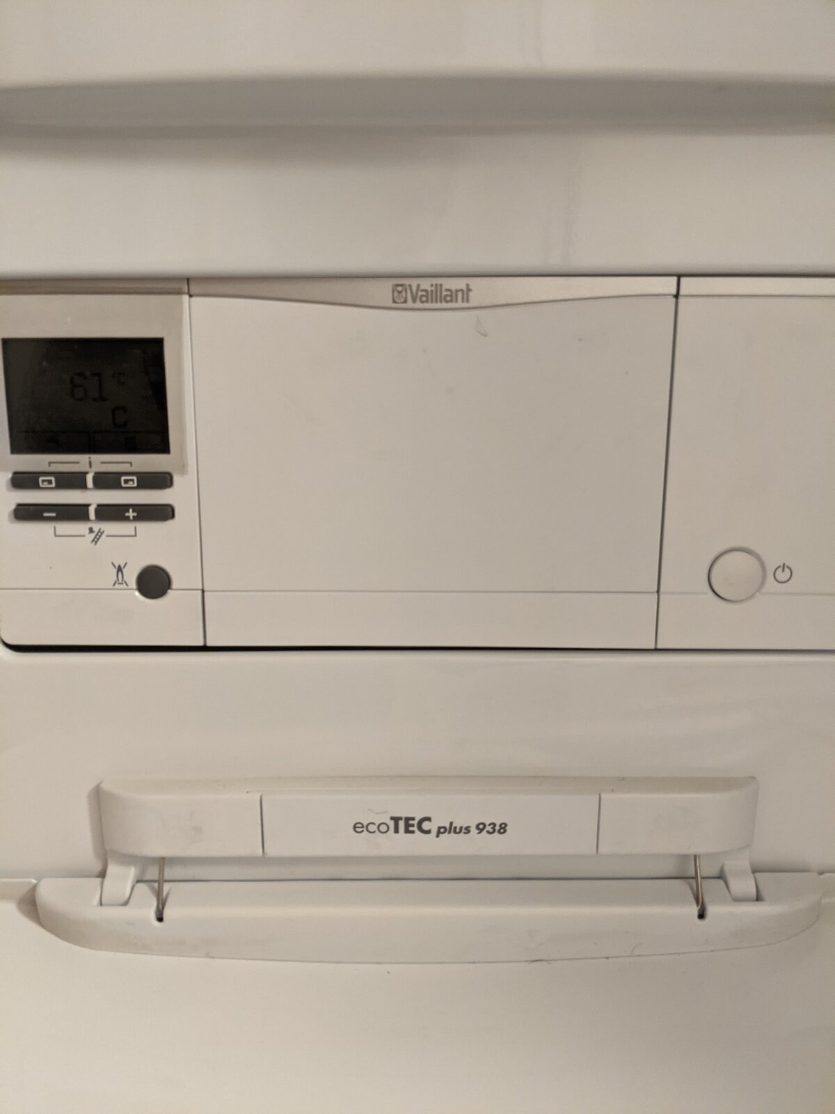

Edit: Boiler is Vaillant eco TEC plus 938

Call back a competent gas safe engineer you can’t DIY that. You are risking you are your families lives.
And ASAP as well, as it could get worse and rust more, resulting in another boiler.

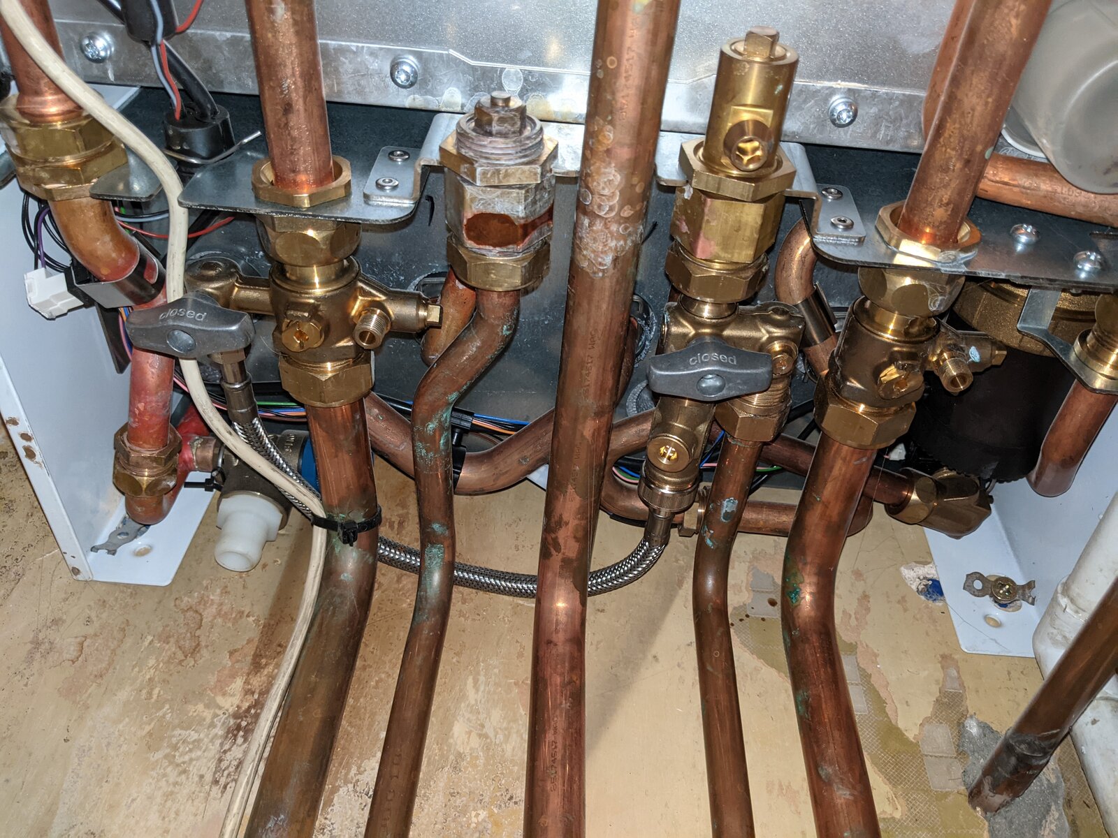

That installation's a total bodge...even the boilers storage cylinder safety valve has not been plumbed in.
I would be contacting Gas-Safe and requesting an inspection...they can force the installer to rectify all defects at no charge to you.
Have you got the building control notice and was the boiler registered?
A leaking flue can rapidly destroy the boiler from the inside out from corrosion, and a safety valve not plumbed in is not only unsafe but will also cause serious water damage.
I hope that cables heat resistant...poorly installed too.

If he doesn't cut and install the flue properly this can lead to leaks but you won't know if he does it properly unless you see him do it.

You also need to know whether condensate has leaked from the flue into the boiler combustion chamber and the extent of any corrosion.

Update: He is coming over to fix it today. He is saying that it is due to rain water in the flue, but I've pointed out that it hasn't rained today and now he thinks its condensation. He hasn't mentioned anything about the other issues raised by you all.
I can fathom why people think a cowboy will suddenly morph into a tradesman the second time around.
I understand but I don't have many options. I'm going to have to get him to check it first and then get Gas-Safe to inspect it afterwards. I wish I could have done it all right from the start but because of COVID we had zero choice.
condensation is within the inner tube that is made of plastic. It will not corrode.
Get him to carry out flue gas analysis on the two test points on the turret. One should show 20.8% O2, other readings as per the spec in the boiler book.
It appears flue gases are crossing over to inlet side or inner tube seals are displaced, missing or tube not engaged in the socket.
Builders band securing the bottom of the boiler is certainly not Vaillant approved :rolleyes:
