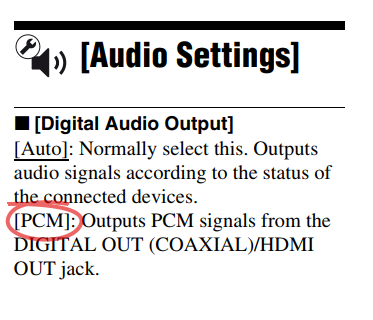

Any reason for no sound is most likely a settings issue, either on the player or on the TV, but it could be both. We'll start with the player.
The main item here is in the sound menu. Your menus may not be exactly the same, but in general you're going into the player Settings menu, then stepping through to the Digital Audio Output menu. The correct option here is PCM. This will ensure that whatever disc is being played, the sound is in a format that's the most widely compatible.
To be honest, just by making this one change, it should cure any compatibility issues because of signal format. The rest of the settings that could get in the way would be on the TV itself.
