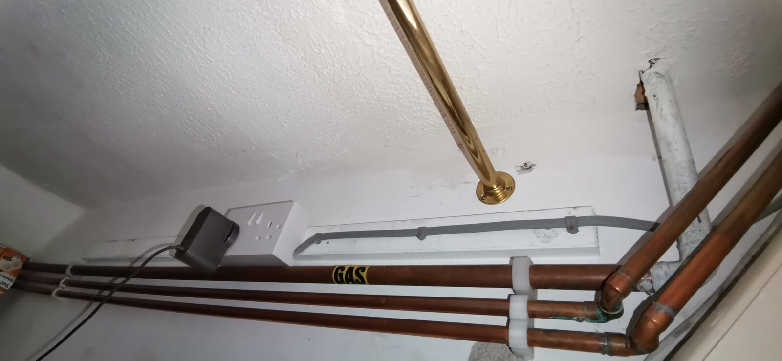

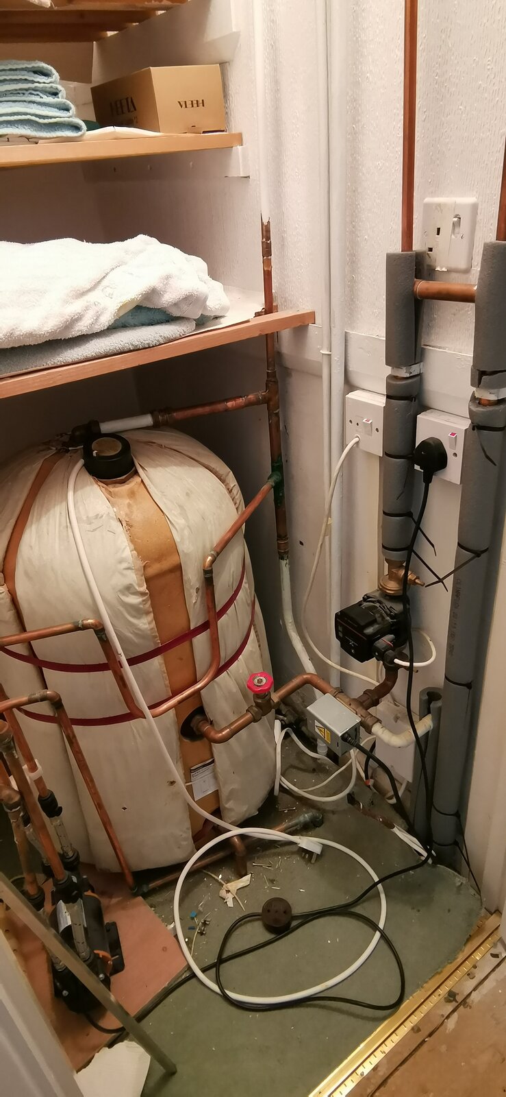

Hi yes both flow and pressure tests on the outside garden tap were done, He did look at the gas pipes from the meter but they go into a void under the stairs. I've have a few plumbers look at the system while the BG 330+ runs nice and quiet in the winter I'm sure while getting up to tempreture the boiler shuts off cools down abit then refires.

so do your existing rads get v hot within about half hour or do they take hours to get hot to the touch
The rads take about an hour to get hot, they never get very hot if the boiler is set to 70 it can take 3 hours to reach this temp.
All the radiators are new, system cleaner added and flushed, the F&E tank cleaned out.
sounds very like you system design fault that needs investigating . Could be tee`s in wrong place amongst other faults
If going for a Vaillant boiler is my Nest still the best option for controls, I want to be able to turn the heating on from my mobile phone.
It's worth sorting out the problem with your existing set-up before spending money on changing. I agree with gas112 that there could be a pipework fault, causing most of the flow to go straight back to the boiler return, only what's left to the rads. Going on/off on the control-stat is a possible symptom.

I moved into this house 3 years ago prior to that it was empty for a year some of the pipework in the airing cuboard was replace due to being partially blocked, The sytem has had a system flush ( not power ) and all the radiators replaced boiler also serviced.

Unless there's something unusual, 20kW is almost certainly enough if it's working properly. As you probably know, 35kW for a combi is to give acceptable HW flow. But if it is a piping problem it will be the same with a new boiler, combi or regular.
When I moved into my first house, new build, in 1973 there was a problem, long story but there were 2 parallel pipes and hot from the boiler had been tee'd into the wrong one. Symptoms like yours. Builders still on site, I convinced them what the problem was and they fixed it.
Trouble is if you've got something similar it won't be easy to find what's wrong, need to trace the pipe runs.
What you could do is close all the rad iso valves and any bypass valve. If it's piped correctly that would dead-head the pump and boiler, so if you switch heating on you'd hear some nasty noises, get ready to switch off quick if that happens! If it's piped wrongly as I suspect, the boiler won't mind, it will still get flow and go out on the control-stat. That would at least tell you what the problem is, but not where.
