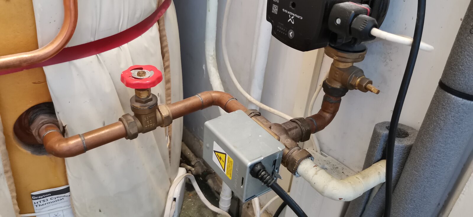

Moved into this house 3 years ago and its always taken about 3 hrs to get the house upto temperature, I found that the pump was connected to the return
pipe so had that changed with a new pump and fitted to the flow side of the system but that has not improve things, not sure if 12 years with the pump on the return has done any damage to the boiler ? The boiler has been serviced.

Shut all the rads fired up the boiler it ran for maybe a minute then F22 dry error.
OK, that seems to rule out my theory! Back to square one.
Have you got a bypass valve, if so it should have been closed for the test. Maybe in normal operation it's passing too much.
If that's not it, I still think the problem will remain if you replace the boiler
Only valves I have are these. Think I'll have to wait until winter and see how the system performs.

I suppose you've tried increasing the pump speed and perhaps its mode of operation? Are your rads adequately sized for the boiler output? If they're too small it would give your symptoms.

You will have to update us, did you get a new boiler? did you open the by-pass ? has anything changed ?
Nothing has changed used the central heating for the first time yesterday, dont think my system has a by-pass valve.
