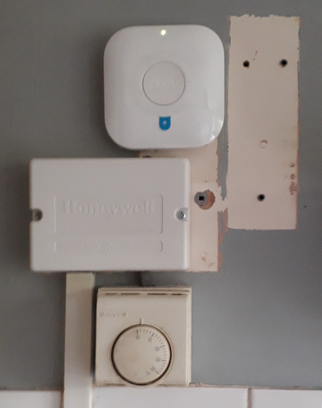

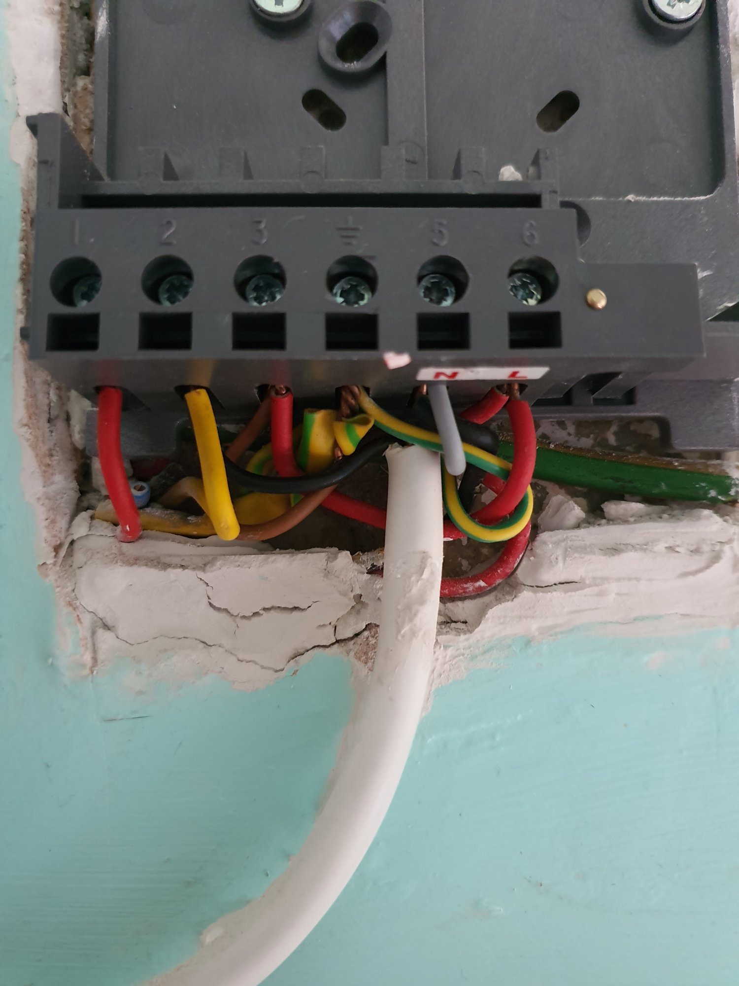

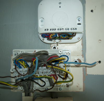

Sorry it's another nest heatlink problem.
2 Sep 2019
4
****Update****

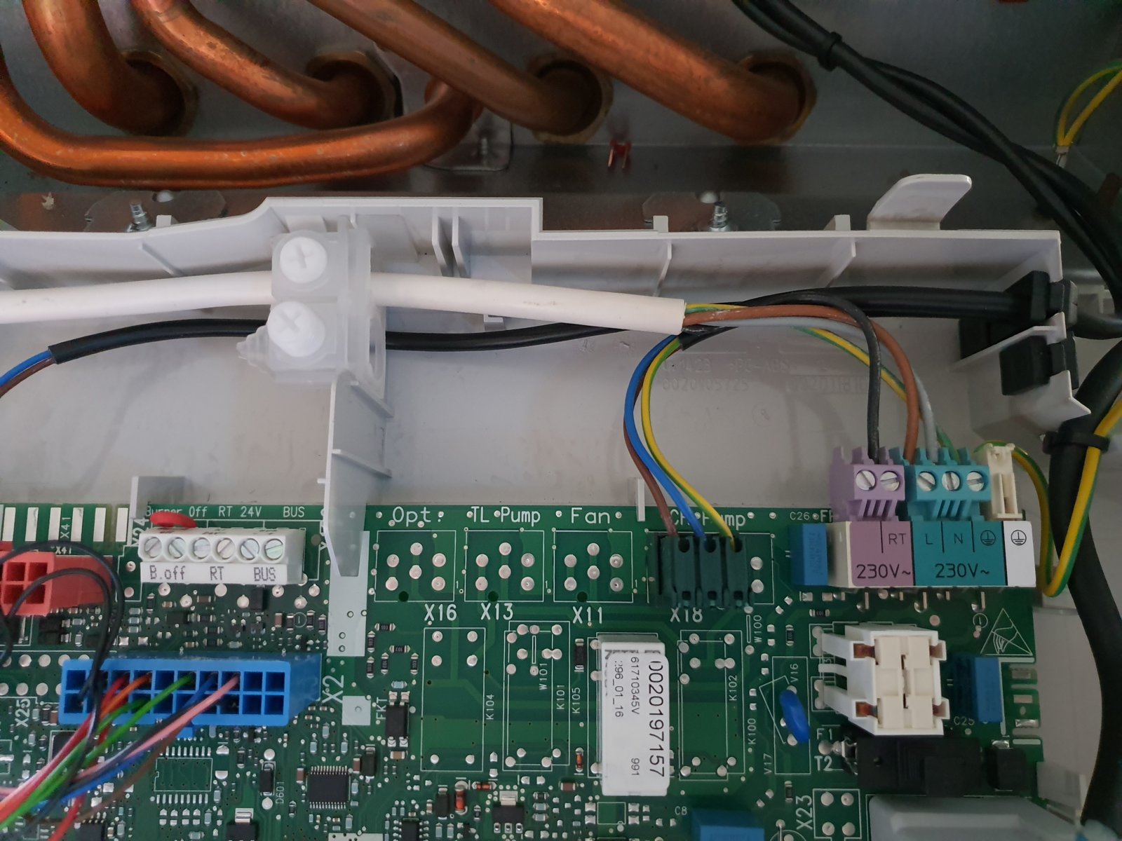

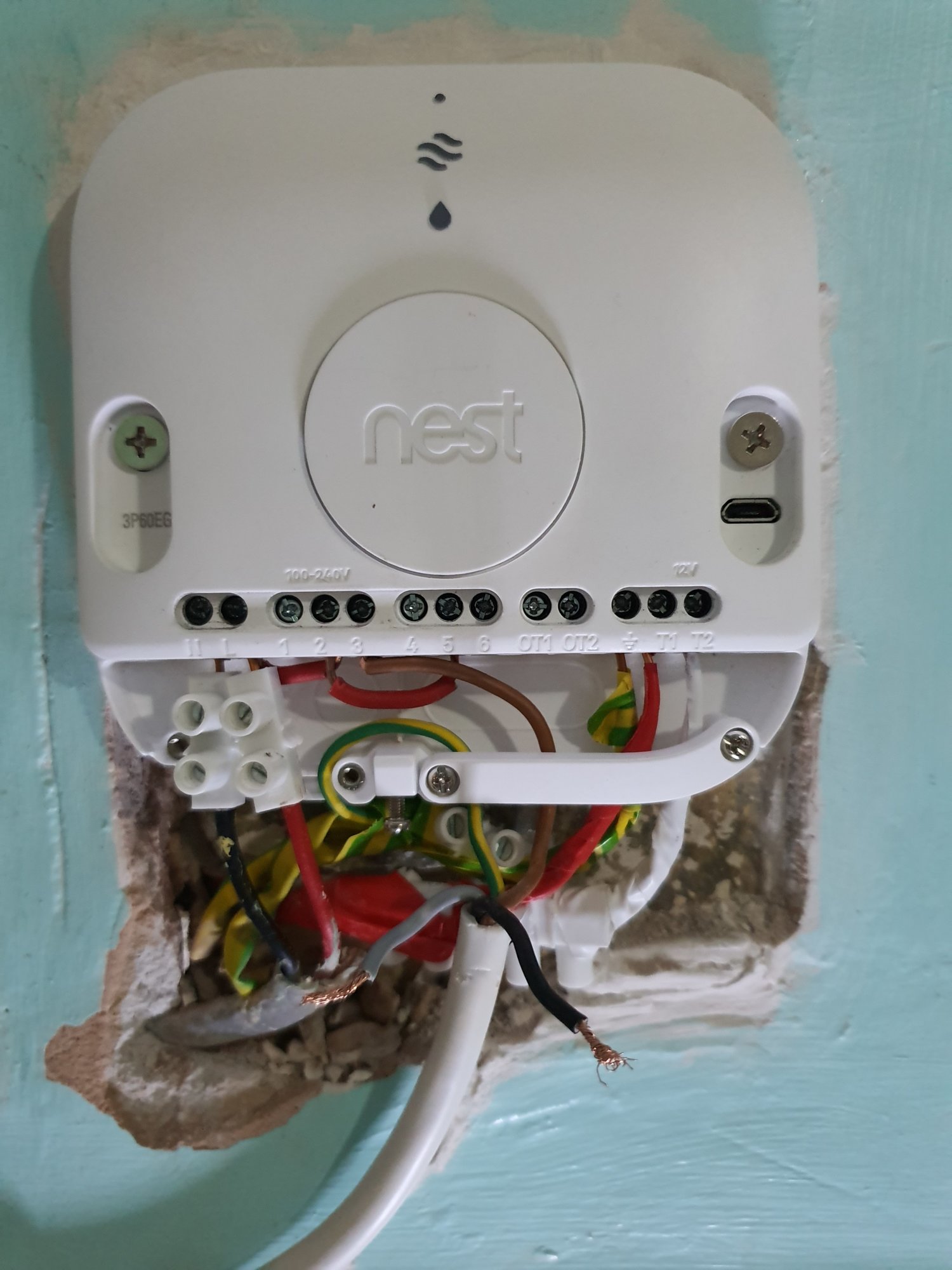

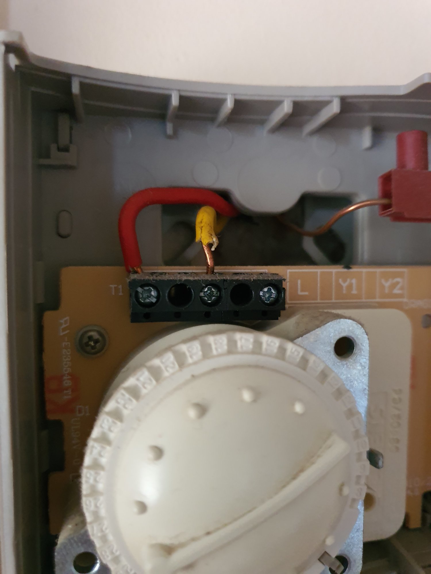

I have managed to wire it back up, no trips etc, as can be seen by the 2 new pics above. But still no heating, asked a local heating engineer after showing him the pics as no one replied on here & he said "I think that black (now identified as RT) goes to the T2 port coz that the way it looks in the pics"..... ‍♀️) clearly doesn't otherwise I'd have heat.
Turned off & isolated, opened the electrics box in the boiler, no RT link for me to remove, so stumped ‍♀️ but black is RT & Grey is Neutral. (Added pic of inside boiler unit)

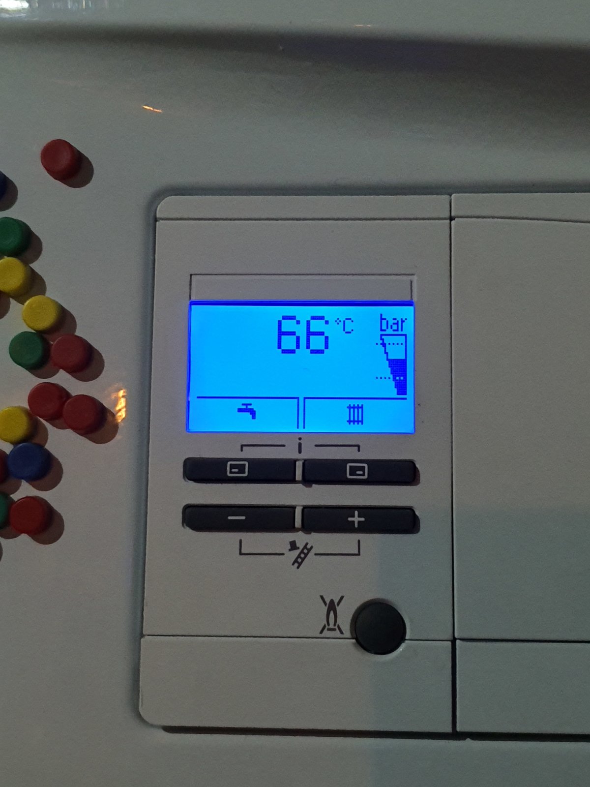

Only way I can warm the house is to hold in what I call the "Tophat & Ladder" buttons to run what seems a heating flush/purge & gets the boiler to run to 70°c
Boiler shows S.30, install manual says "outside thermostat blocking heat"

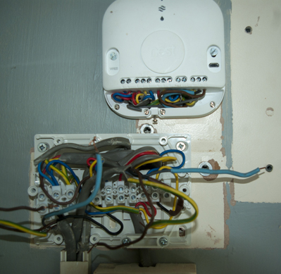

I have followed the wiring instructions & only got hotwater, thermostat kept saying it would be 45mins till the radiators would be hot, but boiler never fired at all, run hot tap & it fired instantly. App showed everything was ok after running the checks.
So unwired & tried again. Then after trying another way from the other threads I get nothing but a blown 3amp fuse.
Last pic shows the way I had it going off all the other thread suggestions on here & without the black & grey wires in any connection.
So I have removed everything, only thing that's back ok n the wall is the old thermostat.
Issue is the wires in the 4core flex from the boiler. I have identified the mains L, N & E wire, red & yellow thermostat ones, L & E ones in the 4core & where they go, but dont understand where to put the Black & Grey ones from the 4 core as the grey was in N wire & the black looked like it went to the earth originally & I dont want to open the boiler if possible(read the screaming replies "dont do it " lol), but they dont work when wired there the first time.
So I'm thinking they go to 4 & 6?
Just haven't tried that yet as it was late & very dark when I was fiddling, so I just unwired & isolated the mains by blocking & removing the fuse. (I'm based in the UK, assume its S plan as theres no gravity system anymore & dont have aircons)
If it's the plan were I have to remove an internal link, then I will look into it more, before opening the boiler. But I've seen the boiler cover off for a service & know the wiring system is at the bottom in a flip out box.

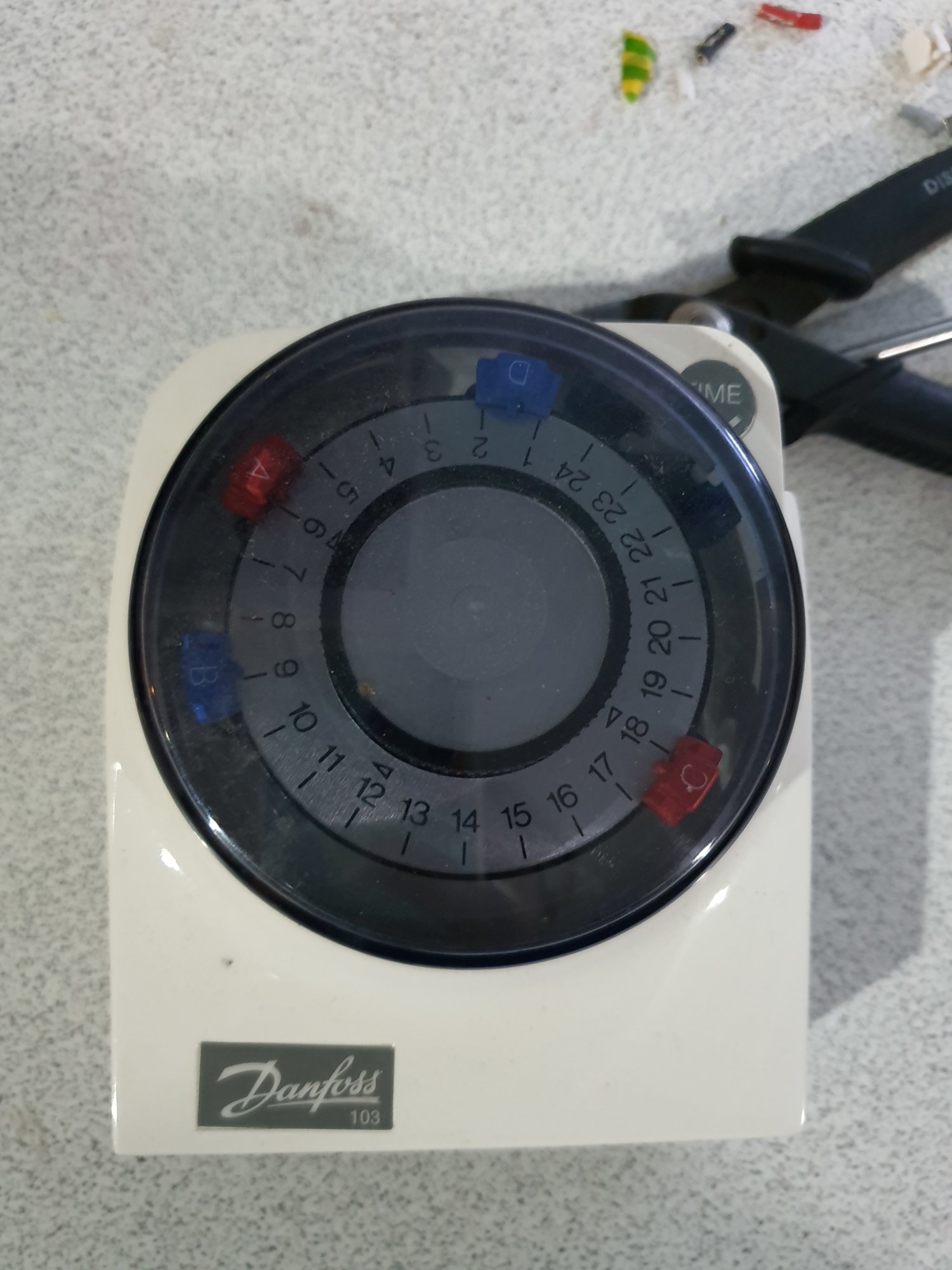

And yes the wires are really short in some places & I've had to extend with blocks as theres no other junction box, that's another thing I'm looking into once I know it works as then I will be able to label correctly. But that's what happens when the boiler company installers cut out the original Randall rather then unscrew it.

That's a real mess, and probably why no one has replied. It would appear that a new boiler has been fitted to an old installation and the existing wiring and controls mashed up to it. I suspect that you have a combi boiler, but as the EcoTec Pro28 comes in several versions, so I can't say for certain. If it is a combi and you don't have stored hot water now (ie a hot water cylinder) then the existing wiring, timeswitch and thermostat should be taken out and the Nest Heat link wired directly to the boiler as if it were a new installation. With some boilers, it is necessary to open up a room sealed compartment to access the boiler wiring terminals, and if this is the case with yours, it is a job for a registered gas installer as they will need to perform checks to make sure it is properly sealed up again afterwards.
On the other hand, if you still have a stored hot water system, the design of the existing plumbing which you don't tell us anything about, might be too old to work with the functions provided by the Nest.

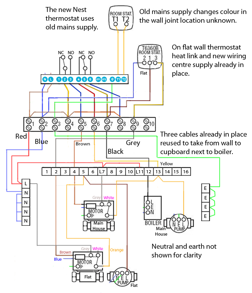

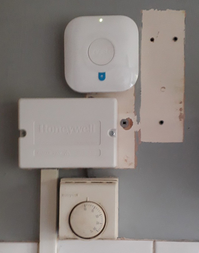

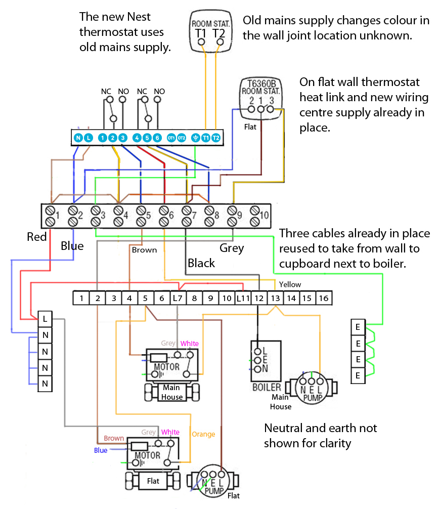

I found the Nest terminals are only just big enough for one wire, so I put a wiring centre under it New_wiring_centre_etc.jpg that means I have the ability to have one line feeding three terminals in the heat link without need for two wires in any terminal, I will not claim it is neat, upper_wiring_centre_plus_heatlink.jpg but at least I can trace each wire. I also took the time to plan out what would go where, C_Plan_My_HouseS.jpg yes it took some time to plan it out, but once done wiring was easy. There are too many wires for most people to work it out in their head without writing it down. I also had problems but it was the software set up, not the hard wiring. Nest can be configured to work with nearly any boiler, but you have to sit there and plan it out first.

It is a mess Stem, I took all the plates off and was like "WTF?" I couldnt get over how many wires were squeezed into each terminal. And it seems that the boilers power supply is run from the programmer and not the other way round. Damn council for you lol, all the wires are too short etc, you can see where it looks like the just cut the old programmer out, they've just put a blank plate over the top of the old power socket near the ceiling after fitting the new boiler, I asked if I could remove that & plaster the wall & the reply was "I wouldn't as it might still be live" that was a Vaillant engineer too.
So it looks like I will have to get a junction box & have it fitted that way. As it's just caused a headache so far & none of the wires seem to stay in the nest terminal no matter how tight.

I found the Nest terminals are only just big enough for one wire, so I put a wiring centre under it View attachment 171042 that means I have the ability to have one line feeding three terminals in the heat link without need for two wires in any terminal, I will not claim it is neat, View attachment 171043 but at least I can trace each wire. I also took the time to plan out what would go where, View attachment 171044 yes it took some time to plan it out, but once done wiring was easy. There are too many wires for most people to work it out in their head without writing it down. I also had problems but it was the software set up, not the hard wiring. Nest can be configured to work with nearly any boiler, but you have to sit there and plan it out first.
Ericmark, this is what I'm going to have to do, it's on my shopping list for today, then I'll be hunting for a decent priced sparky to sort it, unless nest pros are reasonable?
As it's a combi, and assuming that it already has a suitably installed mains electrical supply, if you were to use a 'plug in' 12v power supply for the thermostat, then just one short single cable from the boiler to the Nest Heat link is all that is needed, so won't take very long for a suitably skilled person to install.

If it were my house, I would chisel out wall at the side of the switch by the heat link and fit a double socket box with a length of terminal strip, so all wires can be terminated into that terminal strip. Either on the blanking plate or above the new socket box fit the Nest I think likely above it. Then only one wire in each terminal in the Nest heat link.

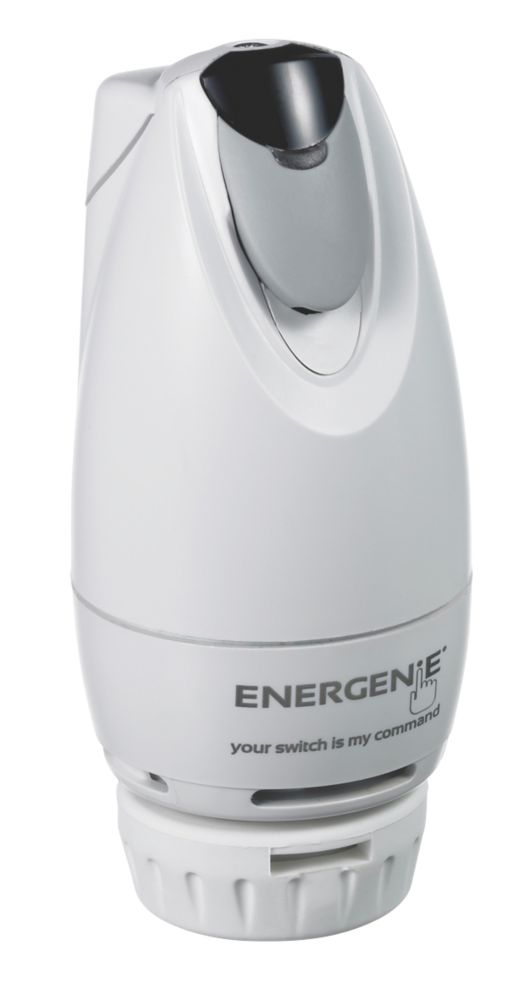

However that does not cure the problem of rooms too hot, I bought TRV head's from here
to ensure rooms do not get too hot,
ae235
shown second is the Energenie TRV head which pairs with Nest I have used the Energenie heads for three years, and I can say they do work well, the cheaper one not done a winter with, so can't say how well they work. But clearly huge difference between £15 each and £40 each.
I found the Energenie highlighted a problem which could have been likely cured without them if I had realised what the problem was, in the old house many of the TRV heads are on the return, the valve will work either way, but being on the return radiator gets hot before the return gets hot so by time the valve is closing the radiator is really hot, result is it over shoots. Once I had the Energenie head fitted which has two sensors one air and one water the latter compensates for air being warmer when radiator is on, then I could see both target and current temperature in °C not silly *123456 so I could see the room was over shooting, so I simply closed the lock shield valve bit by bit over a few weeks until the target and current temperatures matched most of the time.
Once done then the rooms followed the programmed temperatures well, within 0.5°C most of the time. So had I then replaced the Energenie with standard head it would have likely also worked. The cheaper electronic head you only see target temperature it does not show current, so you would need a separate thermostat so not as easy as with more expensive version.
However the cheap version can be set on the actual unit and it does not require a hub, and has other features like open window shut off, so I use one in kitchen so when we unload food from car the radiator turns off while back door wide open.
If you don't want the Bluetooth the same TRV head is sold for £10 each, (Screwfix £20) I prefer not to bend down to read and set so got Bluetooth version.
