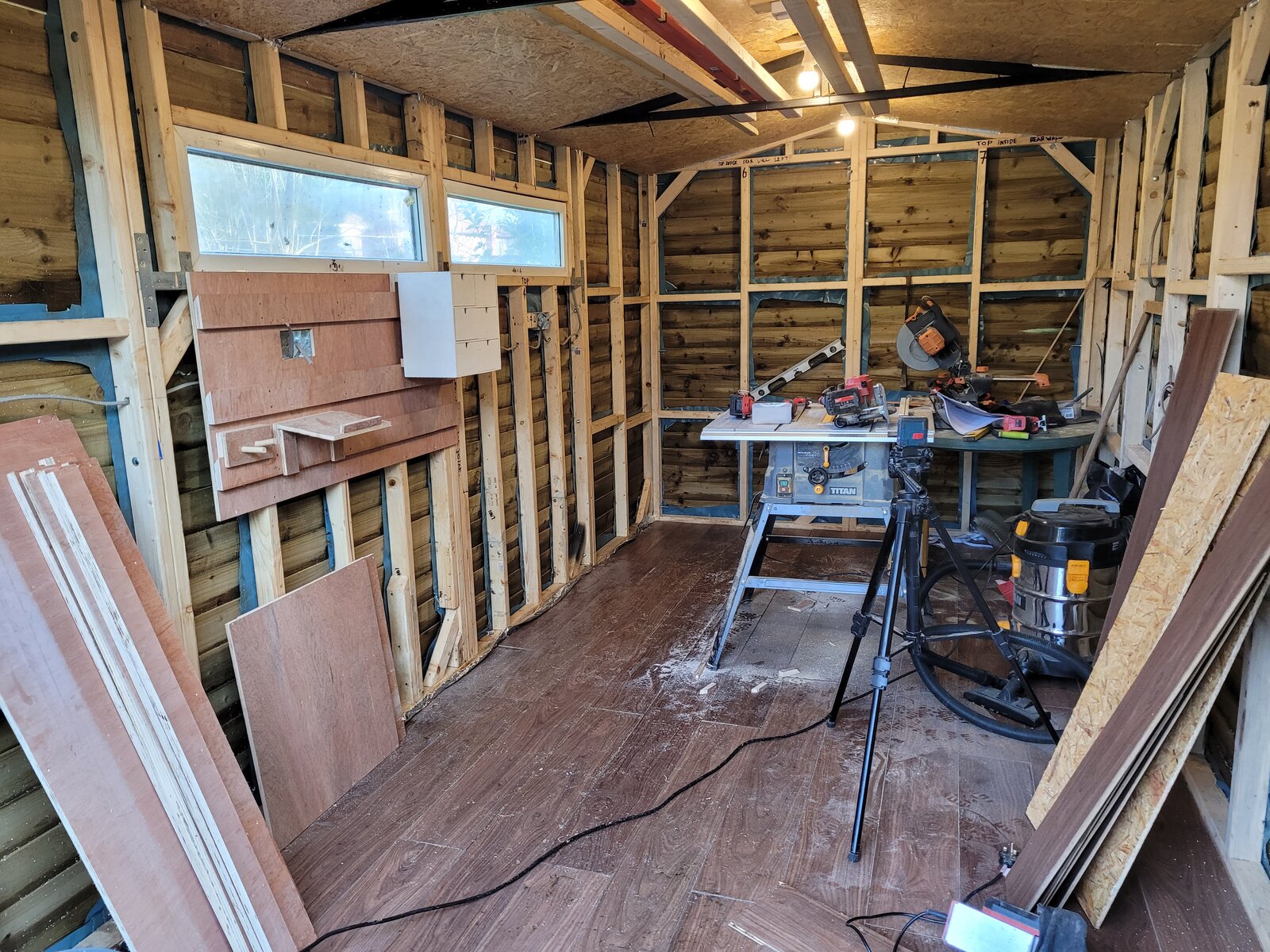

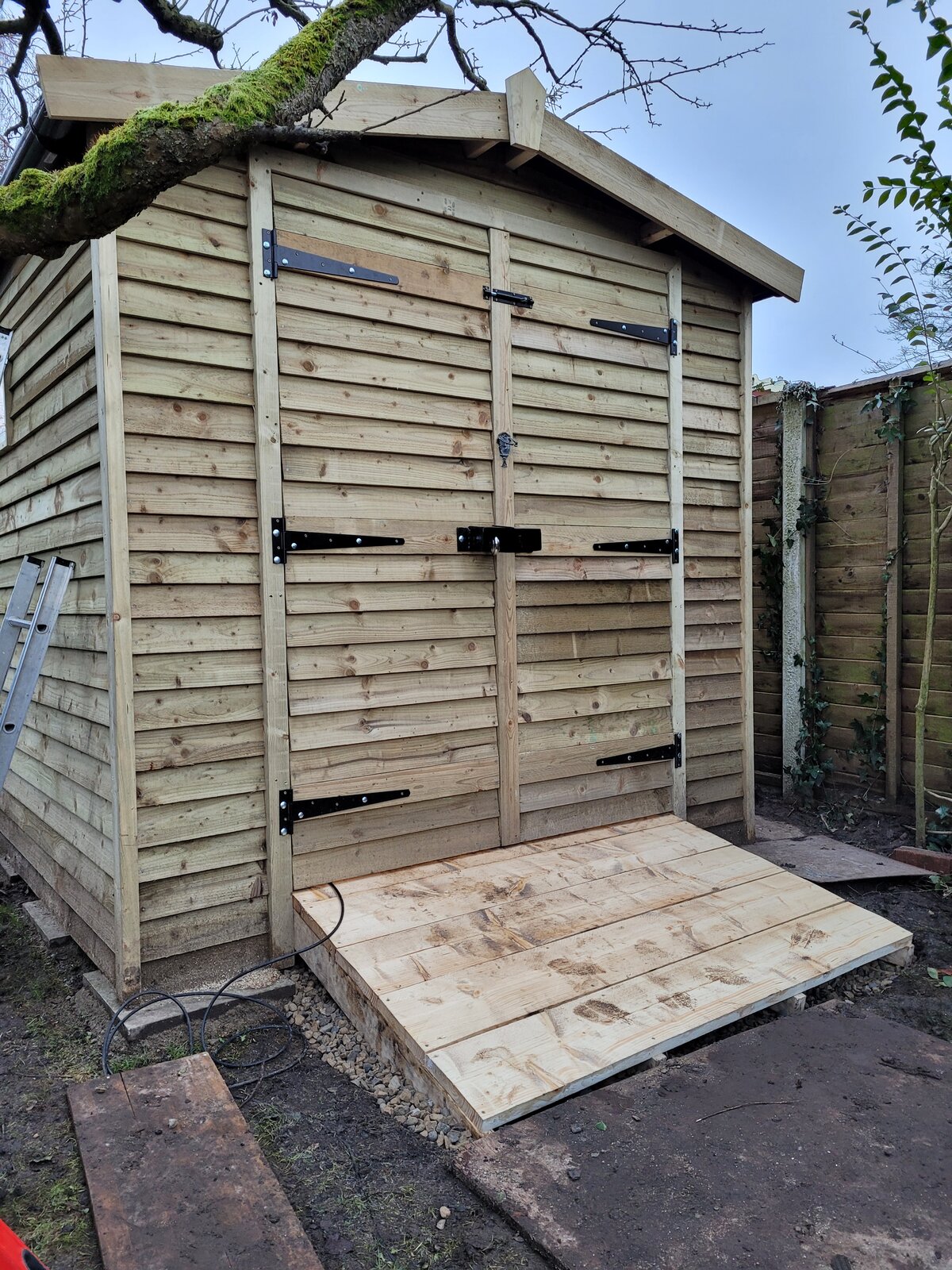

Hi guys,
Hoping for some advice on how I can retro-soundproof my wood workshop. I say soundproof, but what I really mean is limit the sound to a level where my neighbours don't complain!
As you can see on the images below, it's a very simple timber-frame shed. It was built to a cost and I never had any intention of soundproofing/insulating.
The floor is laminate on underlayment on 25mm ply. The roof is bitumen sheets followed by 50mm of polystyrene insulation (this was just to stop condensation) with an 11mm chipboard ceiling. The walls are bog standard stud walls clad with feather edge. I didn't bother adding a vapour barrier but there is a damp proof membrane sandwiched between the studs and cladding to stop the studs rotting. I've also lined the inside of walls with 6mm ply which isn't on the photos. I believe that it's the walls and doors that are to blame for most of the sound loss.
So, my question to y'all, is how can I seriously limit the noise of my table saw/mitre saw etc. without spending a fortune? Obviously if I'd realised noise was going to be an issue I'd have approached the build differently, probably adding a skin of chipboard to the walls a vapour barrier and some PIR/rockwool which I imagine would absorb sound quite well. Too late to do it properly so I'm trying to work out the next best thing.
Very limited knowledge on this stuff but I guess that taking the ply lining down and simply stuffing the cavity with 50mm rockwool is out of the question as it'd be sat up against the exterior cladding. The studs are 63mm deep so that's the room I've got to play with, short of adding battens to the inside to increase the cavity (which is rather not do to conserve space).
Thanks very much,
Jack
featheredge is not weathertight so rain will blow in through the gaps and damp will lurk in the cavities.
breathable membrane on the frame followed by battens to give a space from the cladding would have made the building more durable and allowed you to include insulation in the walls. If you add it now from the inside, the studwork will still be outside the weather barrier. If you pull off the cladding, you will doubtless crack or break some of it.
noise muffling is mostly down to the weight of the barrier, and the absence of gaps.
dense mineral wool will muffle it better than loft insulation, and a continuous layer of chipboard, or plasterboard which is fire resistant, as a lining.
You might also add some kind of partial enclosure around your noisy machines.

either remove the outside, or remove the inside.
If I were to remove the ply lining inside I couldn't just butt up the mineral wool against the inside of the feather edge though could I? How would you suggest I get round that?
Cheers
If you remove the feather edge you can fill the studs with accoustic rockwool slabs and then ply over the studs you would then need to add batons over the studs to re attach you feather edge cladding!
Best way.
Though I would add membrane or felt to protect the ply.

Line the inside.
I wonder if it's worth looking at the saw itself, could you get a quieter one? Maybe a smaller motor or cordless for the less social hours?
Although I do find with people working from home they're annoyed about daytime noise interrupting their work, then evening noise interrupting their leisure time, you can't win.
Fortunately for me I live somewhere where I can make as much noise as I want :whistle:
Preventing any noise leaking out would mean sealing all the air gaps, which seems unhealthy for a workshop.
Adding mass to the walls to reduce the amount they allow through might help a bit, but would some form of exposed foam help absorb some of the sound before it bounces out of the workshop? It won't block most of it, but it might take the edge off. Which might be a long winded way of saying
Line the inside.
