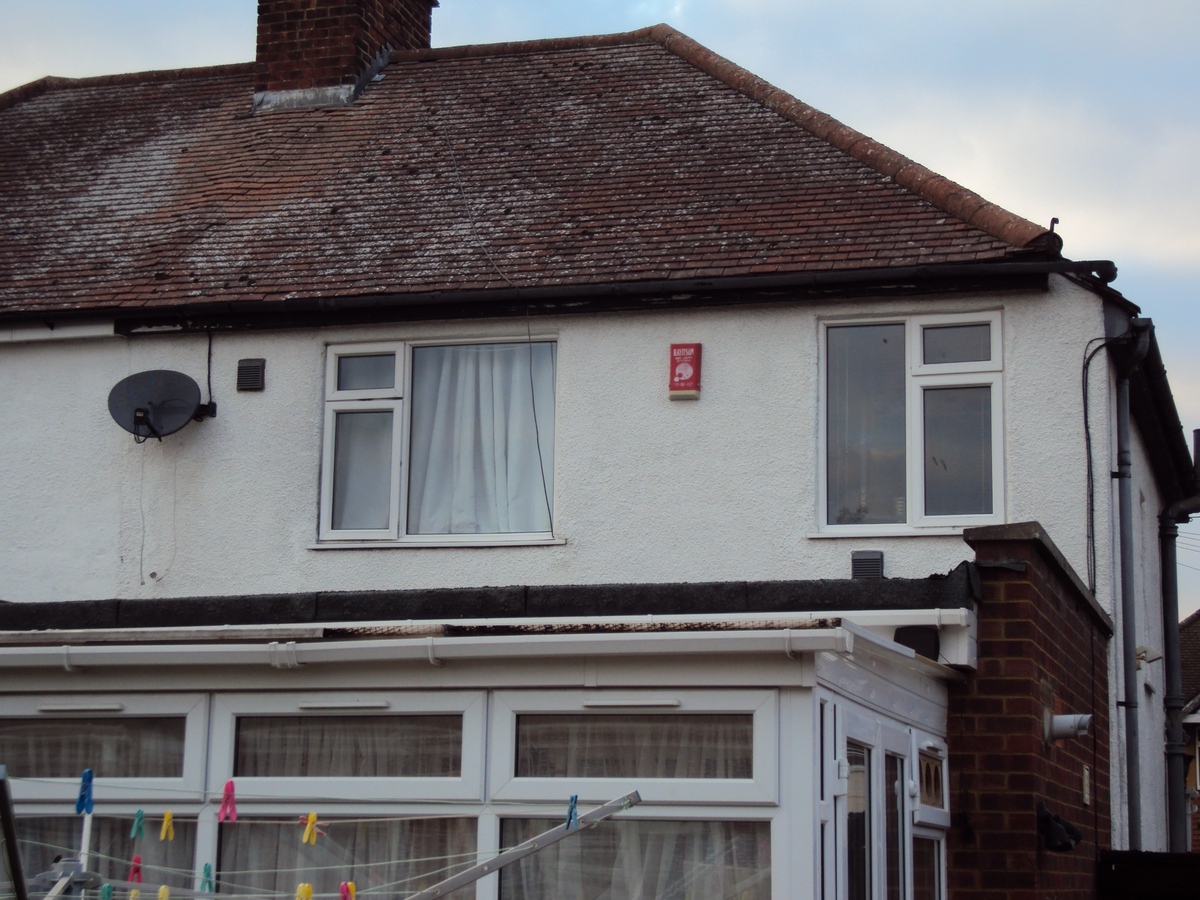

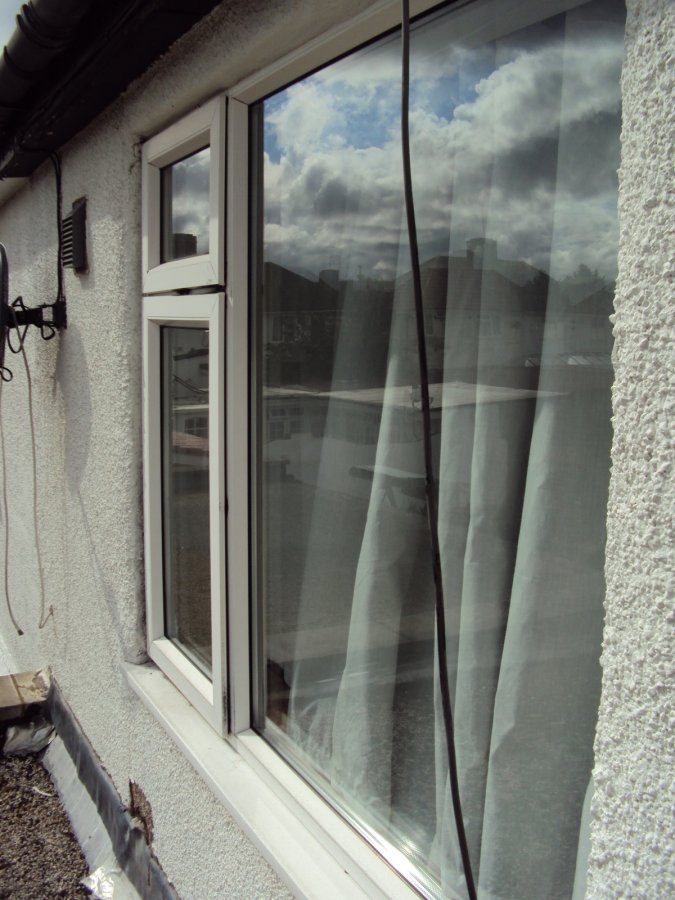

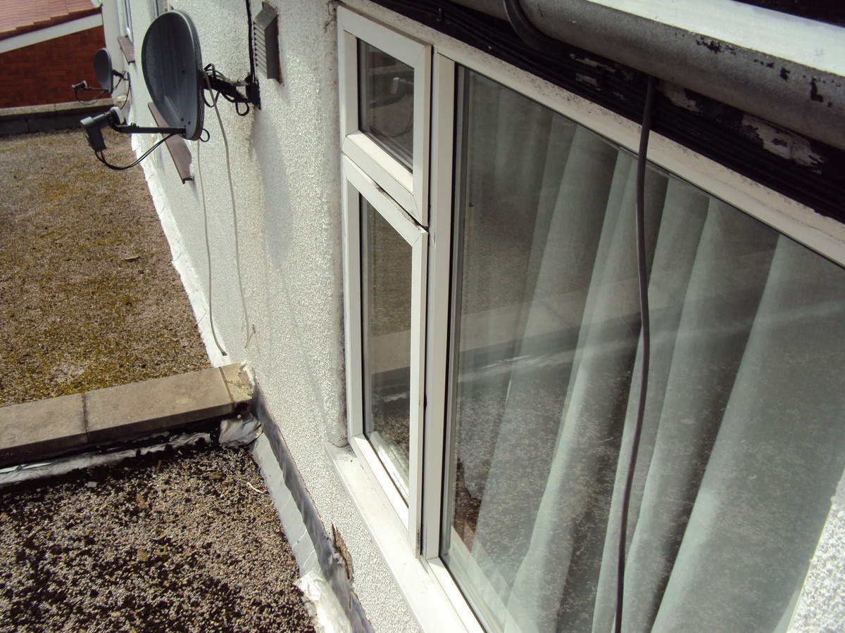

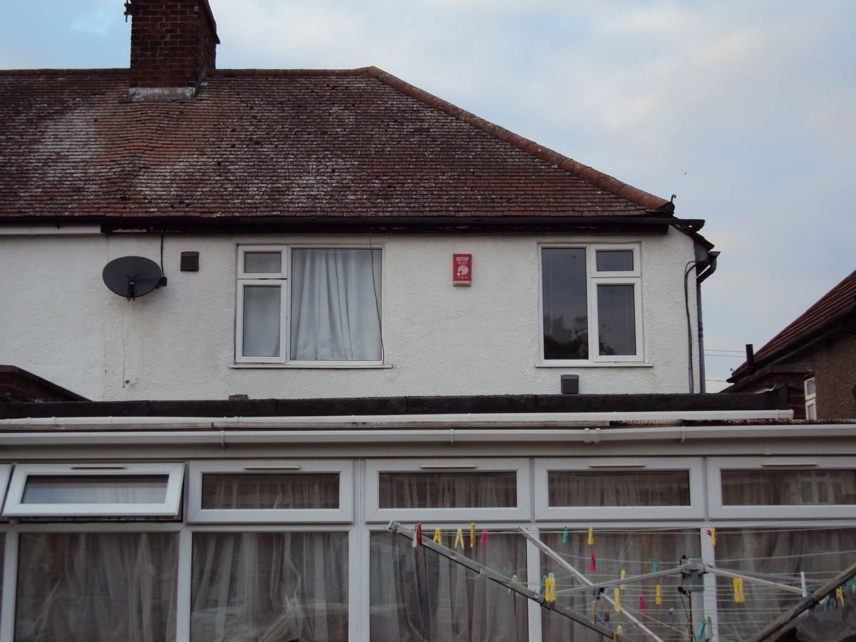

Hello all,
Need to replace the whole upvc window (one next to satellite dish), as the frame has been cracked/broken by someone attempting forced entry (unsuccessfully) at some point with a crowbar (hard to see in pics).
I’m asking for advice on how to approach the task, so I get a good result.
I keep hearing horror stories of people ending up with poor hardware, poor installs, poor guarantees etc.
How should I go about sourcing a decent supplier/manufacturer/installer.
What so I be looking-out for in the quote?
What should I be looking for in the specifications?
Basically – looking for help to ensure I get a good install, value for money and a decent job done.
If you have any experience/knowledge/hints or tips that can help me get this done right, I would be most grateful for any contributions.
I would also be very grateful, if anyone could point me to resources that would help me in getting this job done well.
My sincere thanks,
SirLancelot

Go with a local company for one.
Facebook is good for asking for local recommendations.
Ask if the fitters are employed or self employed. Employed is usually better.
Assuming the company are Fensa or Certass registered ask if their fitters and surveyors have MTC cards.
Other than that you cant go too far wrong with a modern A rated window that is internally beaded.
If you are worried about security you could ask for quotes with and without laminated glass on the external pane.
