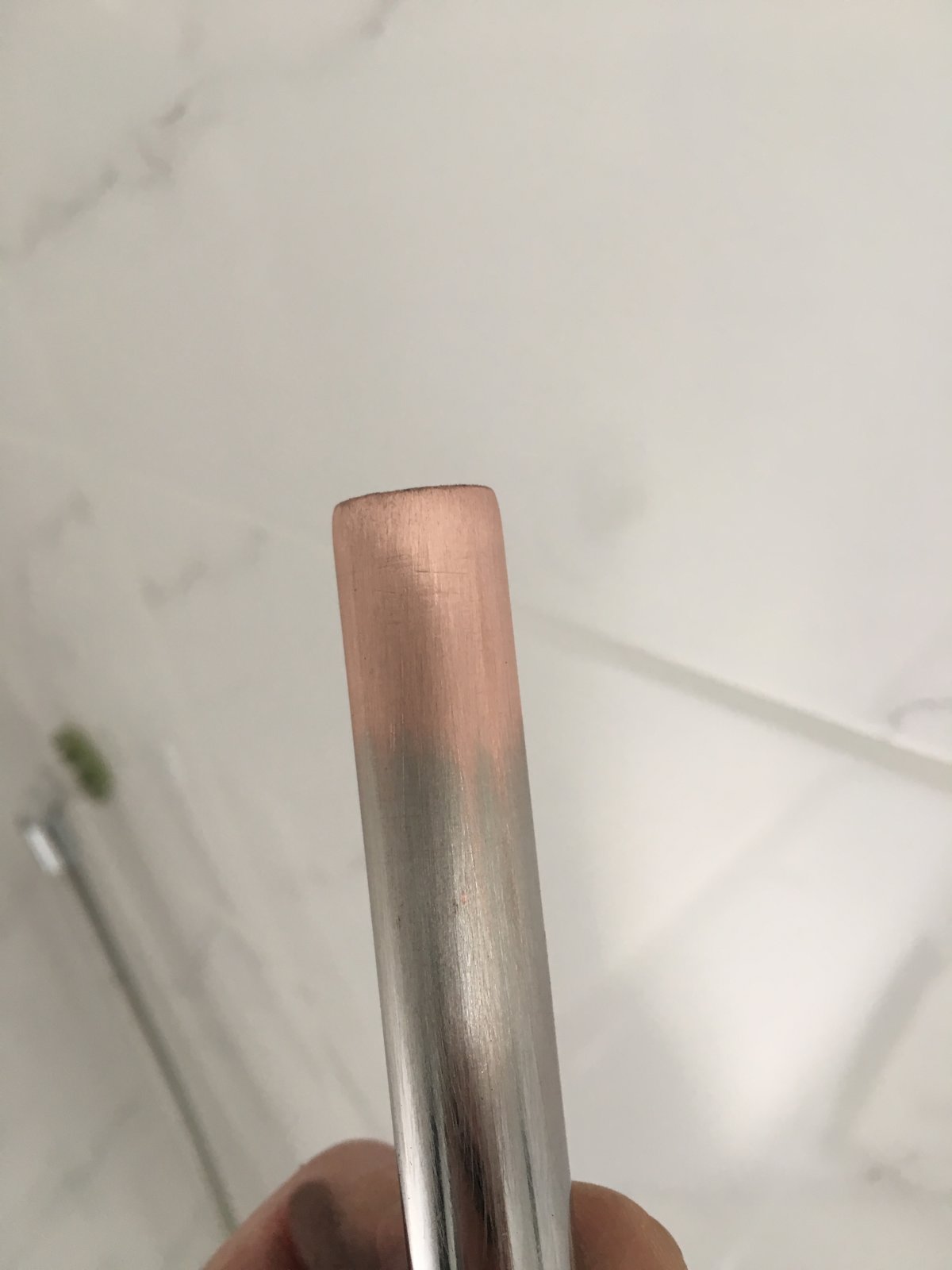

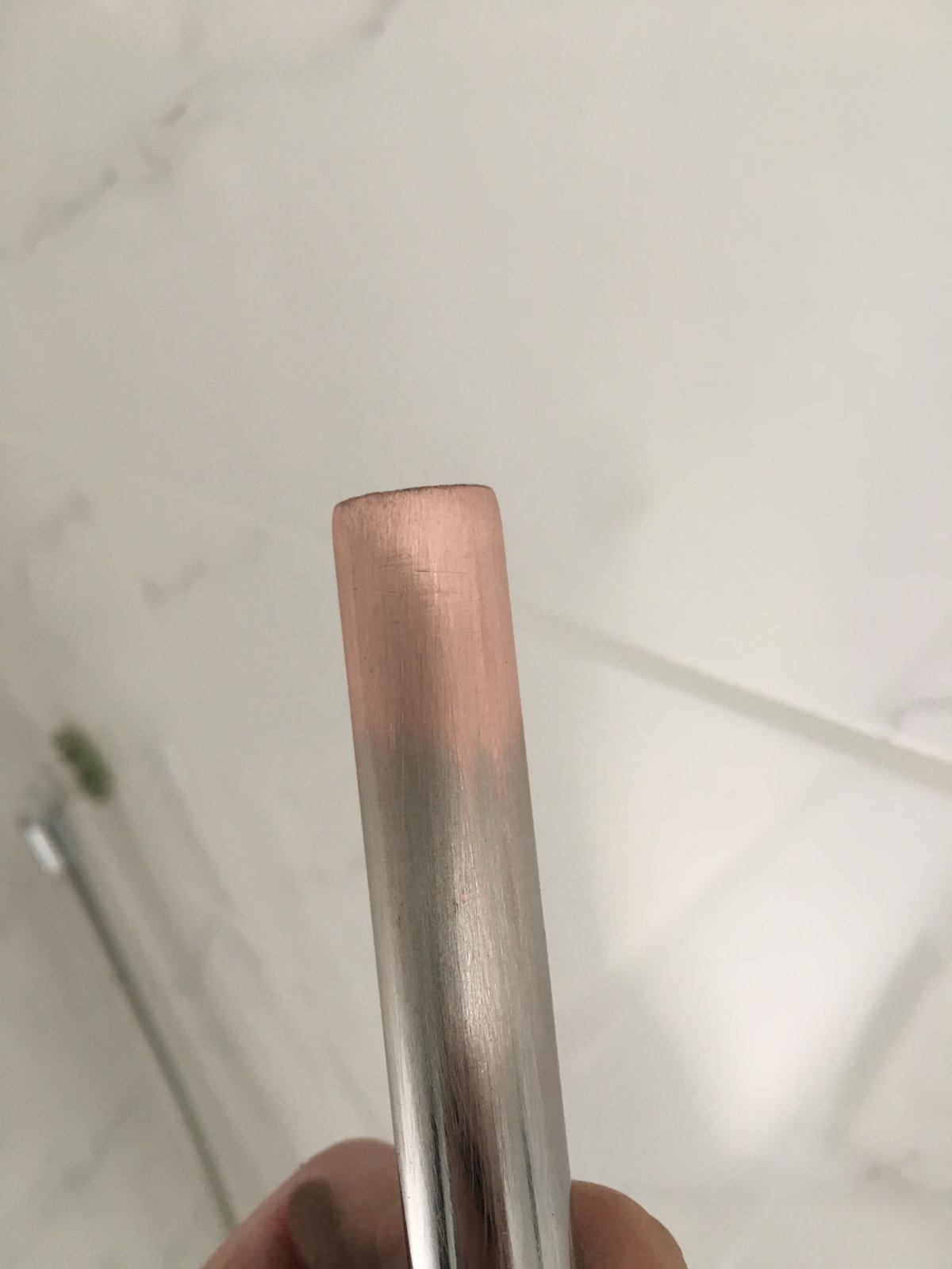

I just stumbled online someone saying it's a no no. Surely not though..? I made a couple of connections from normal copper with JG onto the visible chrome pipe. They're for a bathroom towel rail that isn't yet connected to the heating. I actually used Speedfit because thought might be preferable to compression incase the compression joint didn't seal (it's so so for accessibility if there was an issue when connected).
I think I already did, but should making sure the chrome pipe is roughened up a bit with pipe cleaning gauze be fine?
You need to strip the chrome off it - the teeth inside the Speedfit fitting can't bite into chrome properly and sooner or later it'll blow off
Can you manage to strip the chrome off it without huge difficulty...?
I’m assuming this applies to most plastic fittings but I also imagine they’re often used (like I have) with chrome pipe
yes it applies to all Plastic fittings as advised you have to clean all the chrome off the section that will be inserted into the fitting or the grab rings cant grip the chrome.
I understand. Though this evening as an experiment I tried a new bit chrome pipe in a new JG elbow and by the clappers it absolutely won’t pull out (unless the collar is pressed) so the teeth do actually seem to be gripping it well

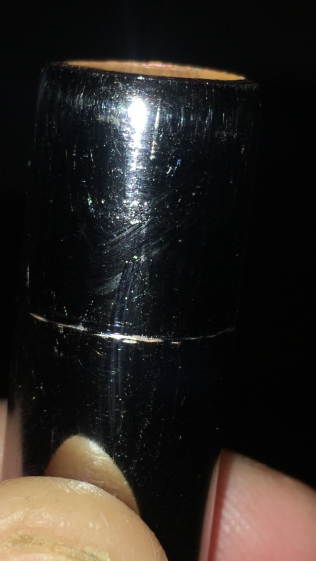

Just looked closely at my chrome pipe and it has scored/marked where the teeth in the fitting gripped it. I do however imagine some variants of chromed pipe might be tougher so might not look marked or grip well

You can see my pipe has scored/gripped surprisingly well. I’m not saying people shouldn’t be mighty careful though
It might grip now but will it still hold after several hundred cycles of heating and cooling and pressure fluctuations?
Better to strip it as per MI's.

Yep, better safe than sorry. Chrome stripped off easily enough. Screwfix pipe. Not a criticism, probably the opposite
