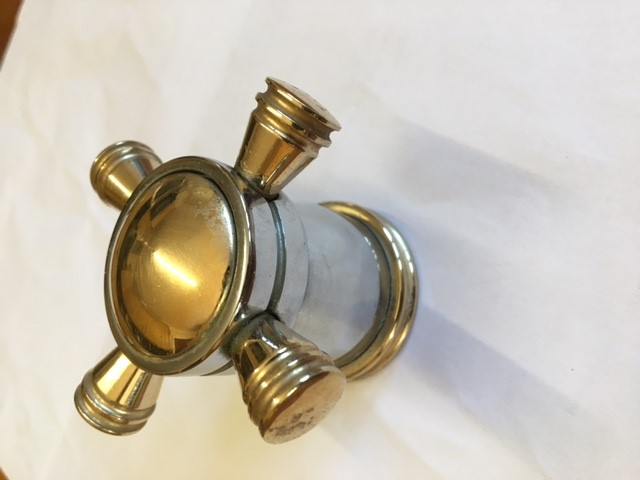

I have beautiful Pegler Biarritz crosstop taps but one tap has started to spin and not turn on/off the water. I can pull the tap head off and can see that it is attached to a plastic corrugated spindle. Inside the tap head the plastic corrugated sheath that attaches to the spindle is no longer firmly attached to the body of the tap head, it spins round freely.
As these taps are no longer made and despite searching for months I cannot find a spare tap head, my question is, is there any way to secure the inner white corrugated sheath to prevent it from spinning, or can I renew it with a spare part (don't know what it is called)?

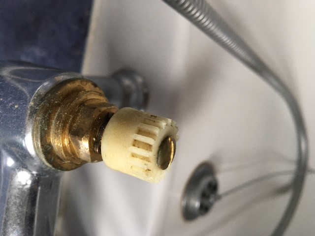

2. The white corrugated bit is usually a splined (the corrugations) adapter which goes between another set of male splines on the (usually brass) spindle of the tap and the female splined interior of the actual handle.
3. The reason for having an adaptor is usually to allow the tap handle to be positioned in a particular orientation. The adaptor has more spines on the outside than the inside, so by removing it and rotating it, the tap handle can be made to sit in a particular position when the tap is closed.

Hope you can see the images.

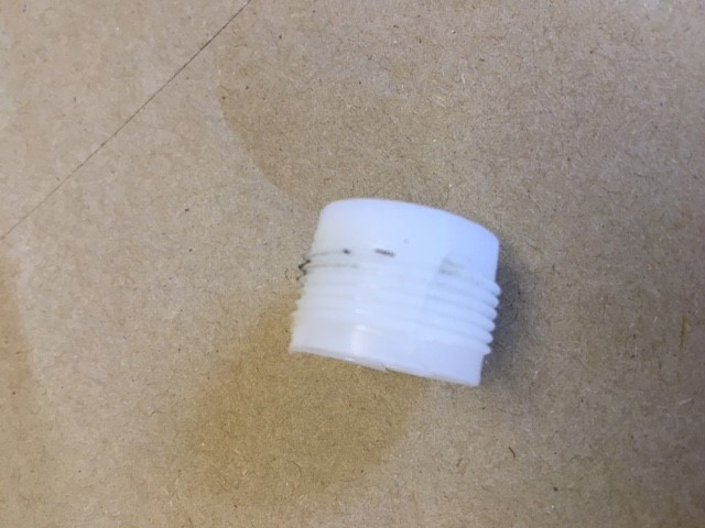

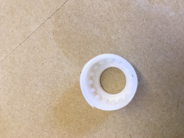

When I unscrewed the inner corrugated sheath (adaptor?) from the tap head I could see that it was split so this is definitely the part that I need to order. It has 16 teeth inside and is threaded on the outside. I would really appreciate any help with nomenclature or repair options (can't imagine I could glue it effectively). If I knew what it was called I could try to source one online but I'm struggling as everything seems discontinued.

I contacted Plumbers Mate yesterday but still waiting for a reply. The item that you highlighted has 20 teeth and seems a bit smaller across the threads. I suppose the important bit is to get the correct size threads to tighten back into my tap handle, I could then replace the spline on the tap unit to match the number of teeth?
So am I seeking a 'screw-in carrier adaptor'? It would help to get the name right when I search.

Failing that if you don’t want to replace the tap, get new inserts with 20 teeth and use the adapters?

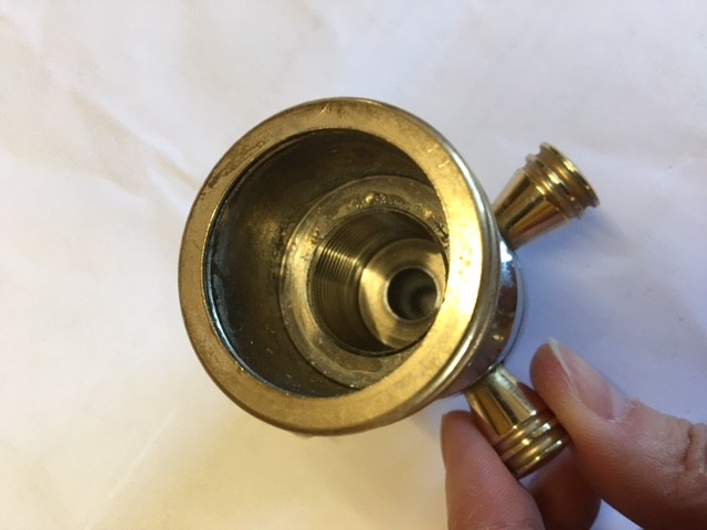

If I replace the broken internal female adapter within the tap head (photo 5) with a 20 teeth one, can I simply replace the male adapter on the tap unit (photo 1) for another 20 teeth one? Presumably the adapter on the tap unit (photo 1) sits on the splines of the ceramic cartridge so does this adaptor also need to have the correct number of internal teeth. If so, does this mean I will have to change the ceramic cartridge as well to accommodate 20 teeth spline adapters?
