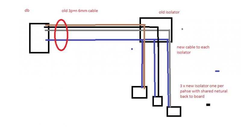

Ok.
Where is the shared neutral?
If you are talking about the supply to the CU, then it's alright; that's how it is done.
If you are talking about the circuits to the pumps having three lines but only one neutral, then that is a different matter.
I think a better description of the set up would be helpful.
You say that, but isn't it a common situation with, say, 3-phase lighting (albeit usually with a 3-pole MCB, not 3 single-pole ones)? As recently discussed, provided that the currents were fairly sine-wave (i.e without excessive harmonics) the single neutral (of same CSA as the Ls) would not be a problem, at least in terms of CCC, would it? Indeed, doesn't essentially the same situation arise with, say, a 1/3-phase cooker fed from a 3P+N supply, if each phase feeds one element - the only real difference (from 3 separate pumps) is that the three elements are 'in the same box', isn't it?

if you just read my posts all the information you request is there
1 20a triple c/b 3pn 6mm cable to isolator
20a triple breaker removed
2 x 16a fitted
1 x 10a fited
from original outdoor isolator
3x new isolators 1 per phase neutral onto old supply in old isolator
old isolator kills all three
local isolators kill each pump
hope that makes sense

Not really/completely .....
.... from original outdoor isolator ... 3x new isolators 1 per phase neutral onto old supply in old isolator
As I understand it, the crucial question EFLI was asking was whether or not there are separate neutrals from each of those 3 new isolators to the 3 pumps (I suspect there are) - is that the case?
[the fact that the three single-phase isolators/breakers are fed from a common neutral is essentially no different from what happens in any DB/CU or distribution system]

as per attached. the neutral is common back to the board. each phase is on a separate c/b
That's what I imagined. I'm no authority but, as far as I can see, if you renamed "old isolator" as something like "remote DB", the 3P+N cable between the main DB and that would just be a 'distribution circuit' and everything would be 'as expected', so you would probably not be questioning it?
Yes, but to be honest, contrary to what Mr.Bartlett says, I couldn't make head nor tail of his description.
His quotes of "and fitting 3 x singles 1 x 10a 2 x 16a" and "He said he did not want to rewire from the board" left me wondering where these were.
Could it be one 1mm² neutral carrying 42A ???
Maybe just me.
Yes, but to be honest, contrary to what Mr.Bartlett says, I couldn't make head nor tail of his description. ... His quotes of "and fitting 3 x singles 1 x 10a 2 x 16a" and "He said he did not want to rewire from the board" left me wondering where these were. ... Could it be one 1mm² neutral carrying 42A ??? ... Maybe just me.
No, it's not just you. However, his diagram is clear, and corresponds with what I had guessed/assumed. As I've written him, although I'm no expert, it looks fine to me - essentially a 3P+N distribution feed to three single-phase circuits (each with their own neutral :) ) - no different from what happens in many a DB.
What I'm less clear about is what it was that the electrician didn't want to do - take three single-phase circuits (L+N) separately back to the main DB (which I would say is probably totally unnecessary), I presume.
Kind Regards, John
3 p&n 20a supply on 6mm cable 15m run
why would you think it was 1mm?
EFLI was talking about the final (single-phase) circuits, and noted that all you had told us was that there was 1 x 10A circuit and 2 x 16A ones. With ideal cable routing ('clipped direct') those final circuits could theoretically each have been wired in 1mm² cable.

why do you think was he talking about the size of the final cable when the topic which was shared neutral and acceptability .?
I'm sure that he can, and probably will, answer for himself, but I think some clues can be seen in:
Where is the shared neutral? ... If you are talking about the circuits to the pumps having three lines but only one neutral, then that is a different matter. ... I think a better description of the set up would be helpful.
and
... but to be honest, contrary to what Mr.Bartlett says, I couldn't make head nor tail of his description. His quotes of .... left me wondering where these were. Could it be one 1mm² neutral carrying 42A ??? ... Maybe just me.
As I've said, for there to be a 'shared neutral' in a 3-phase supply or distribution circuit to the point at which it splits into three single-phase circuits is really just 'as expected'. EFLI presumably also knew this, and therefore was probably struggling to try to work out what 'shared neutral' was concerning you. [Assuming your house has a single-phase supply, the neutral feed to your house will be 'shared' with consumers on the same phase and the other two phases for most of the way back to the substation.]
