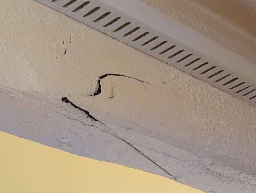

Hi
Could anyone advise on best options for fixing this please? House built in late 1800s but loft converted maybe 30 years ago. The purlin is roughly 15ft long and this split is about 6ft away from one of the ends. Don't really want to replace the whole thing but looking at options.

Splice something to it like a steel plate if you are not going replace it.

Does it need to be the full length of the purlin or just in the area where the split is?
Edit: I just reread and get the 600mm
So, when I posted this I'd already asked a structural engineer to come have a look. Supplementing the purlin is recommended. So, now I need to get a 250x75mm lump of 4m long wood up into the loft.

35 years experience, report done for free (a work colleague) and He’s not doing the work. My joiner is. ,)
Reasoning was a surveyor will pick up on that so it’s worth spending £60 on materials and £100 fitting it to save pain later on.

Both the joiner and roofer said ply but we decided we wanted a report with recommendations and actions to keep for when we sell and not open to questioning/increased risk of buyer pulling out.
The structural engineer did say it’s 50/50, might never fully go but got to consider how it happened and potential it going further. He also said ply would have been fine but the crack goes all the way through so it concerned him.
