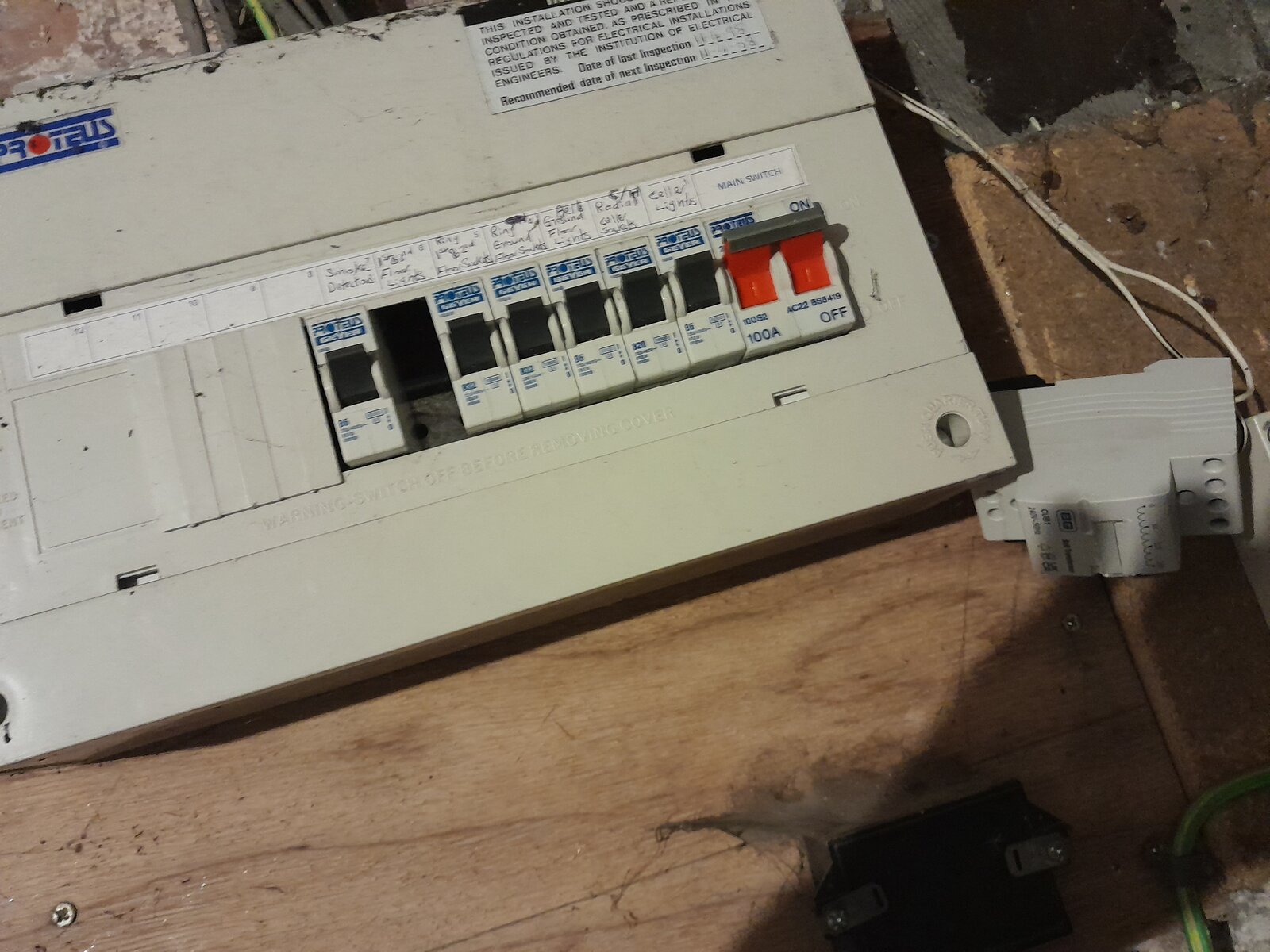

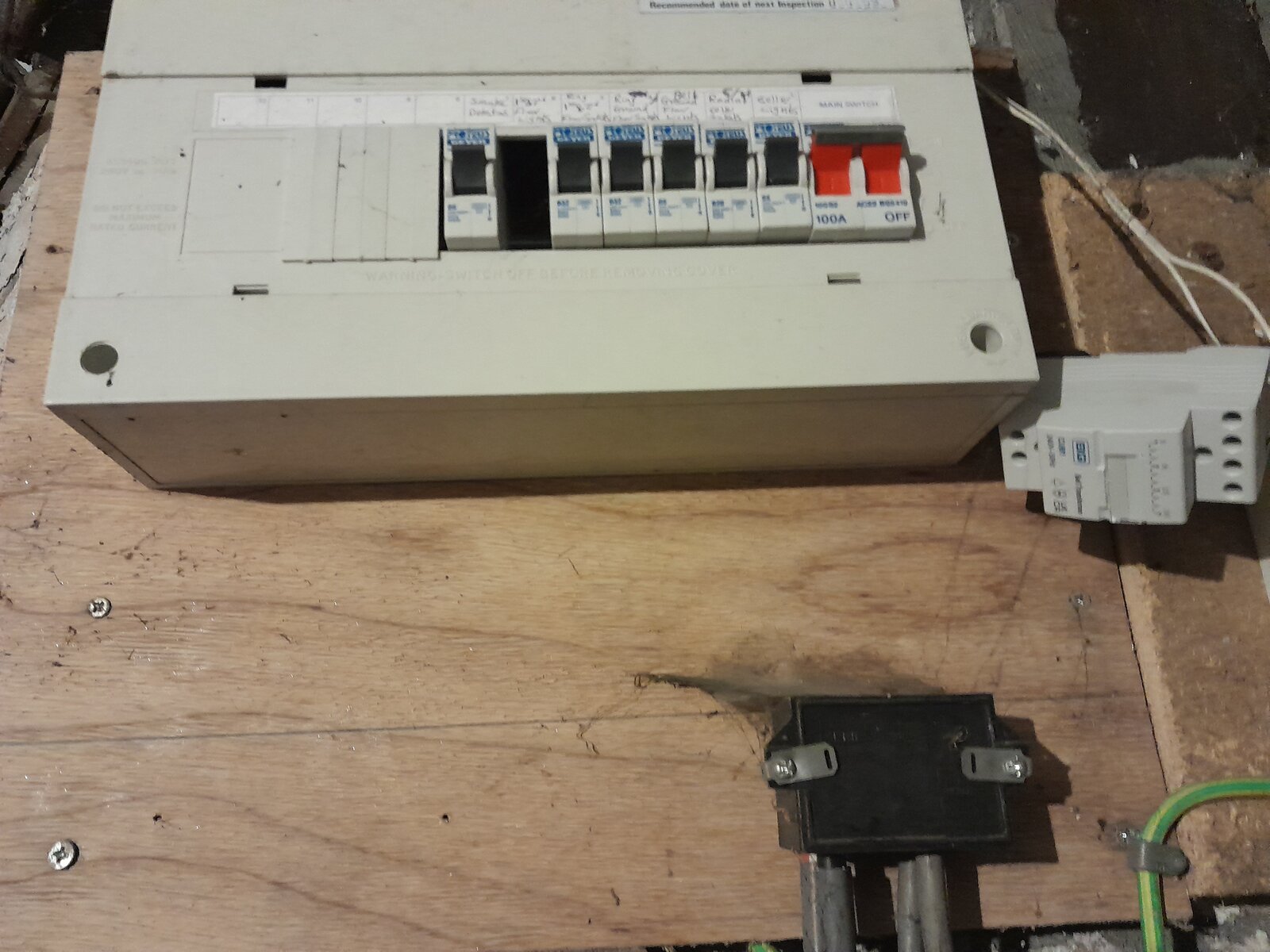

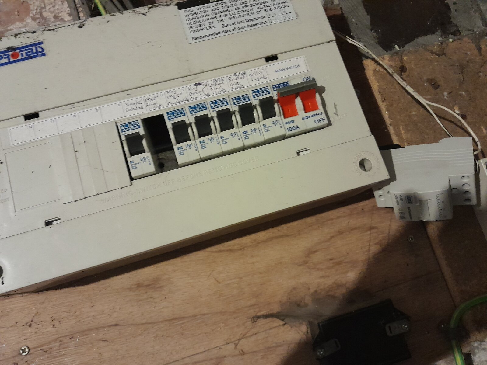

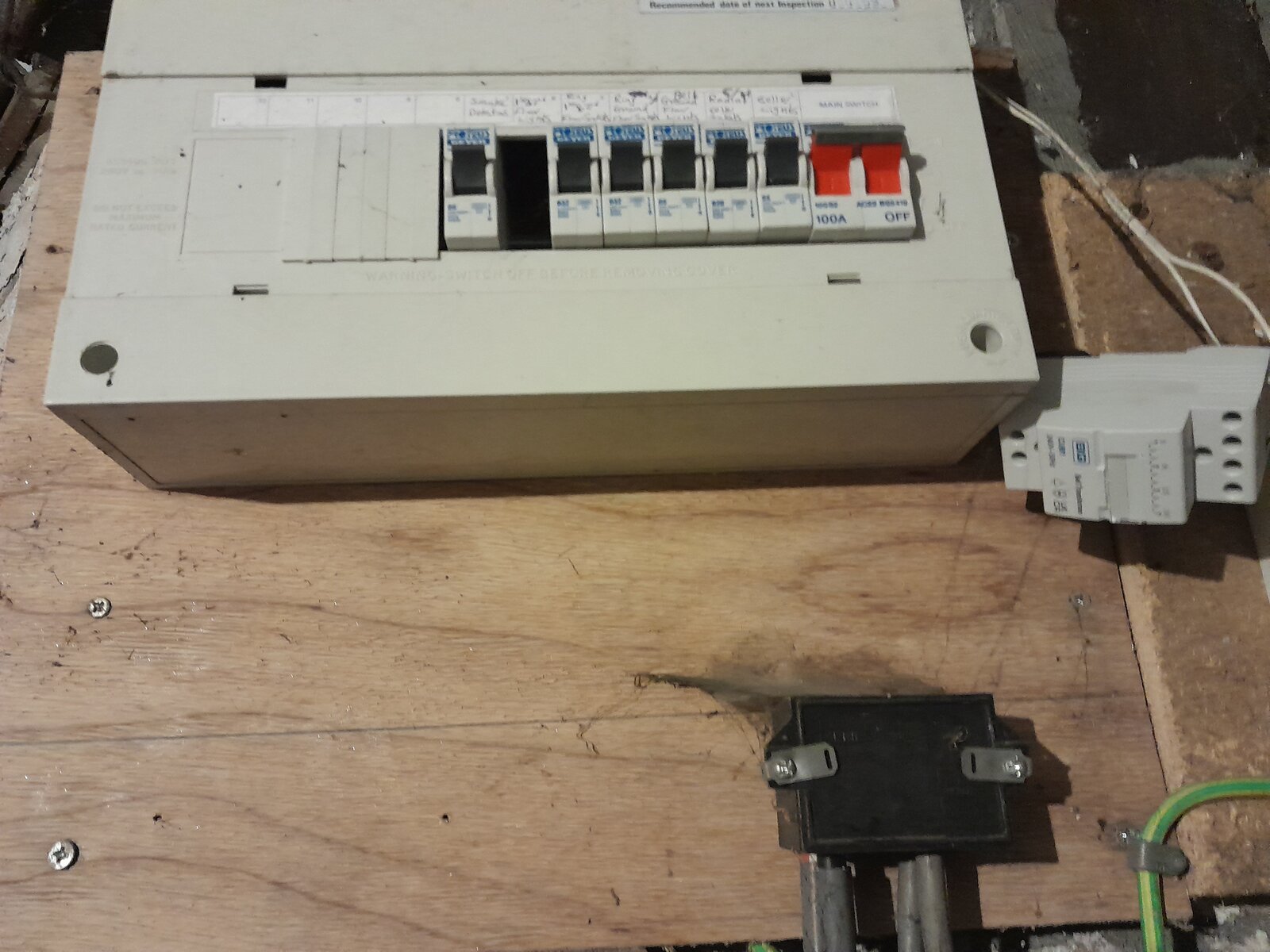

Does the lighting circuit have rcd protection?
I can't see it has RCD from what I can see on there. The bit thats hanging on thw side is a bell transformer.

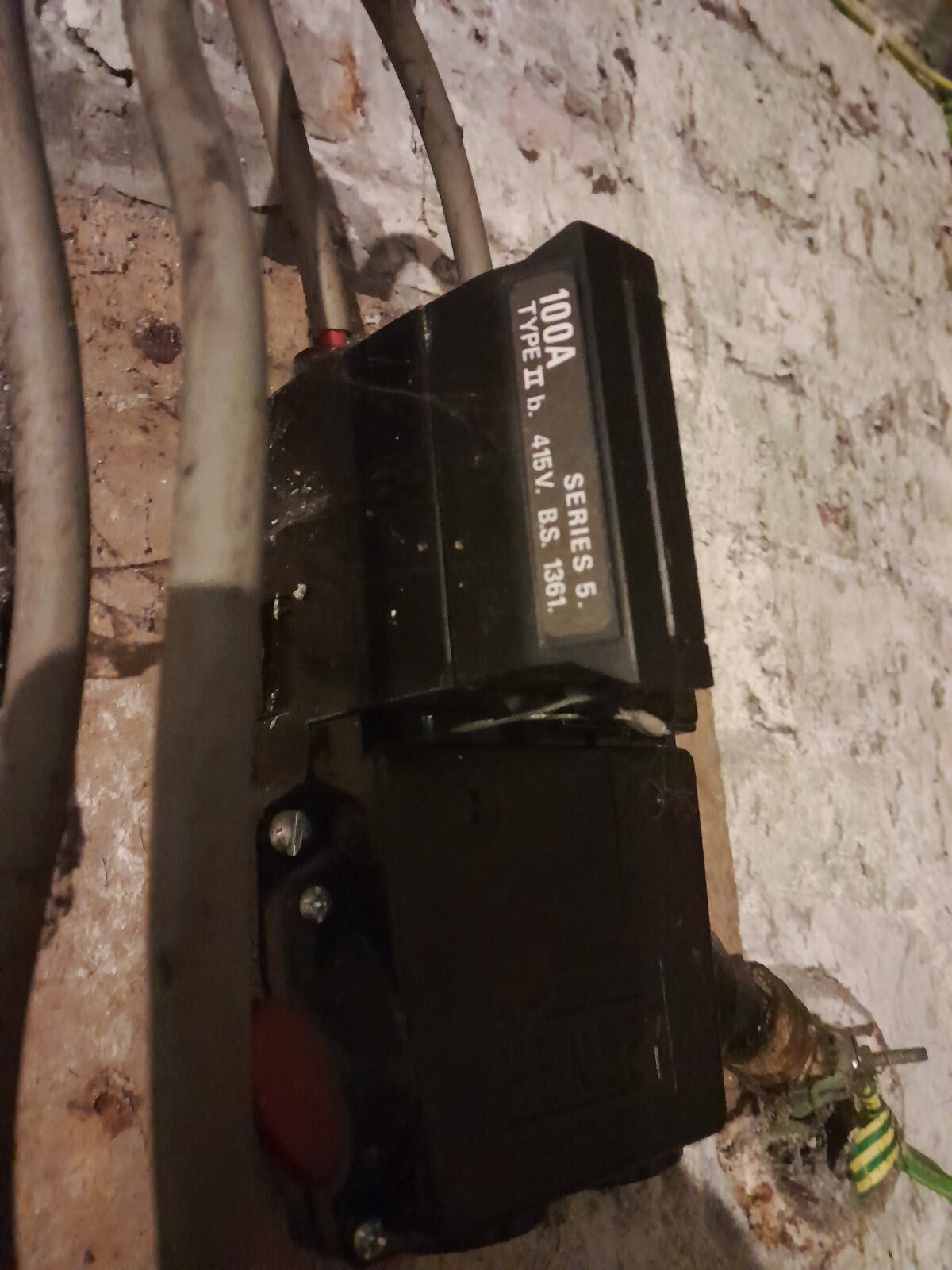

Mate, your consumer unit is time expired. Spend your money on getting that up to date, and do the lights afterwards n
Thanks for that. It hasn't caused any issues of yet. So I'll leave that for now. Hopefully revisit in the very near future.
No changes to fixed wired circuits without rcd protection and earthing and bonding up to date
So I will need to put a new Circuit board in before I'm allowed to add the spot lights?
Is that purely from h/s perspective ? Or legislation/regulations etc?
YOUR health and safety as well as Wiring Regulations. If you ignore those , it’s only your house and your family. What could possibly go wrong?
