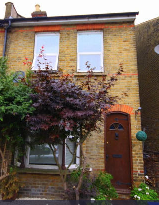

What would you say is a good estimate on the price of a new roof, please see pic below to property to give you a rough idea of size.
the new roof will cost far more with the foam in place as it will take far longer to do the job and use more materials
Ok thanks, property is below. What do you think with the foam in place. 8-10k?

Ok thanks for the info. I think I am going to reduce our offer by the amount required for a new roof and see what happens. I have a feeling they'll turn it down but not too bothered. Its just annoying paying out for the costs we have so far.
Also knock some £££ of to replace that hideous front door with fake band hinges and a fanlight IN it:eek:. But maybe keep an eye on it in your searching - because the vendors may one day realise they need to drop.
There is no easy way to remove the foam from the timbers so the entire roof trusses and upstairs ceilings might have to be replaced and you find somewhere else to live while the work is done. And if it's in England you'll probably need a Party Wall Act negotiation with the neighbour who can hold you to ransom for consent and costs.
If these are the visible bodges I'd be very worried what has been hidden (or what essential work has been omitted).
I'd be looking for at least £30k below market value before I'd even consider it.
