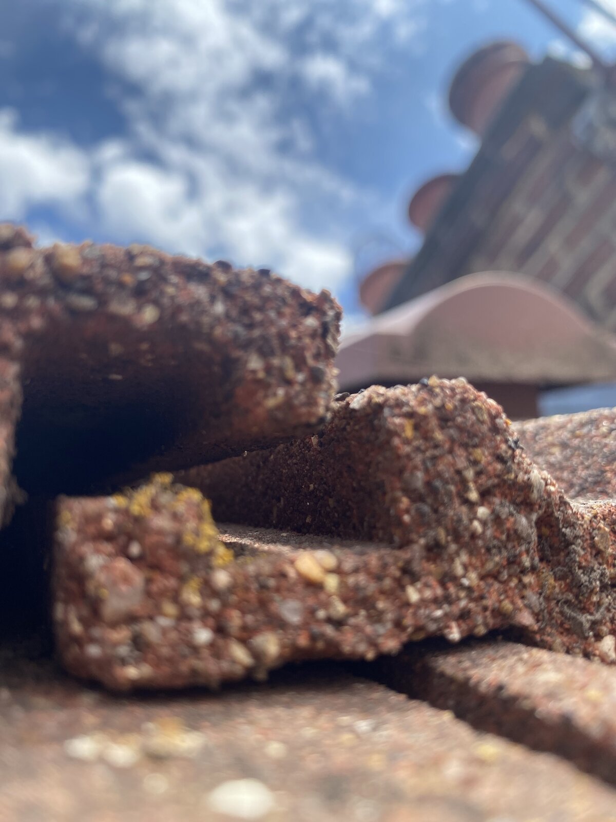

Hi guys
I am looking to spray my current roof tiles black but I don't know what material it is. I think it's concrete but looking for pointers please
Also anybody have previous experience around spraying roof tiles, food or bad idea?

They are concrete tiles, you would be best looking at previous jobs that have had it done in the past to see how it weathers before committing to it but bear in mind that roofs can weather very differently due to location, exposure etc so if you are on top of a hill in the Hebrides it may not last that long.
