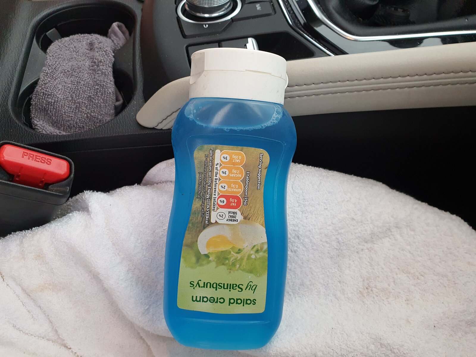

I keep that in my door pocket during the winter, just in case.
