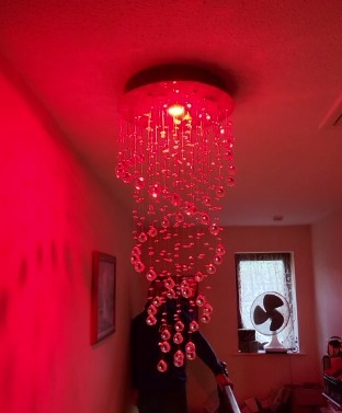

As to spot lights yes I have used them for main lighting, my son has just fitted a set of 5 at top of stairs for me, 1653986674715.png but they need some thing to aim at, be it glass balls, or picture on the wall, you don't want it to look like a planetarium, it needs to look like they have be selected to enhance the look of the room, not just a way to gain more head room. In the one shown I have a smart relay so outer 4 lamps are white and centre is colour changing and I can select which I am using, so multi light levels.
