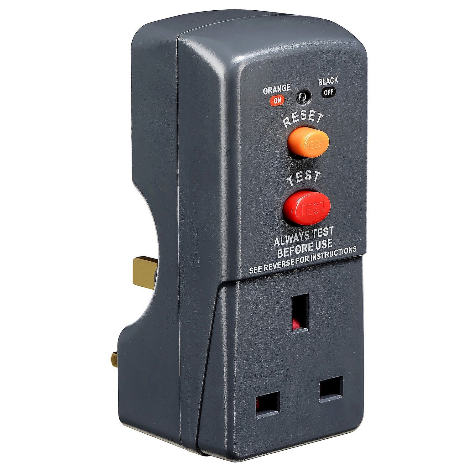

Good afternoon,
I am considering external lighting, most of which is powered by a standard UK plug.
In the past I have connected the plugs into a 'passthrough' RCD, such as this;
My question is whether it is safe (or wise) to further 'stack' such plus with other plugs. For example, would it be safe to put a smart plug into the RCD;
238324619
And then would it be safe to plug an extension into that (assuming all load is within the limits of the most limiting component?)
I realize that it is 'messy,' but it would all be off a socket in the garage, so there's no risk of anybody knocking them - the question is just whether it's safe.
Many thanks.

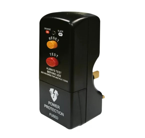

As above, if your CU is protected by RCDs, then extra ones are a little superfluous!
Otherwise, you can save one 'stack', by using a rewirable RCD plug, on the flex to your extension lead - something like:
You also have the option of using a smart extension lead:
Just change the plug for the RCD rewirable plug, and the jobs done :)

1. Not all items can be stacked cleanly. An item may have a shape that blocks stacking completely, but more subtly it may have a shape that allows the plug to be inserted most but not all of the way. For example your RCD adapter seems to have a slight lip just above the socket, if the next item in the stack does not accommodate that lip then it may not be able to be fully inserted.
