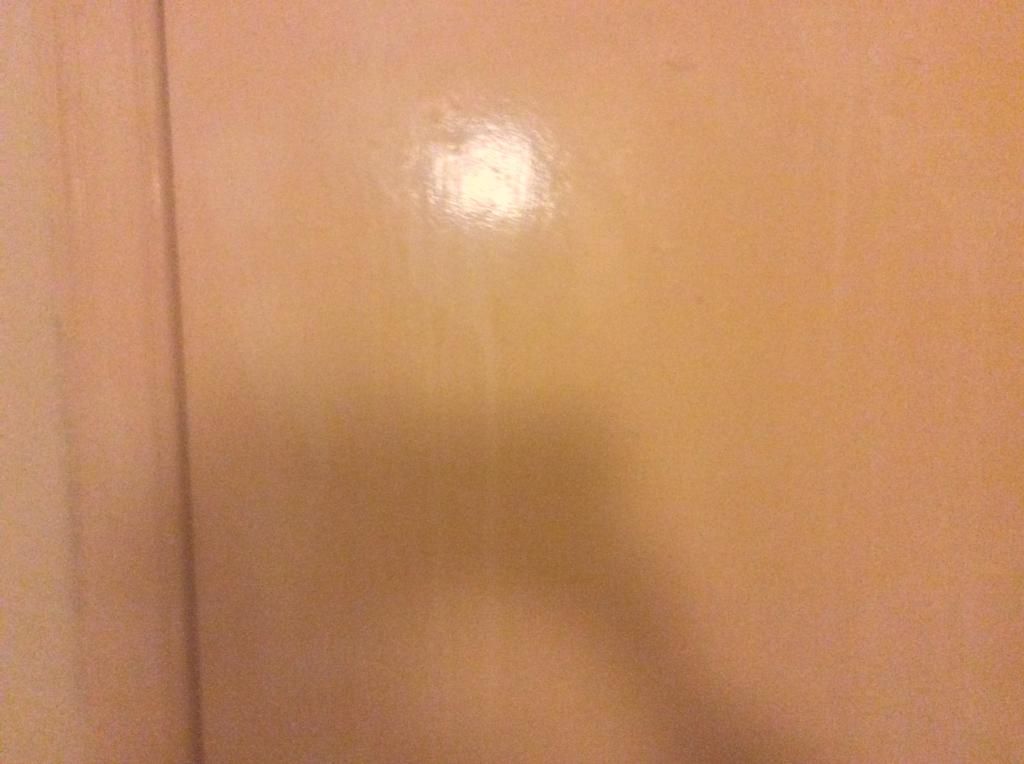

He gets really nasty about basic things; and hates spending money. Ive really messed ip; I sprayed bleach on the door; because it was really dirty (hasnt been cleaned in months, if not several years) and so thought that I would need to use bleach to santise and clean the area effectively.
There is now massive stains and splotches of discolouration on the door. On the other side of the door, it is white not snow white; but near enough. However, on the side I have sprayed with bleach; it is a creamy-yellow colour; with the white splotches were the bleach has been sprayed.
The damage is quite severe.
Is there anything, anything at all I can do to fix this mess? Id much rather try to fix it myself than talk to my landlord at all.
From the sound of it the door is painted. If so you may be better off just repainting the door

Would that be safe, to the door I mean? As long as I chose the right shade of paint, I could simply...."gloss over the stains" so to speak?
Wash-down the door with sugar soap (from local ironmongers, decorators shop, etc) to degrease it. Flat back the paint with fine sandpaper (e.g. P120 grit) all over the affected side to get a mechanical key (gloss onto gloss just peels off over time). Wipe down with a rag dampened with white spirits to remove any dust, etc. The white spirits are use to clean the brush after glossing, too. Then regloss. Make sure that you put down some newspaper on the floor to catch drips (even trade decs have drips - despite their assurances that they don't)

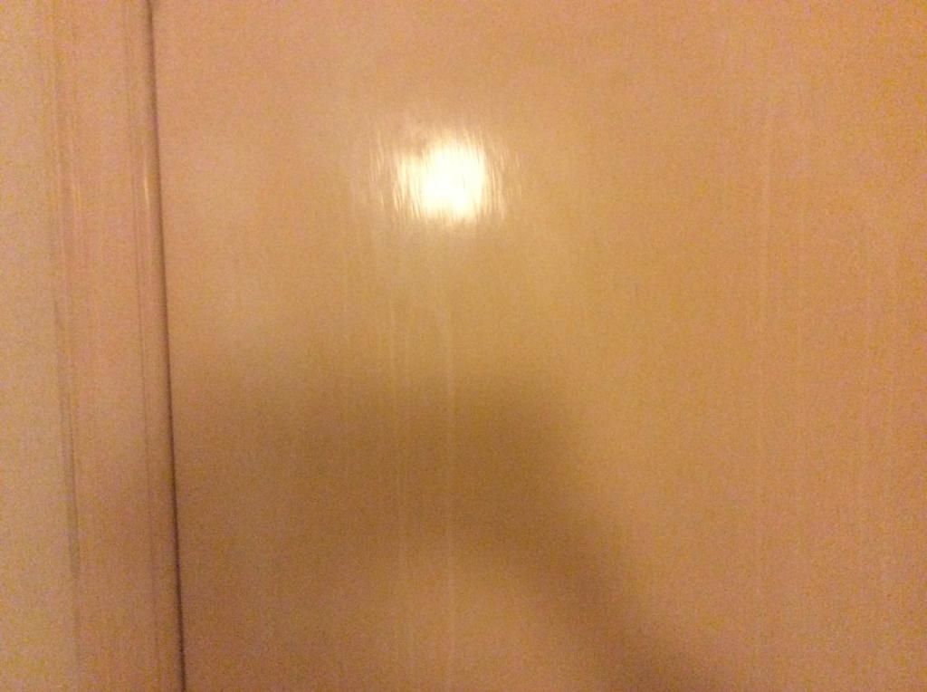

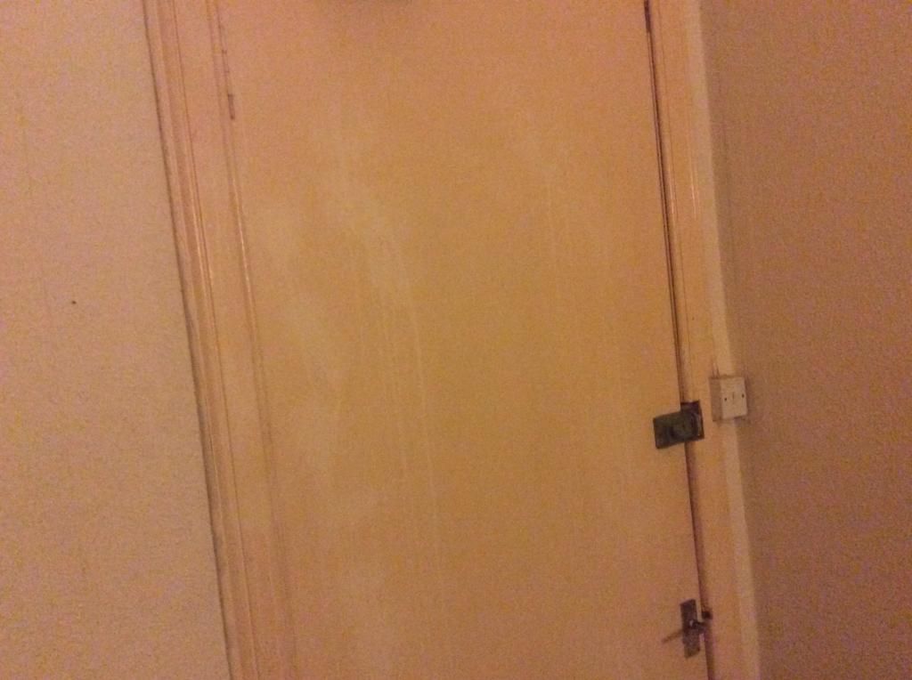

Hi guys, sorry for the delay in replying; was in hospital. That is some pictures of my door, I was thinking that Pale Citrus from Dulux would be sufficent for the door:
https://www.dulux.co.uk/shop/colours/yellows/
But not 100% sure.
What do you guys think?
