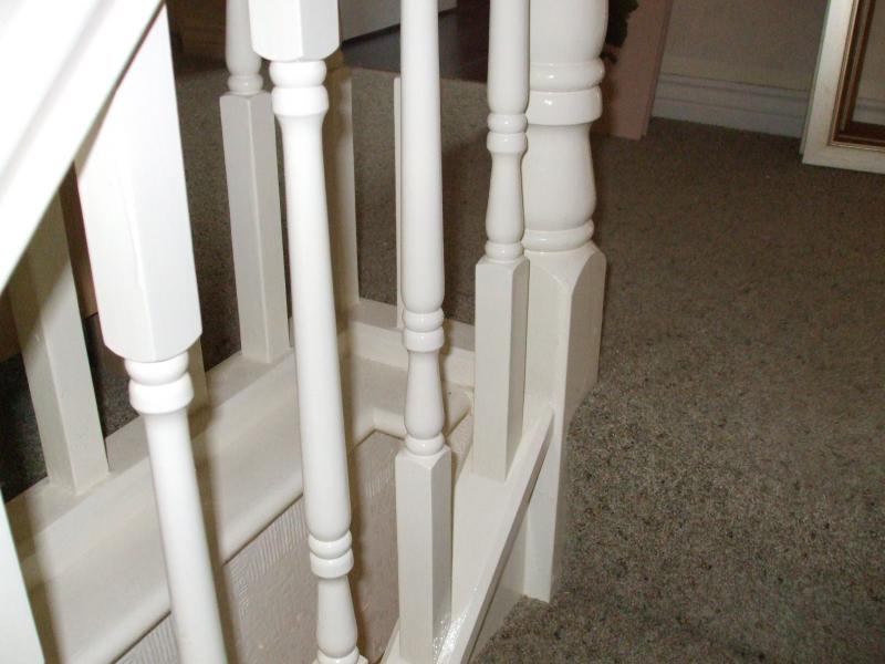

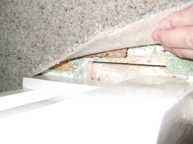

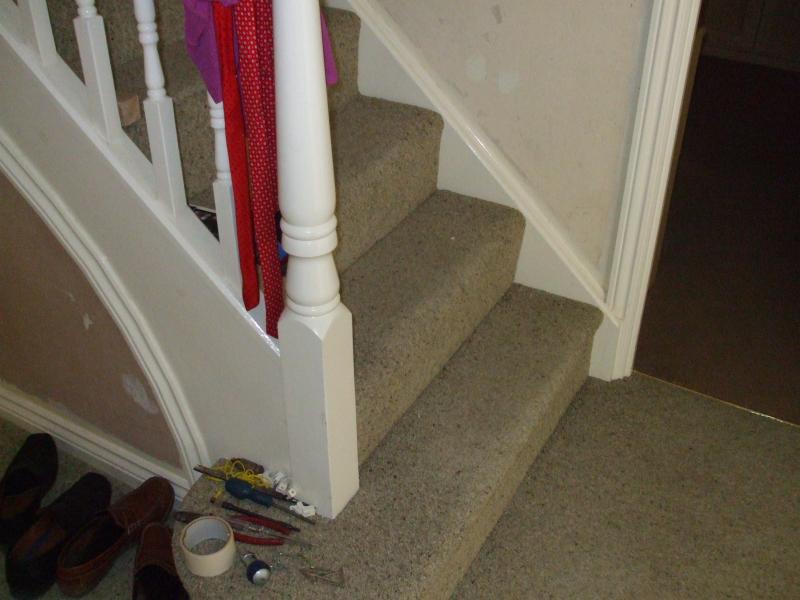

You can see from the original that the joiner who fitted them was in a rush, spindles not correctly spaced. What you don't see from the photos is the 1/8" step at the top which would get sorted as the job was done and the poor fixing of the half newels onto the wall at the top.

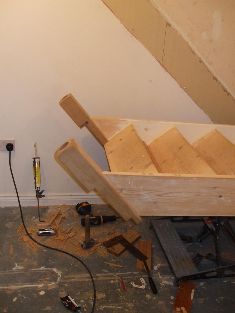

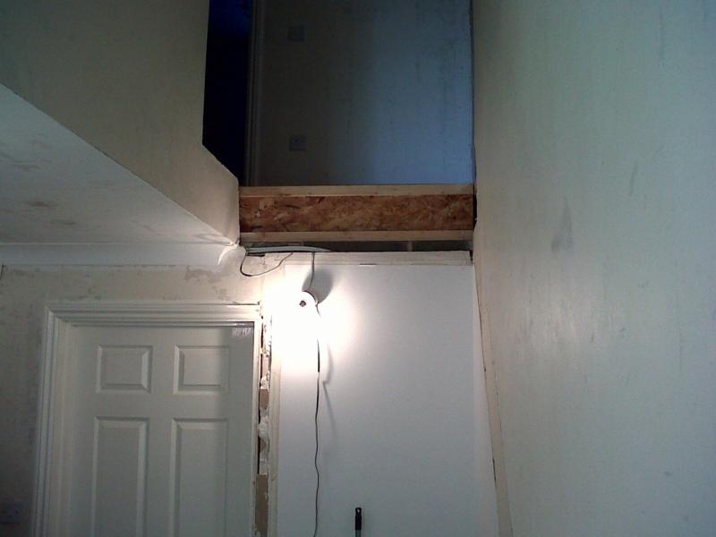

Did as much as I could to prepare the two top newels and on Monday the Curtail was cut off to make the stairs easier to handle in a limited space and stairs came down.
Wife didn't like the temporary stairs . . .

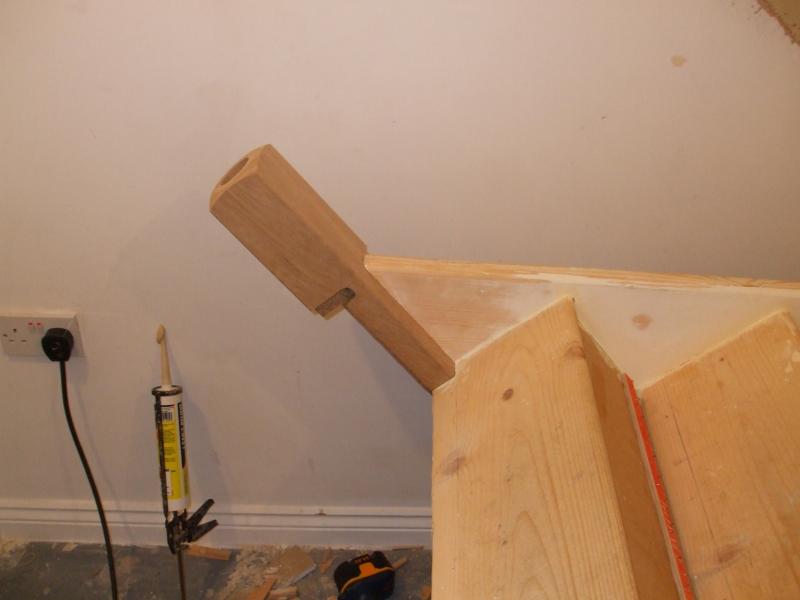

Existing Newels were removed in pieces with a saw and chisel, they split away from the tenon fairly easily.
Top newel bases were finished and fitted, dowels into blind holes so I only have two dowel ends to hide betwen the two newels, Nothing shows on the outside face.

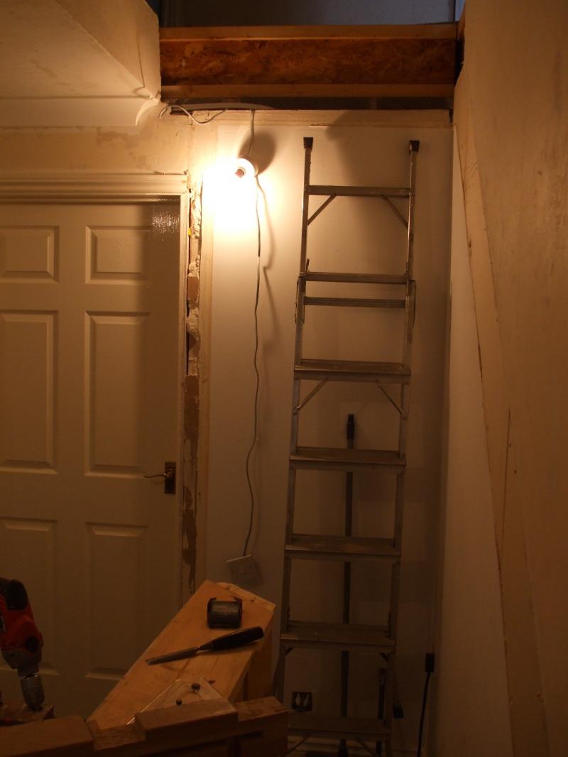

To achieve this the riser for the top step (landing) had to be removed and refitted.
All this accompanied by the recurring question "Are you sure you know what you're doing?"

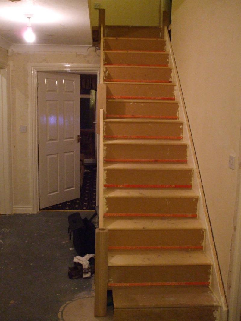

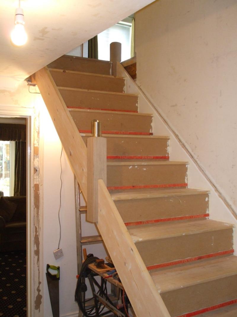

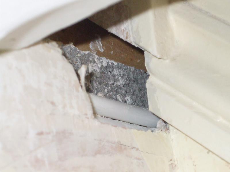

The short joist that the stairs sit on was removed, the wall cleaned up and the joist trimmed so it now sits at eh right level and the stairs were lifted back in.

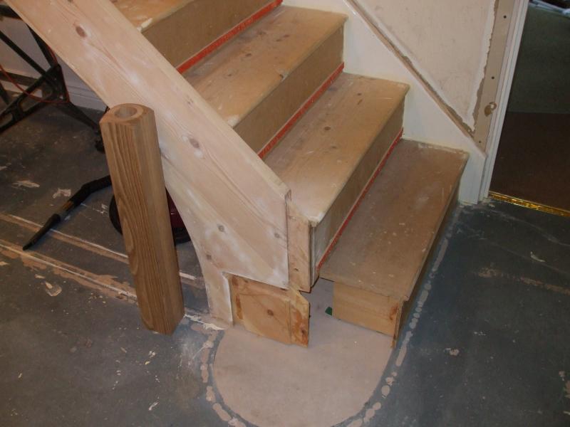

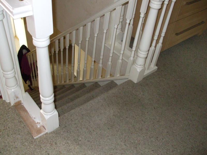

Middle newel shown fitted loose
Bottom newel base beflore fitting and fitted loose.
