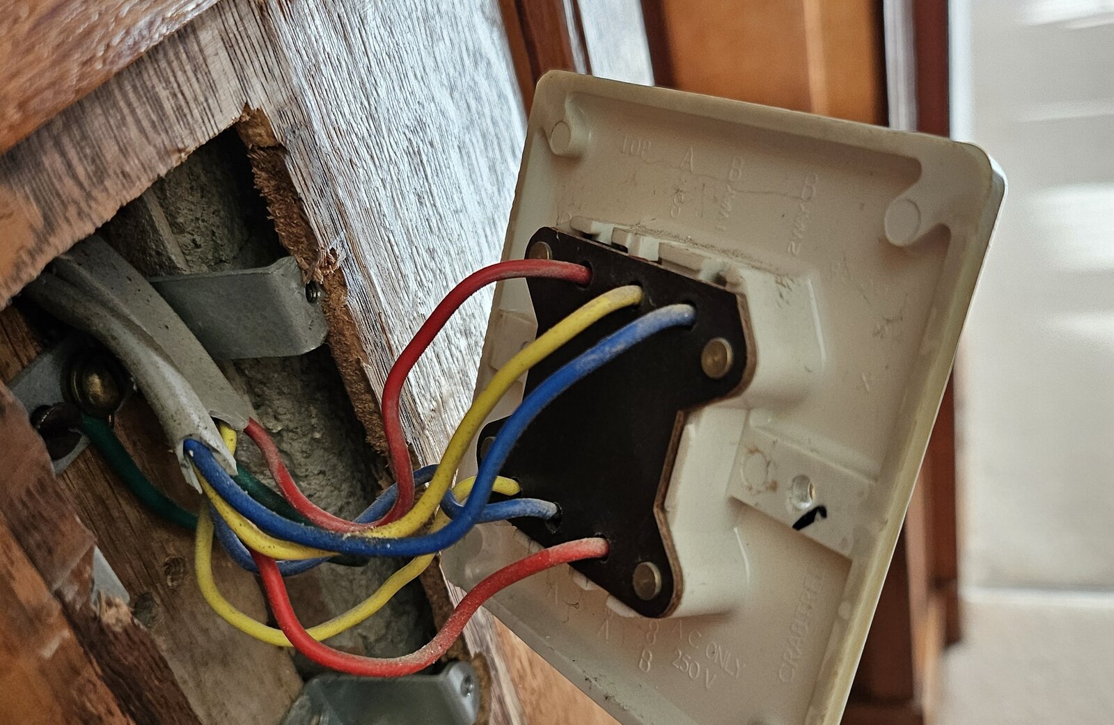

I have old light switches at the top and bottom of my stairs and I want to change them to new ones. I have found this is the wiring set up for them at the moment.
Downstairs switch is labelled like this
Top row connectors
A (COM) - red
B (1 WAY) - yellow
B (2 WAY) - blue
Bottom row connectors
A (1 WAY) - yellow
A (2 WAY) - blue
B (COM) - red
Upstairs switch is labelled like this
Top row connectors
A (COM) - red
B (1 WAY) - blue
B (2 WAY) - yellow
A (1 WAY) - yellow
A (2 WAY) - blue
B (COM) - red
Does this sound right???? Why is the yellow and blue not connected in the same way upstairs and downstairs? (puzzled)
The switch is a bit of metal wire permanently connected at COM. That metal wire then moves between the other two connection points, connecting COM to A1 or A2 in your example.
Hence it does not matter which of the pair of wires is in A1 or A2 as both of these connectors look the same to those two wires.
If you did switch the wires around (between A1 and A2) then the only difference you will see is that the switch itself will now seem upside down to the position it was in before.
See here for a diagram. The second diagram with three parallel wires is the most relevant to you. Consider the middle line as your red wire. And the outside lines as your yellow and blue wires.

Also - do not treat it as top row and bottom row.
The switches are each a triangle - one A and one B.
Thank you. Thinking of them as top and bottom row was very confusing. However, now that you have advised to think of them as triangles make a lot more sense!

Thank you. This is the existing downstairs switch connection. Does it matter which live / red wire go into COM1 and COM2 (as long as the two neutrals on the same cable goes into the L1 and L2 on the same triangle)?
The new switches have COM1 and COM2, whereas the old switches shown just has label, "TOP" and then COM and COM at top and bottom of the switch.

It does not matter.
To double clarify, all of the wires in a gray cable have to go into one of the triangles. (Ie one grey cable into one sperate triangle).
You choose which triangle based on which switch you want to use. Typically you have the switch to control the light in the side nearest the light.
Hope that sort of makes sense.

Also...
If you find a switch is upside down (I like all my switches when the light is off to be pushed in at the top of the switch) then swap the A1 and A2 over which each other (blue and yellow wire)
ALSO, you mentioned the two wires being 'Neutral
The blue and yellow wires ARE NOT neutral. The red wire is live and when you switch over the switch you are switching the 'Live' in the red into one of those two yellow and blue wires. They are then 'Switched Live' wires.
The colour of the wires does not always define what it is carrying.
There is actually no Neutral in that switch. In your case The Neutral wire is in the Ceiling Rose.

What you have learned is only applicable in the case of a "2-way" switch (i.e. one with three terminals, like those discussed above). If you had a simple "1-way" switch (with just two terminals) the only way you could get it to 'work the other way around' would be to physically rotate the switch by 180 degrees (which you can do).

... bear in mind that with a two way system both switches pushed in at the bottom will also be light off.
Both switches in the same positions - light off
The two switches in opposite positions - light on. :)

Each switch has two positions - say 'up' and 'down'. Whether one of the switches is in the up or down position determines which position of the other switch (up or down) will result in the light coming on. It therefore follows that, as EFLI has pointed out, there are two possible combinations of switch positions which will result in the light being on,and two combinations which will result in the light being off - and nothing can change that.
