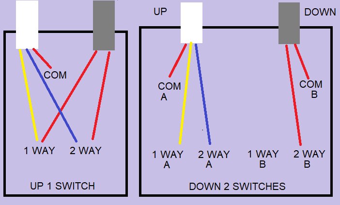

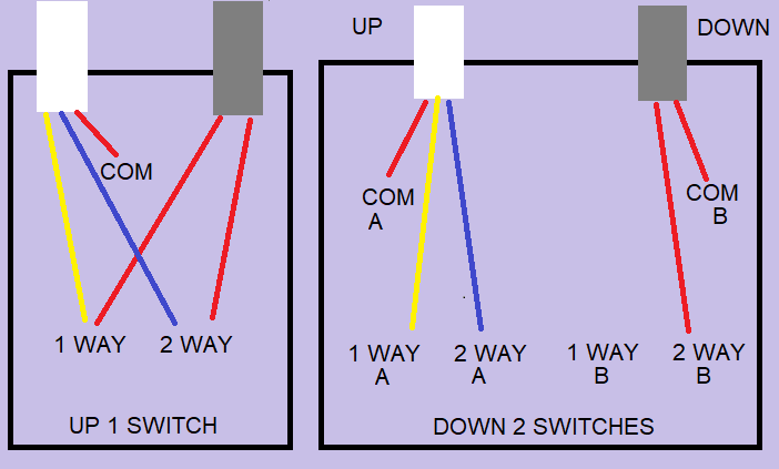

I have a 1 gang switch upstairs and a 2 gang switch downstairs.
Upstairs I have a white cable red wire in COM, white cable yellow wire in 1 way and white cable blue wire in 2 way. Grey cable red wire in 1 way and grey cable red wire in 2 way.
Downstairs I have white cable red wire in COM A, white cable yellow wire in 1 way A and white cable blue wire in 2 way A. Grey cable red wire in COM B and grey cable red wire in 2 way B.
I want to be able to switch the upstairs lights on/off from the upstairs switch and downstairs switch.
Can only suggest to check the connections.
Make sure the copper is not broken inside the coloured insulation.
It will feel floppy at the end if it is.
Or of course, one of the switches is broken.
Swap the Blue and Yellow in upstairs switch.
Then if light upstairs needs to be OFF, to be able to control it from downstairs, the upstairs switch is broken or one of the two wires is.
