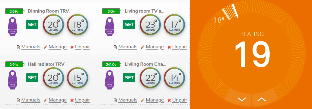

In my mothers house I had a problem both over and under heating, my setting of the lock shield valve with having no differential thermometer was to turn the lock shield off, then ¼ turn at a time until feed pipe just a little warm. This seemed to improve things, but the major problem was the bay window, when the sun hit the window the temperature of the room would sore. So I got first a pair, and then some more electronic TRV heads, it was actually not the speed that helped but the fact on the PC I got a report current and target. Heating not keeping up.jpg this allowed me to see at a glance which radiators were allowing too much flow, and those with too little, clearly if the current exceeded the target then the lock shield needed closing, and this was the case with most of the radiators.
And TRV be it electronic or mechanical takes time to open and close, typically the electronic when they exercise mid day Saturday every week take around 3.5 minutes to fully open, fully close, and return to setting, so a radiator should take at least 15 minutes to warm up, likely longer, to give the TRV's time to adjust. And all mine were open too wide, and as I adjusted them I found the TRV's were spot on, set to 20ºC I actually got 20ºC, the problem before was the TRV was marked *123456 which is a little useless when trying to set two things, once the lock shield was set the old mechanical worked well, but it was the setting of two devices which caused the problem.

What I noticed once set was radiators were only just warm, the rooms were to temperature, so radiator turns down, which means by pass opens and hot water returned to boiler, and so boiler modulates, as it should, so radiators never either cold or hot, they just stay warm, reducing the hysteresis as the TRV should.
But all my lock shield valves were open too much, and only found out once I could monitor temperatures on the PC.
