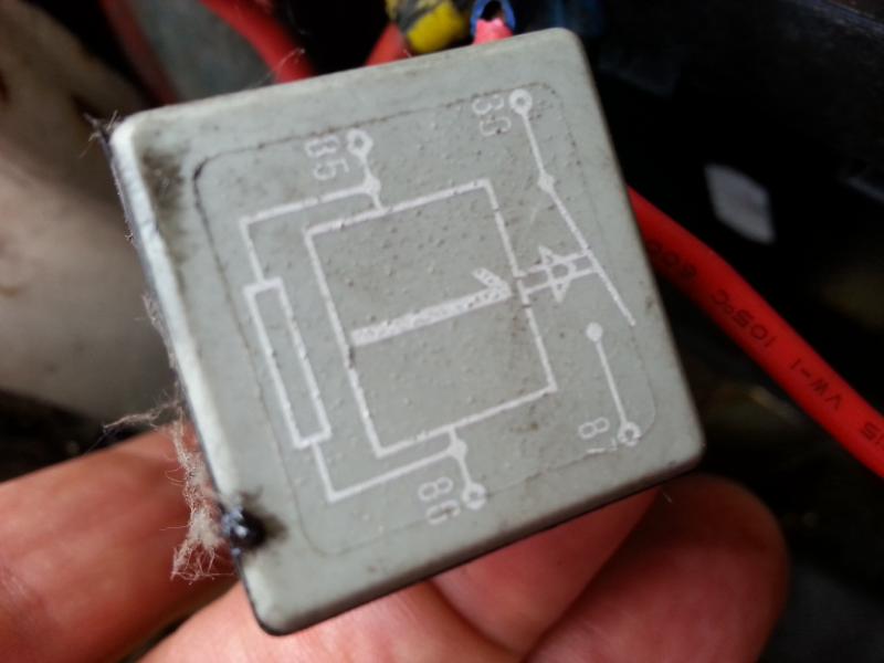

Well, after being unable to work on my van for a while, I finally fitted a new starter yesterday (£45, including delivery from France, via Mister Auto) and the instant I connected the battery leads the engine started cranking.
That suggests to me the relay is at fault. The only trouble is, I can't find it. Does anyone have any idea where it is? There's something wrapped up inside a mass of electrical tape near the battery that the thin red wire from the solenoid passes through ... might that be it?
It certainly looks like a relay, now I've uncovered it's face. There are four wires going the other end of it, including the thin one coming from the solenoid.
Is there any way of testing it? All I can think to do is removing it and checking the 12 v at the solenoid end of the thin red wire is no longer there.

When I finally removed the relay and shook it it had something rattling inside. I subsequently tested it and it seems dead.
It's a 40 A VW relay and when I searched for a replacement it turns out it is for "intake manifold heating" on Polos and suchlike. How it found its way onto my J5 starter circuit I have no idea, but the terminals are all different sizes, with dedicated connectors that look original.
Maybe it's more of a 'general use' relay than it claims. I'll buy one, fit it and see what happens.
Disconnect the relay and see does the starter stop turning when you reconnect the battery? If it does then you have the correct relay?

Yes, I did that, and the starter didn't turn, so that relay must be the one.
I took very careful note of the positions of the leads. Two of the connectors are different sizes, so there is little option where they go. The earth one is tiny, and it came from, and only fits on, the pin that is directly opposite 87 on the face of the relay. This doesn't seem to tie in with your numbering?
If you can get a relay identical to the one you have, go pin for pin.
If you have to use a relay with connectors all the same size, my pin numbering will work regardless whats in the relay box.

Although I found loads of used relays that were exactly the same as mine on Ebay, I wanted a new one, and eventually tracked one down at a VW site. I was offered a 40 amp one with all the same size pins at my local car bits shop, but I didn't fancy having to fit new connectors on all the leads.
I still don't understand why a relay listed as being for 'manifold heating' on a small range of VW cars should be where it is on my J5, though.
