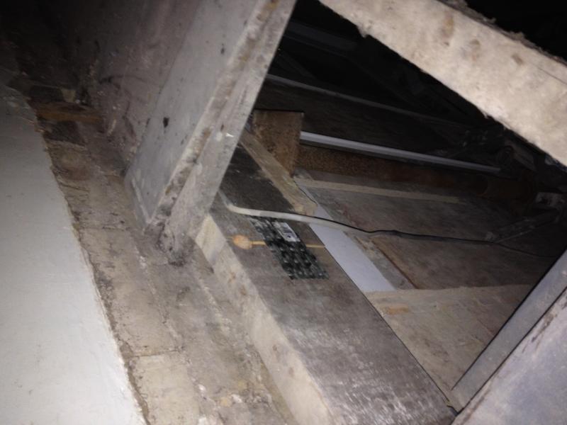

I've racked together joists using a nail plate. I have only done this on one side as I cannot get to the other side because of the wall.
I have bought a meter length bit of wood which I will use to span the joint and bolt using M10 coach bolts and nuts.
My question is should I be buying a certain type of wood like a hard wood as it's structural or will a meter length from my local timber yard do?
Noseall- just seen your reply and this sounds I better idea of using a trimmer to pick up the last cut joist.
You mentioned using sleeve anchors to fix the trimmer into the wall but how would I do this if the trimmer is going head on into the wall?
I'd use a joist hanger for the end on the trimmer that goes onto the full length joist, but the end that needs to be fixed to the wall?? ...would I use a masonry to timber hanger or fit a ledger board and then use a hanger off this?

Joist hangers (jiffy) will be fine each side of the trimmer piece. Make sure you fix the jiffy's to the trimmer first as you will not have access to the back fixings.
Ive tried to fix this joist this weekend, but the joist hanger I was going to use to fix to the trimmer to pick up the 1st floor joist gets in the way of the masonry hanger in the wall. This is be uses the joist is too close together wall.
What I guess I'm after is a type if L bracket that I can fix to the trimmer then it turns 90 degrees to pick up the joist. However I can't find anything on the market.

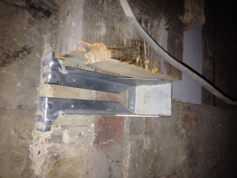

Below is the masonry hanger I plan to fix to one end of the trimmer going into the wall
The problem I have is the two hangers that connect the joist to the trimmer clash with the masonry joist. All I can think of is to use an angle bracket and fix on the one side
That's the type of device I was alluding to earlier except the strengthening gusset is in the center.
Don't know where you would buy it though. I'd make it in about 10 minutes in the workshop.
I have cut out the pocket and and ready to cut the wood. I just wondered if the 50mm deep pocket I have cut is sufficient or whrher the trimmer needed to fit on the full width of the 100mm wide brick?
Finished job. I sat two trimmers side by side in the end of the full width of the 100mm brick and used joist hangers to secure everywhere else. Feels secure.
