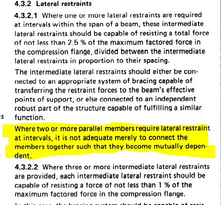

Hi everyone, I'm in the process of starting out with an extension to our property that will involve knocking through the rear wall, with the intent on creating a large open kitchen/diner/living area.
Architect is on with the plans now, and we'll be getting an SE in to calculate steel requirements and foundations to make sure it's done properly. However, something as important as my home, and as it's a structural change, I always want to understand what is being done, and more importantly why, before the experts get started. Just so I have at least some idea of what they're talking about.
The span when we knock through is going to be 6 metres, and with a large opening like this, isn't there a risk of the beam buckling? One other concern I have is that the house is quite high up in the pennines and is exposed at the back. I'd expect this will be taken into account, but to what extent will this impact any design?
I'm sure a bigger UB would help to prevent this, but as the blocks in the wall that will be supporting the beams are only 100 mm, doesn't that limit the size of UB we can spec? Or is it acceptable to have part of the flange 'overhanging' the block?
Alternatively, will the two beams (for inner and outer cavity wall) be connected together to offer additional strength against the buckling? If so, what is the best way to do this?
I know a lot of questions, but it'll really help me get my head around what's being done and, I hope, limit some of my anxiety.

The SE will specify the beam(s) to prevent buckling. You can either do it one wide-flange beam, or two separate beams.
There should be no need to bolt two separate beams together; in fact, the design Code specifically prohibits bolting two parallel beams together if the intention is solely to prevent buckling. Yet we still see builders, architects and inspectors asking for beams to be bolted together...?

Why is bolting the beams together prohibited? Genuine question, I presume that means that bolting together is worse than now, but can't work out why. Thanks!

So, regarding the bolting together, is it that it's not that bolting together is bad, but if the aim is solely to prevent buckling, then it's not the going to work.
that's not what he said, to me it sounds like, if the sutionation is that if they are not bolted together then they would fail on buckling, if they are bolted together, that is not an allowed solution. But if they wouldn't fail on buckling then feel free to bolt them together.
Steel beams can be subject to buckling over long spans, particularly those with relatively narrow flanges. In normal bending, the top flange is subject to compression and can fail by buckling sideways long before the steel reaches its maximum allowable stress.
The way to stop it is to rigidly hold the top flange in position, eg by mechanical fixing of floor beams on to the flange. It's not allowed to restrain two slender beams by bolting them together through the webs with spacer tubes - it's been described as like two drunks trying to support each other from falling over.
If the SE designs two beams, one for each skin, each beam should be capable of resisting buckling forces on its own (if they are welded together by top and bottom plates at intervals, that can be acceptable as long as the welds are proved strong enough, but site welding is not recommended because of quality- and safety issues.)

tthe sutionation is that if they are not bolted together then they would fail on buckling, if they are bolted together, that is not an allowed solution. But if they wouldn't fail on buckling then feel free to bolt them together.

Ive done a few jobs where the SE has specified 2 beams with spacers -I couldnt say though that each beam was strong enough to take the deflection on its own, perhaps that was the case.
I did one job where the SE specified different height beams, which was a pain.
If the SE was hoping that by bolting the beams together through the webs he would somehow even out deflection between them, he should go back to college.:LOL:
