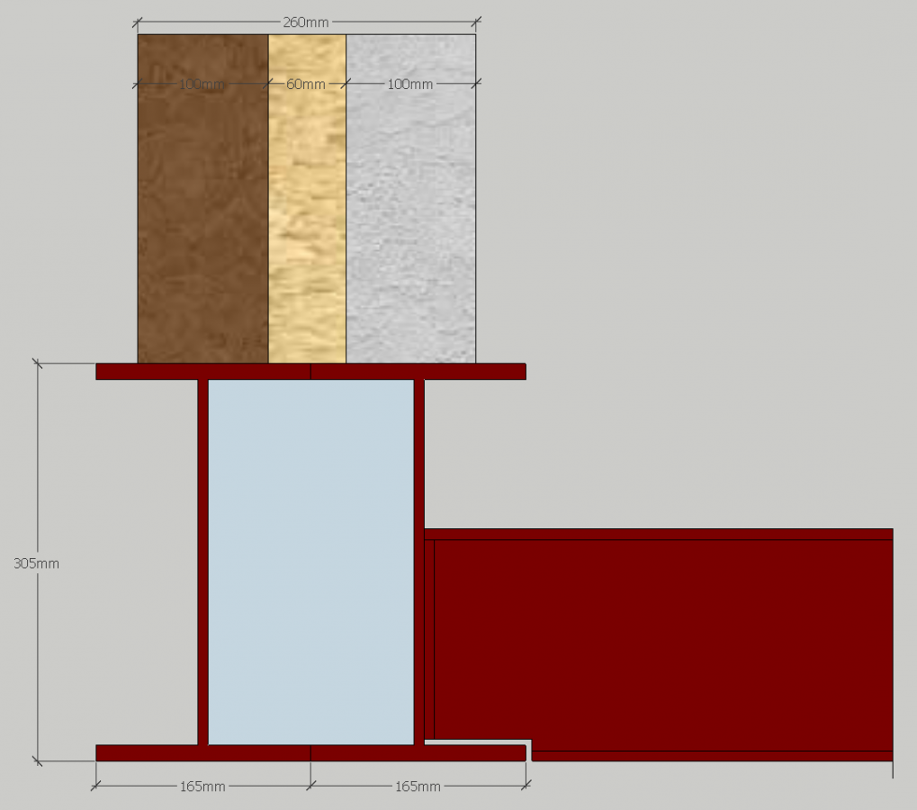

Steel bean cavity wall sizes
It's 7 in the morning and I haven't had my three coffees and 4 fags yet but from what I can see he's designed the beams to act independently.
One of the problems with long beams is not so much excessive stress or deflection, but lateral buckling (ie they can tend to twist sideways before they
fail in other ways).
The only way to prevent this is by full- or partial restraint of the top flange. He's allowed for this on the inner beam because to an extent it restrained by the incoming beam, so will not be able to buckle sideways, but not so the outer beam. Strictly, there can be no criticism of his approach on a purely structural basis but it still gives excessively deep beams for a domestic setting where headroom is important.
One way round this problem is to have one wide- flange beam instead of two narrow-flange beams. In that position, I would have tried a 'column-section'. These are 'H'-shaped beams which are as wide as they are deep. Typically, that span and loading could be accommodated by a 254 x 254 beam. It would be heavier than two separate beams, but could be supplied in two or even three lengths and bolted together in position (though that adds to the cost).
Swings and roundabouts really, but in this case, I would have pointed out to the client the issues involved and let them decide - shallower (and prob. more expensive) beam; or deeper and more intrusive beam?

I'm no engineer, so can't comment on his calculations, but it's the design of the beam that sits proud of the house that I feel needs addressing. Looking at his reply, he's either done a simple calculation without any thought for the ramifications, or isn't experienced enough to consider them. Either way, if he won't help you resolve the issue, then you need to query if he's done his job properly.
It sits in an internal location.
The other pair of beams (external wall) can sit on a deliberately wider cavity wall, i.e. build the return piers with a 125mm cavity.

Getting builders quotes for a single storey rear extension and it has been pointed out to me the the SE has specified 2 x 305x165x46 UB for a cavity wall that has a total width of 260mm. I have drawn it out below, does this sound/look correct?
The span is quite long at 6.5m and it also supports an internal structural wall and the new roof of the extension. The beams are planned to be above current ceiling heights.
