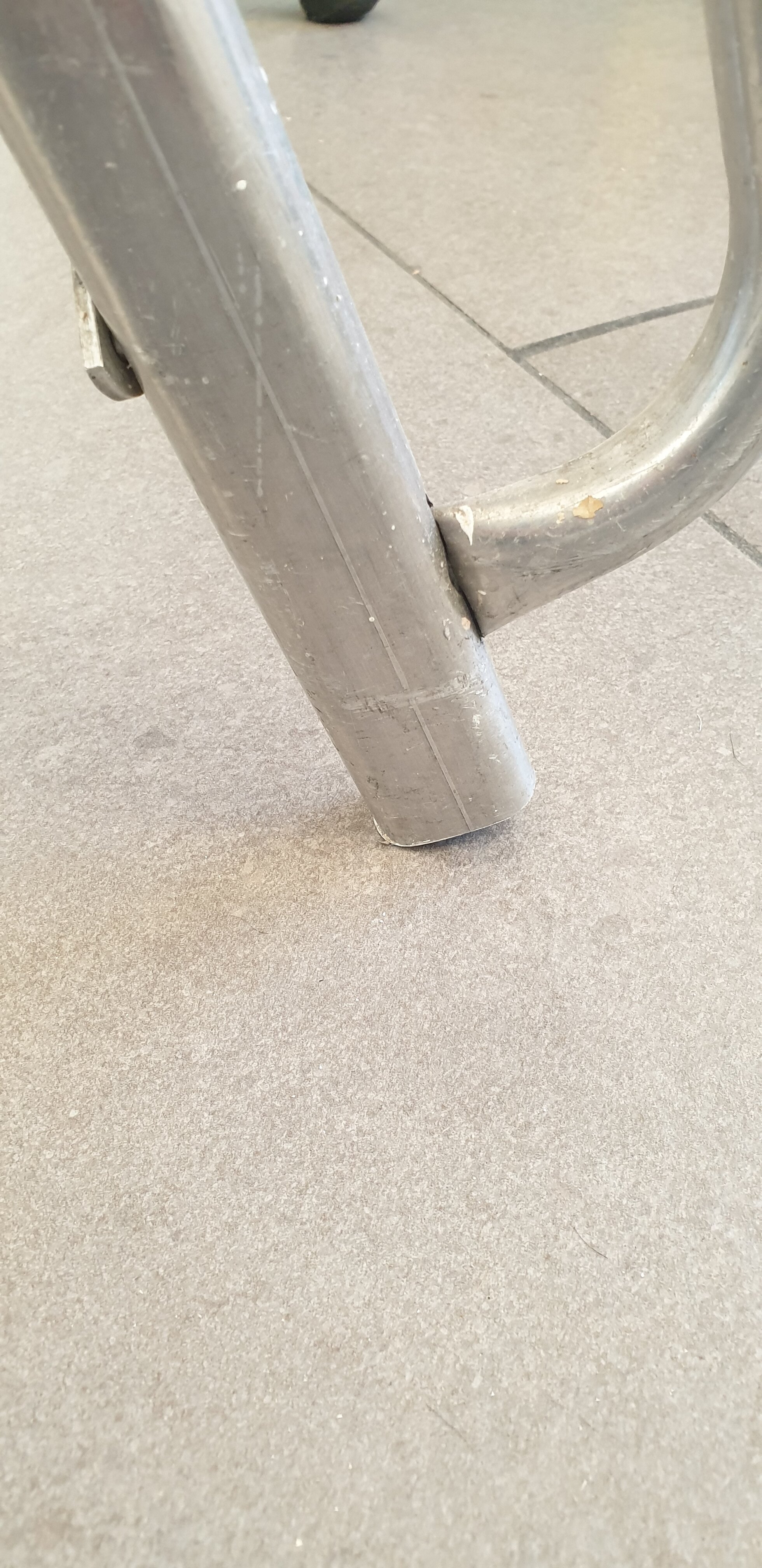

Had a step ladder for a while and unfortunately the plastic foot inserts at one side have eventually broken, leaving the bare metal edge:
This is damaging some of the wooden floors at home, unless I use a metal sheet underneath (which is a pain to remember, keep moving around etc).
Any idea what I can use to make a more permanent fix? Looking for something small that will protect the floor but not fall off.
Angle brackets, pop rivets or selftapping screws, piece of 3 x 1in planed softwood. Fix angle brackets to legs, screw softwood (or even a rip of 18mm ply) onto brackets
My original loft ladder, used to mark the landing carpet, despite the soft plastic ends. I made up a pair of wooden shoes, bolted to the ends, free to move to match the floor angle - problem solved.
If you send me a drawing of what you want with dimensions, especially the internal size of the ladder legs I should be able to 3d print you one in black PETG. Its the same stuff they make lemonade bottles from.
Use door mats. Put mats back after use to avoid conflict with the spouse.
Solvent weld some off cuts of rubber matting

Make four wooden stakes and tap them in the bottom, then cut them of to the desired length. Small screw through the side to hold them in position.
