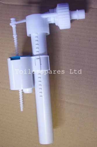

Have loo with concealed cistern, fill valve keep sticking shut and does not seem to have enough weight on it to open after a flush, is it feesible to add a few washers to the top of the float to aid movement?
As for changing I am stuck with one particular model as tank design leaves no room for anything bigger and am working thru access panel only 160mm wide.[and have changed three times todate , all exhibiting same problem. ag1378-inlet-valve-935-p.jpg
Unlikely to be a weight issue, more likely low water pressure. If the WC is run off a cold water storage cistern, rather than off the mains, then the reducer which fits up the stem of the valve should be removed.
