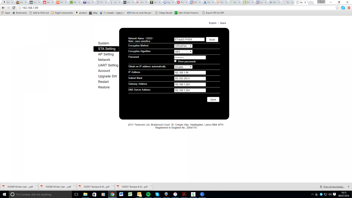

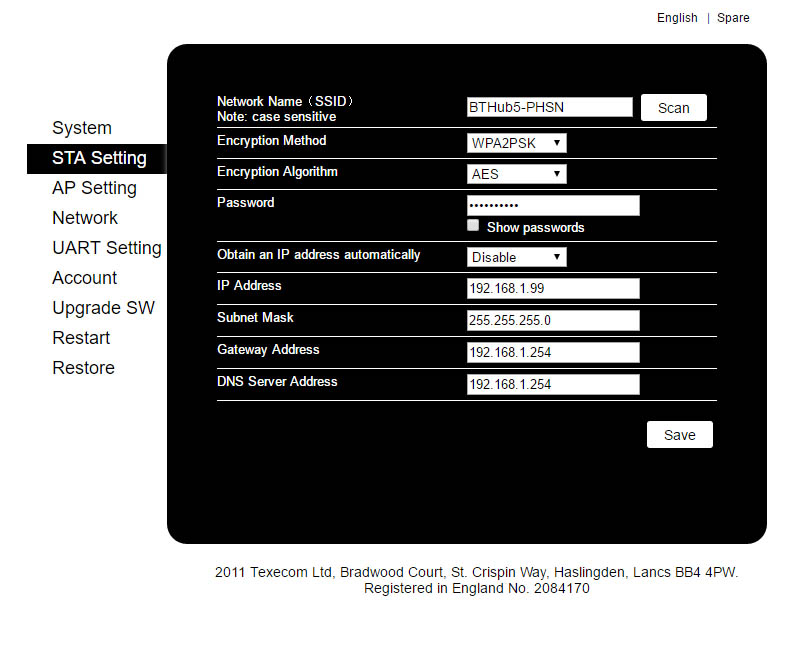

Paul Uszak - Thanks for the response. The Com wifi does have a static IP address . Mine has had 191.168.1.99 from the start and I have made this static on the BT Homehub 5. At the moment the app is working OK and I used 'Net Analyzer Lite' on my iphone to ping the Com Wifi and got a response (average response time about 30ms)

The response from Texecom is:
This suggest the com-Wi-fi is still being dropped off the network. As such when you made the changes to the BT home hub it then stayed on longer. Wintex would not be able to connect when you cannot connect with the App as they both rely on the same connection method.
I would suggest fixing the IP on the panel and Wi-Fi card so its not on DHCP and seeing if this has any impact on it.
Would it make any difference if I selected a static IP address outside of the DHCP pool (I assume not as a static address shouldn't change whether inside or outside of the DHCP pool). Also I dont think this is affecting my set up but I do also have a second router set up (an old Linksys) as a repeater as its an old house and the wifi was patchy. However the Comwifi is picking up the BT homeHub as that was the strongest signal.
