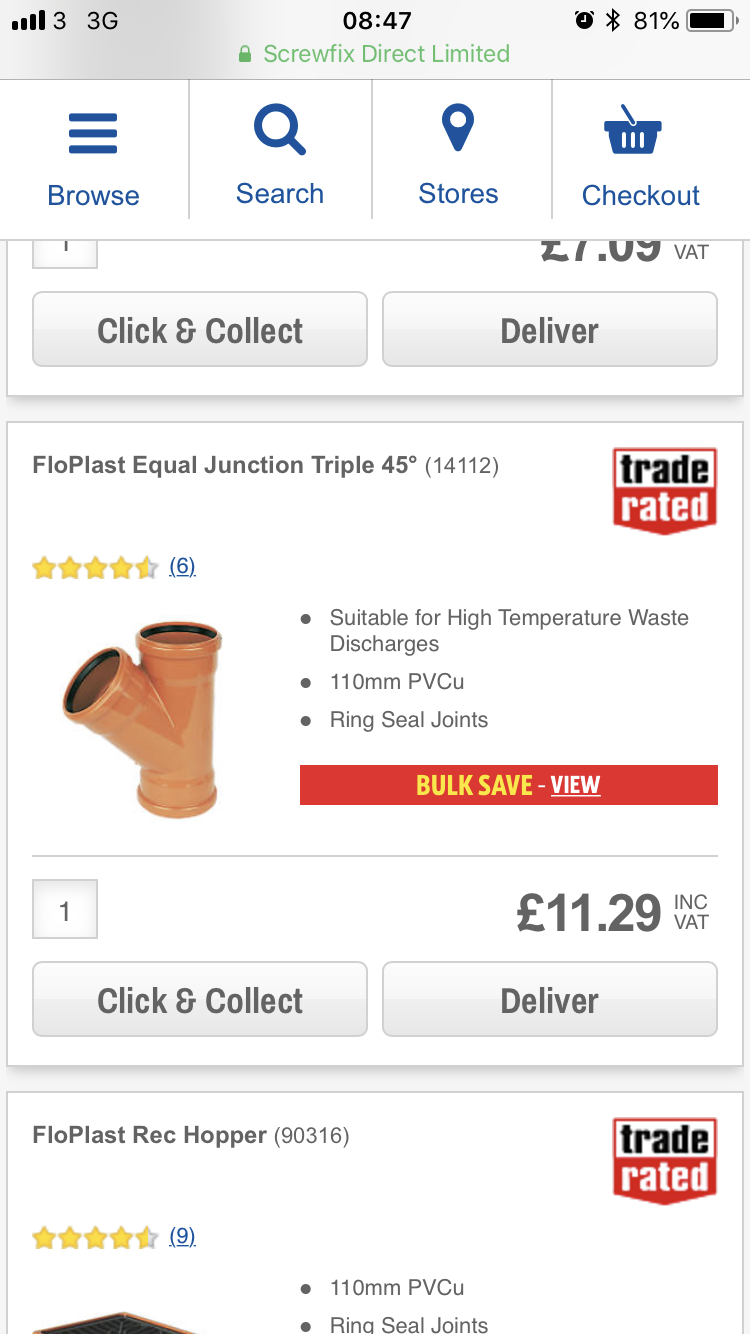

As you've indicated on the last pic would be fine, gulley can connect on a junction, with the branch at an angle if easier. Just make sure you cap the redundant pipe to prevent any possible use by rodents. I would be interested to know what's under that slab, it looks in exactly the right place to be a chamber.

just regarding the junction I’m going to fit... would you sugggest a mini chamber (I think they’re called?) or is there something that is buried that I use?

Given that at the moment, the run is 'blind', I'd personally fit a mini chamber. Gives you rodding access up and down the run. Appreciate its extra cost, but may save you in the long term if something blocks up.
