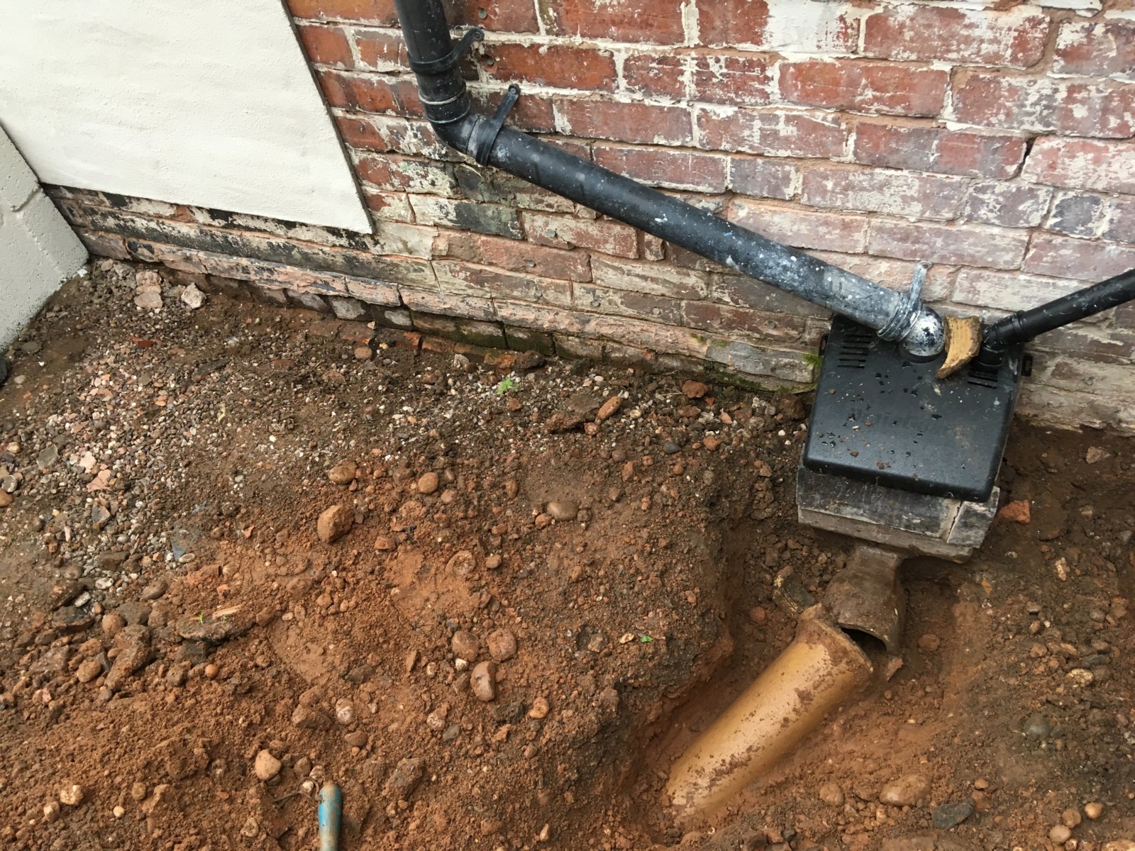

Hi guys...
So, i recently posted about water spilling out of my gulley... Ive built a surround for the gulley, fed waste pipes into it deeper and covered with a leaf cover... all sorted.. or so I thought.
I still have damp along the brick line of my house.. Both soil pipe and drain pass along this wall ( as you can see in the picture).. so i'm guessing that something is leaking underneath the ground... It would appear that the soil pipe is wetter......... but the whole stretch seems pretty damp.
Does anyone have any suggestion where to start looking for leaks? We recently had a link fitted in the soil pipe to negate an old joint and Im wondering if when the chap (CLOWN!!) was doing it he's disturbed something and its slowly leaking. Im happy to get digging and see, but just wondered if from the picture anyone had any suggestions where to start..

I had a similar issue.....when I dug at the base of the soil pipe, there was a chunk of material missing out of the salt glaze gully due to heavy handling of the soil pipe. I was able to encase the thing in cement as a temporary measure but 6 years later it's still dry.
John :)
hmmm... i think im not going to avoid digging the whole lot out and exposing it all... I did hope it would be where the soil pipe goes into the crock but I cant see anything obvious...... that said, I need to have a proper look. My theory was it was leaking slightly there and running along the brick course.... but it all seems so wet...

dig them out. Quite likely both have cracked and broken where the clay bend or gully turns from vertical to horizontal.
I'd say it is so common as to be universal.
Perhaps there is a district somewhere in the country where it doesn't happen, but it looks like you aren't in it.
You see where the mortar is missing between the bricks? That's typical of long-term leakage. While you're working, hose out the mud and grit, and re-point them fully. You can get a mortar pointing gun now that makes it easier than using a tiny trowel.

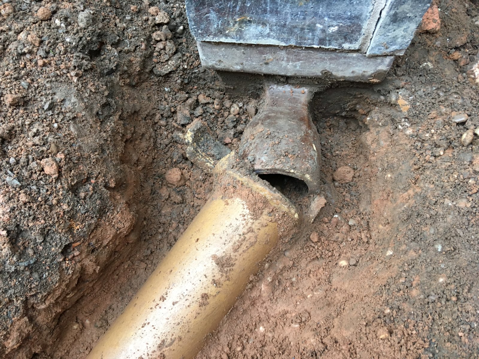

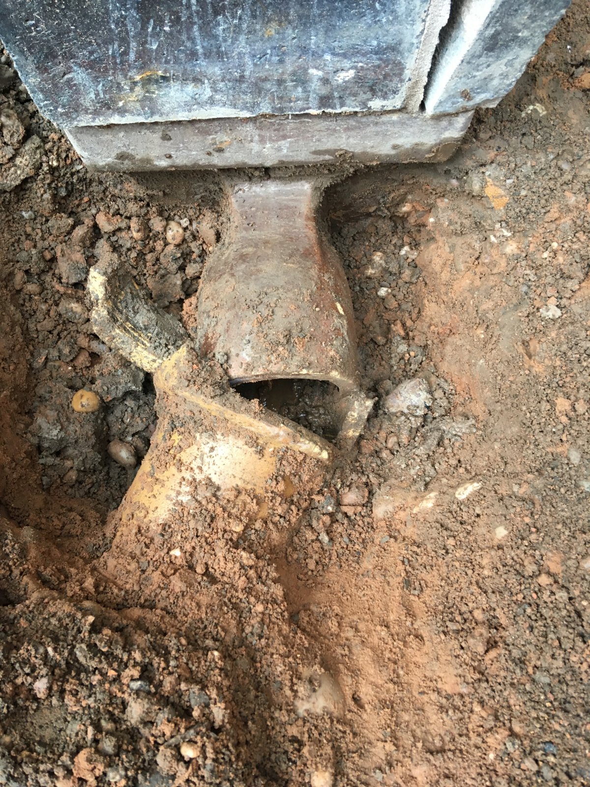

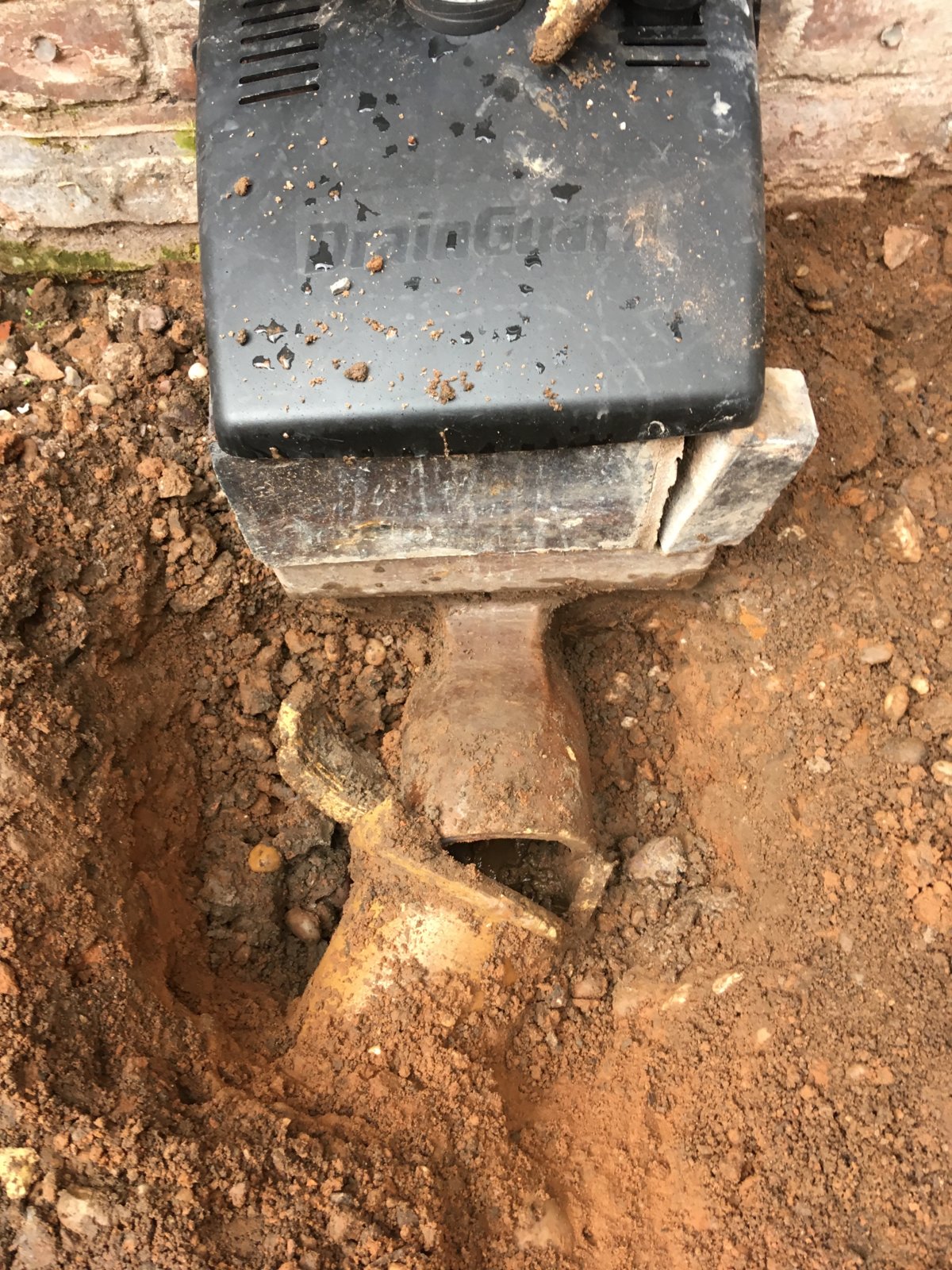

So.. I just wanted to make a little update on my post, as so many people offered some fantastic advice when I initially posted it.... Finally, today, after finishing numerous other jobs, I had some time on my hands after work so thought I would start digging a bit just to start tracking the route of the pipework and......... came across the issue in the picture...!! Now... from the soil that Ive moved so far it would appear that water is coming out of that break, back towards the drain grid, and running along the house... (my theory).. As ive started, do people think Im best served to just expose everything I can within reason and check it? At the moment Im looking to replace the joint and maybe the grid?? What are your thoughts guys??IMG_0998.JPGIMG_0999.JPGIMG_1001.JPGIMG_1002.JPG
If it wasn’t too hard to dig I would carry on to a point where the gully and soil pipe drains meet and replace the lot with plastic.
Use an AC4000 to connect plastic to clay and an DC115 to connect the plastic to cast.
Thanks for your reply Ian... I was thinking of changing the gulley as-well, as I cant be sure that even that isnt cracked at the back as its backed up to the wall.. I am wondering how there was ever a secure joint between the pipe and the gulley with it being at such an angle..
