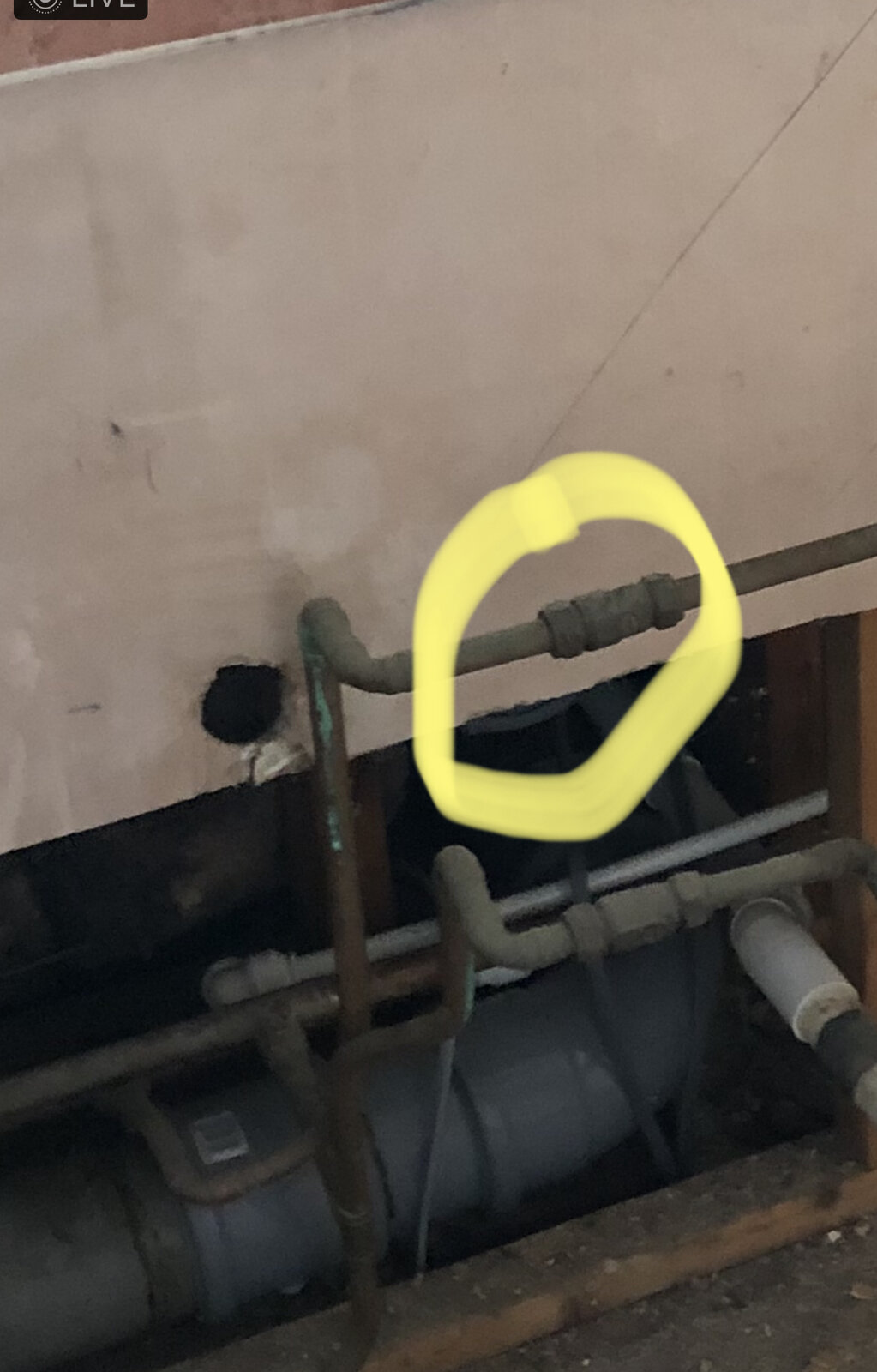

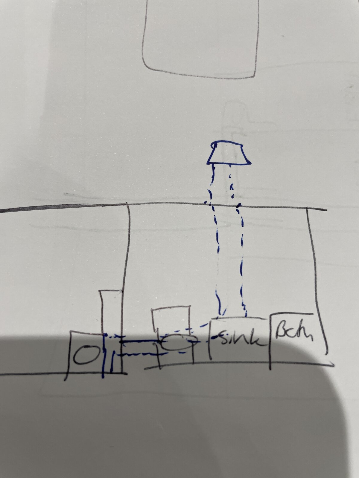

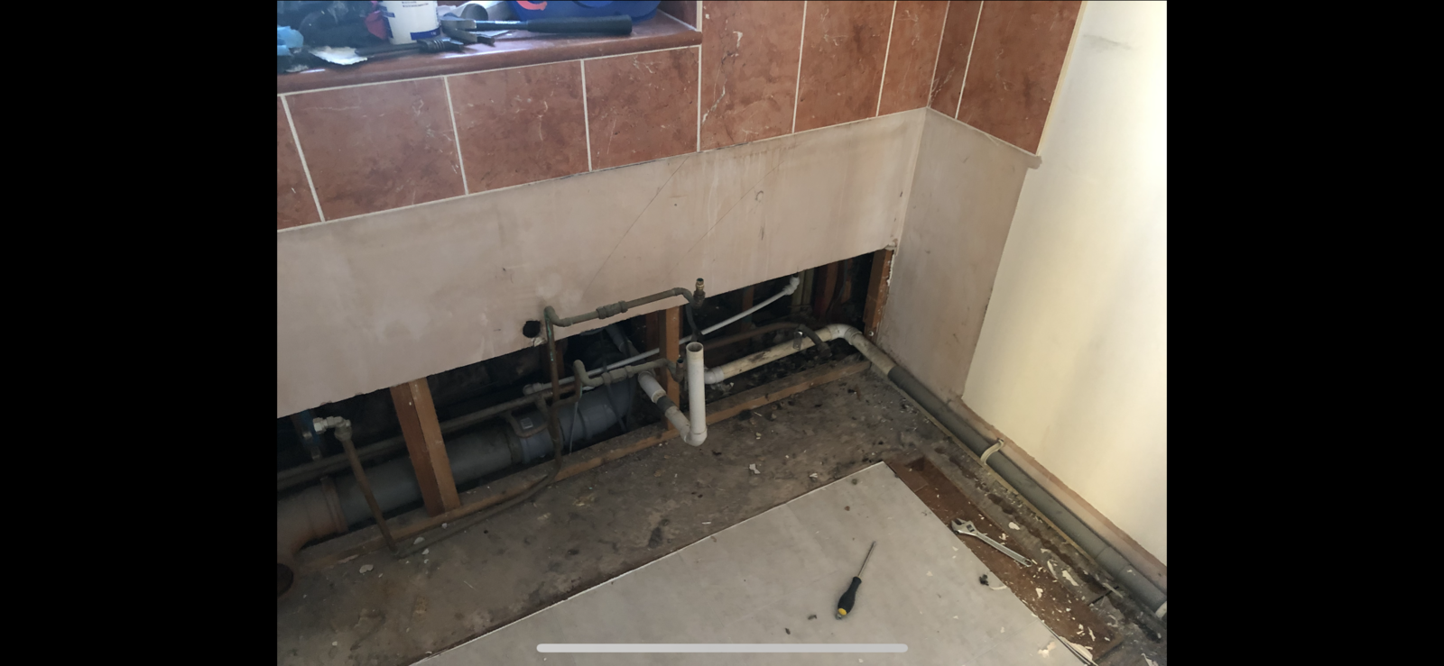

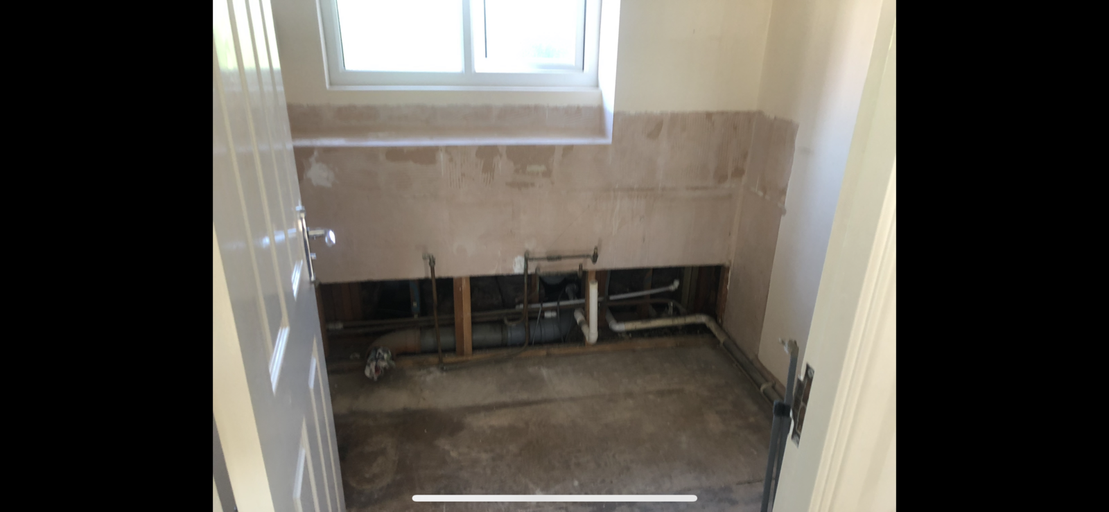

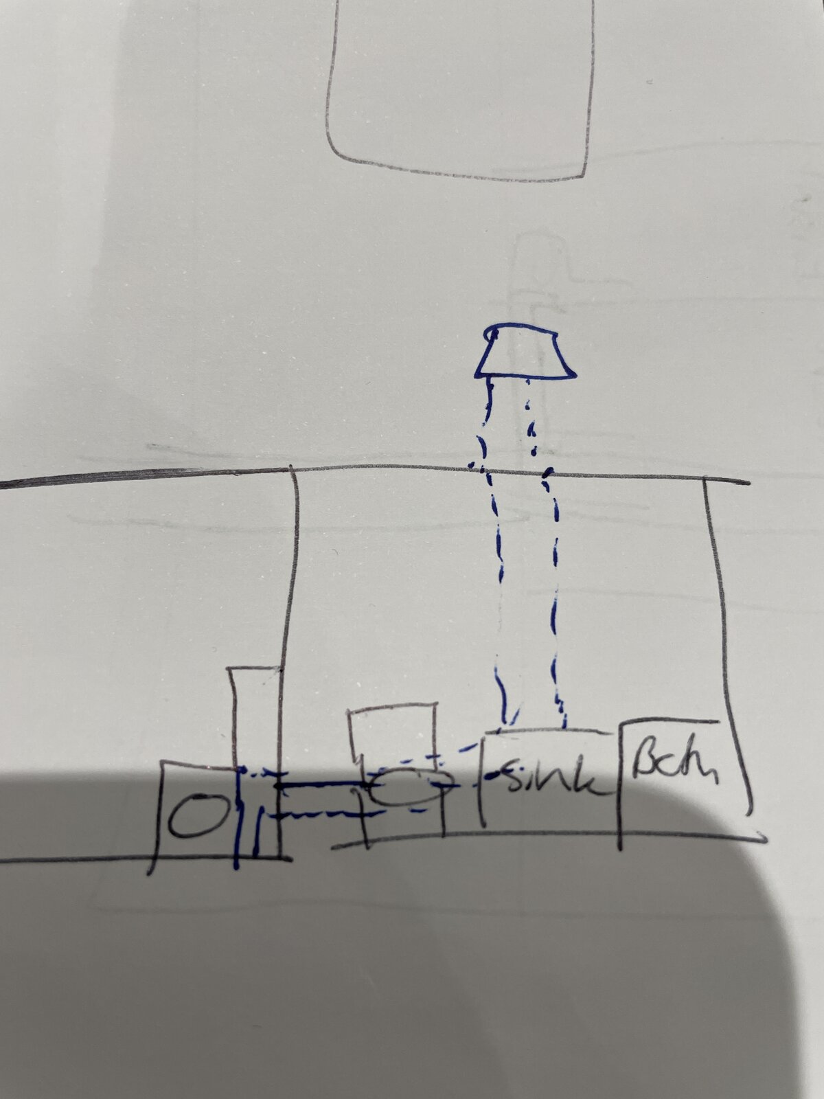

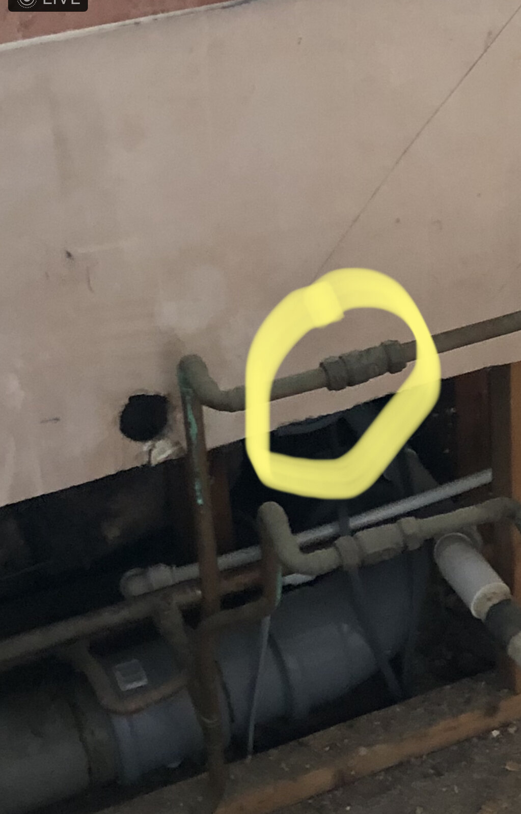

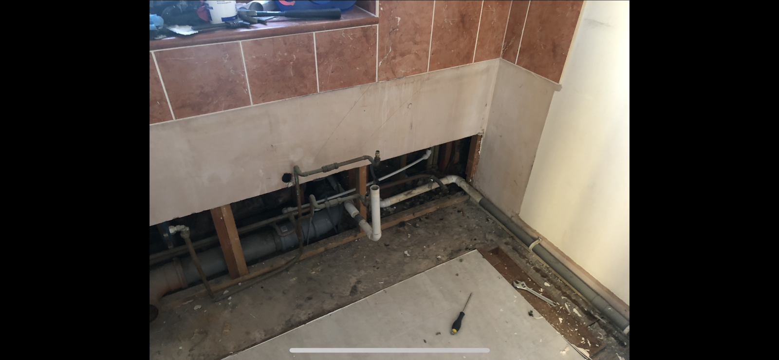

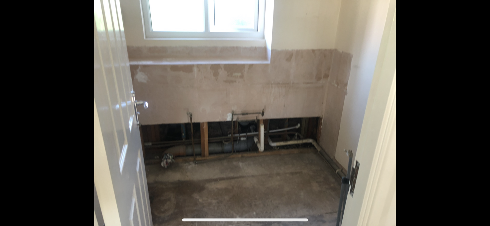

hope the picture below shows roughly the connectivity between the 2 bathrooms.in the ensuite the toilet faces the left which is why there is a 90 deg Bend in the wall before connecting to a straight into family bathroom. The toilet in the family bathroom also has its own seperate soil pipe. See pics of family bathroom that was hidden in the back before tiled up. You can see the toilet soil pipe. I think the ensuite soil pipe runs behind that

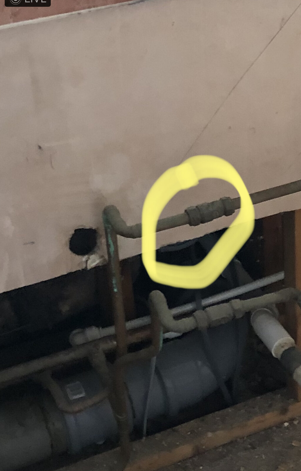

if you take a look at the last picture zoomed in. I can just about see a grey pipe at the top circled in yellow. What I don’t know is whether that was where the old stack was connecting upto the vent in the loft and since the extension they routed the soil pipes to somehow connect at the flat roof. So I am not sure whether the vent in the loft is even connected. Is there any way to test if the vent pipe is connected to system?

Might be worth talking to a local drainage company, see if they are able to put a scope down the pipework whilst the WC is removed and see if there's anything untoward hiding in there that could be causing an issue. Afraid it looks a bit of a lash up in the pics you've posted, bits joined on and a mix of above and below ground 110mm fittings appear to have been used. Not a major issue as all boxed in, but not best practice in my opinion.
Also looks to be a poor fall on the 110mm, which may well be a part of the issue if other sections haven't been installed with due diligence.

what’s your thoughts on the vent in the loft? Apologies I edited the previous post and added the below:

Can you see/find the vent pipe in the loft? Also, perhaps some external pictures with a guide to whereabouts the soil pipe runs would help pinpoint any possible troublespots.
