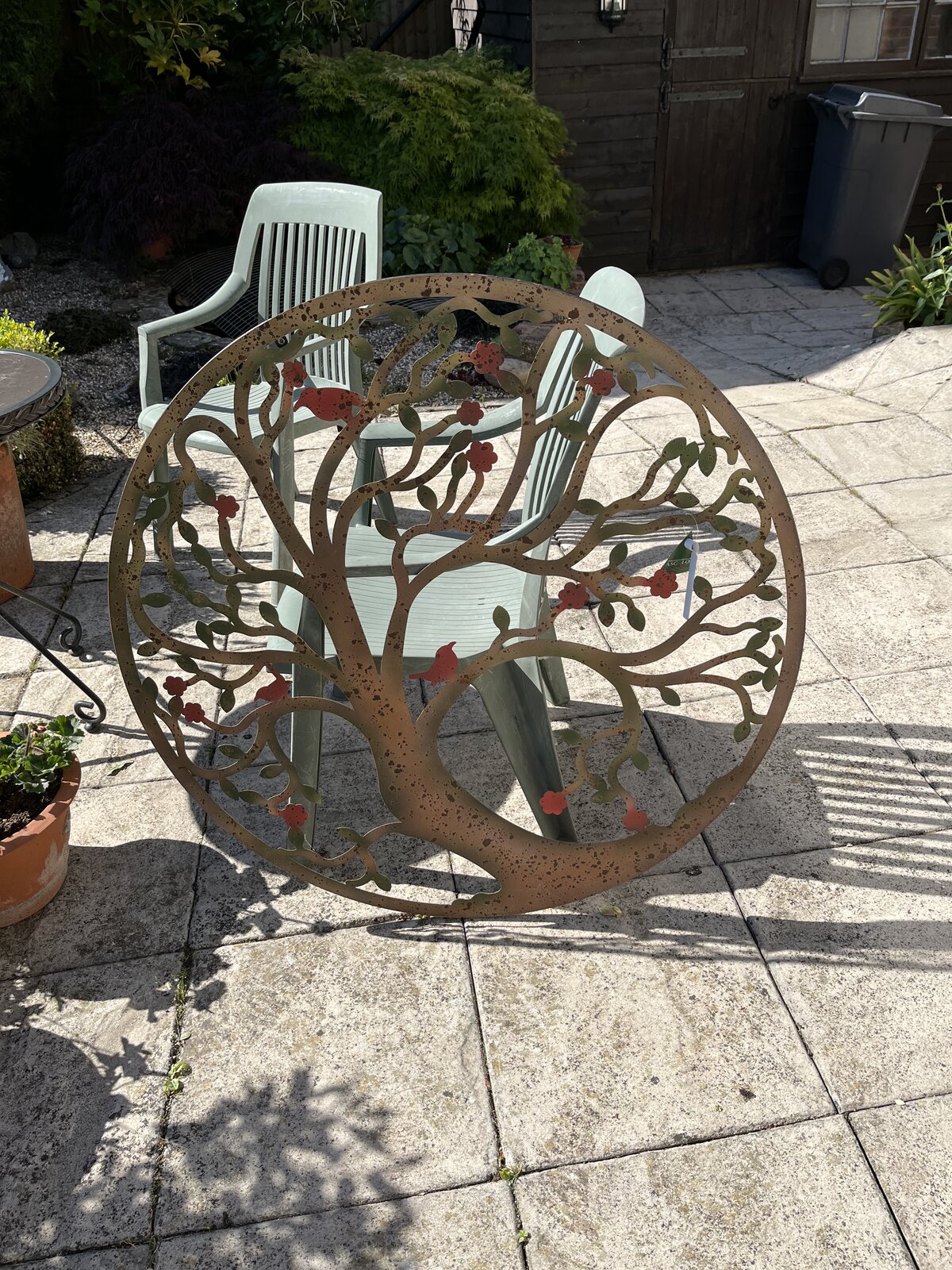

My mil has ourchased a decorative metal thing for other half to be fitted to a wall
But it’s rusty
I’m looking for suggestions on how to seal the rust without spoiling the thing
So when on the painted rendered wall we don’t get rust streaks all down the wall

I'd go for a thorough wire brushing, a coat of Kurust rust killer - which will turn the rust black - followed by some anti rust primer by Rustoleum and then an aerosol top coat.
Rustoleum products seem to be rather better than Hammerite for example in my opinion, but nothing is a miracle cure!
John :)

I have used KuRust last year on a garage door and it did colour the rust which is likely to spoil the item , as you say the rust will turn a different colour and unfortunately that was part of the appeal and colouring !!!!!!!!!
I was hoping for something perhaps Metal wall Sculpture's may use s this must be an issue
I was thinking of using same Boiled Linseed Oil which i have a loads of - and maybe that would need re-applying every years, which she can do!!!!!
So really it was just to seal up the rust , so as soon as it rains then the rust will bleed over the White/cream rendered wall she wants it fitted to - I will try and space it off the wall by 25mm
Something like 2K automotive clear coat may work. It’s potentially nasty so take care.
you can buy it in aerosol but use PPE
there’s a custom car/ bike trend for rust to be used as a patina effect under lacquer
i'm not sure - it was purchased from an expensive nursery in Essex, and cost around £70
I saw a few smaller decorative things yesterday, with a similar patten, of rust , when visiting the mother-in-law and they had the same rust spots - so now , you have made me think, I'm wondering if the rust points are part of the decoration !!!! and NOT actually real rust.

I rubbed my finger over them before wrapping up to come home , and nothing came off
Did the others in the shop have a similar pattern? It just seems bizarre they would sell something that's just gonna go rusty. It's surely meant to be used as an outdoor thing?
they only had some very very small items , not a plate like this - almost like a small box, but very similar - should have taken more notice - I was asking the store manager if they had a problem with rust on this type of thing, they said no , and no idea how to seal
So now i'm beginning to wonder if its rust

oh well, after discussion this morning and deciding exactly where on the wall to place
She has chosen to linseed oil , as we already have a lot of that , and then see how we get on
thanks for all the advice and ideas,
she has decided if a problem, she will just hammerite it all black !!!!!!!
