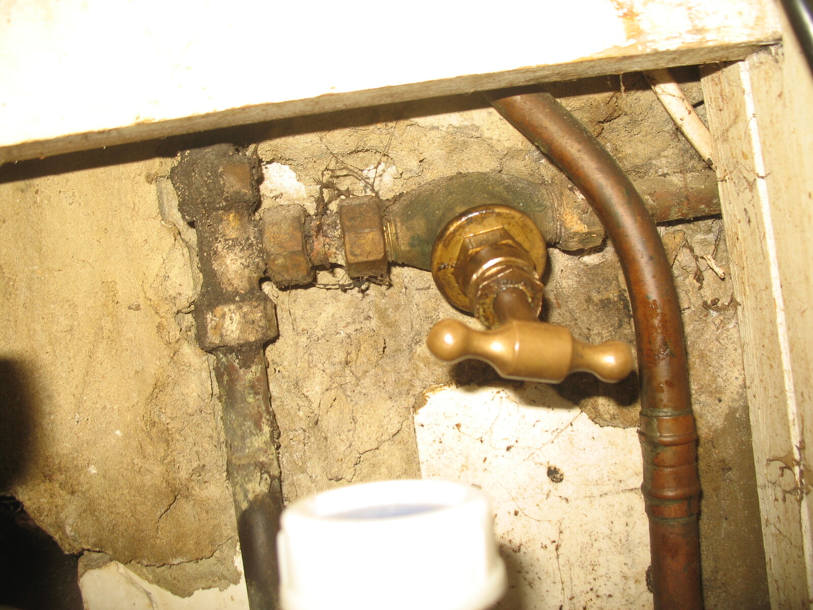

The tap is probably 30 or 40 years old (maybe more!), are they a standard size?. The main feed into the house hasn't got a lot of length before the tap so I don't fancy removing the body if I can avoid it.
You've got the board's external tap so go for it... You can always lube the existing and put it back in if you have grief.

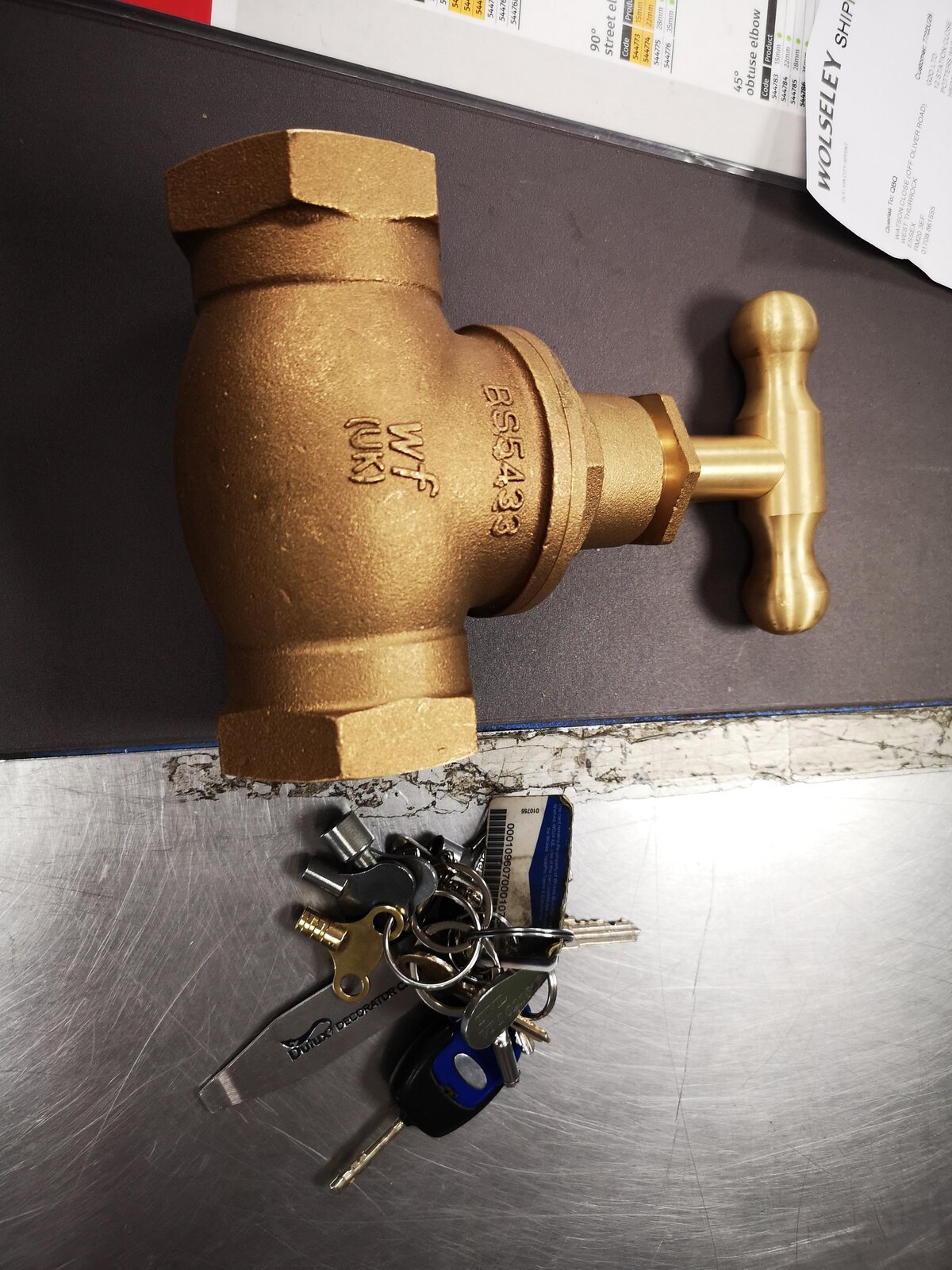

Try changing one of these...
Thanks to all for the advice/ info. It's def not a gatevalve!

Here's a photo of the offending stopcock. Access is actually more awkward than the photo suggests and the adjacent pipework/fittings don't inspire confidence to interfere. The right hand nut on the stopcock is actually hard against the copper pipe in front, the pipe would have to be temporarily removed to get a spanner on it.
