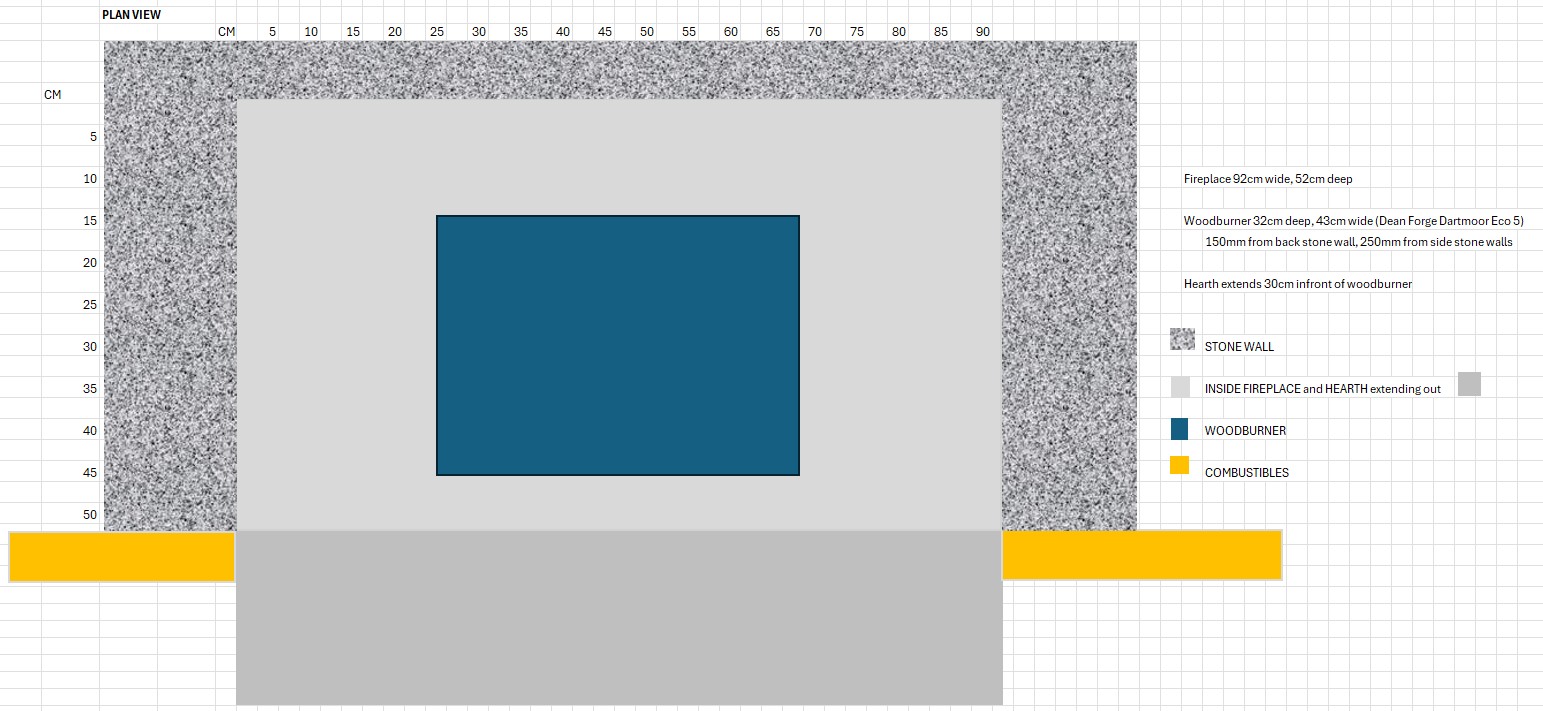

Hello,
I am looking to install a stove in a stone cottage, the fireplace is clear of combustibles, liner in place. The stove sits inside the fireplace, which is deep enough to fully house the stove (see diagram).
I am not sure how to interpret distance to combustibles to the side when the stove sits inside the fireplace. Distance to combustibles is 55cm to the side, the stove is 25cm from the stone wall either side. Does this mean I strip away the combustibles on the wall outside the fireplace a further 30cm?
I have a similar question about the flue, whether combustibles on the wall outside the fireplace count, when there is a stone wall in the way.
Thank you,

Looking at your diagram, by combustibles you mean skirting board?
Leave it as it is, I've seen a few hetas installed stoves in other people's properties, skirting board left as yours is, stops at the edge of the hearth.
At the end of the day someone is going to have to sign it off, either Hetas or building control, if they have a problem with it then it's a simple job to cut it back.
Combustibles on the wall won't be a problem either, but they will need to be clear of the opening by whatever the regs or stove instructions say. Some people want a timber mantelshelf above the opening, this will need to be a minimum distance from the stove, quite often a steel heat shield is used to form a barrier underneath.
