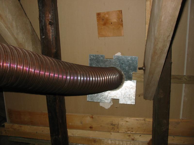

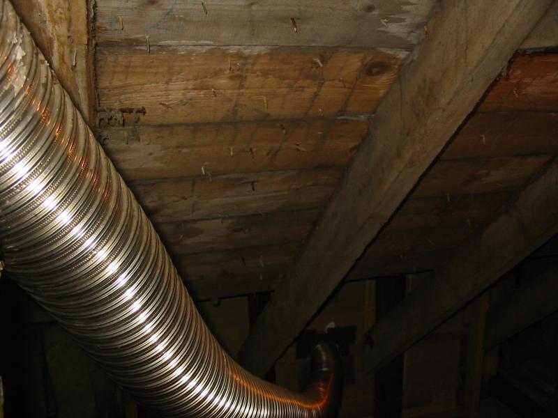

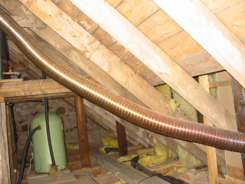

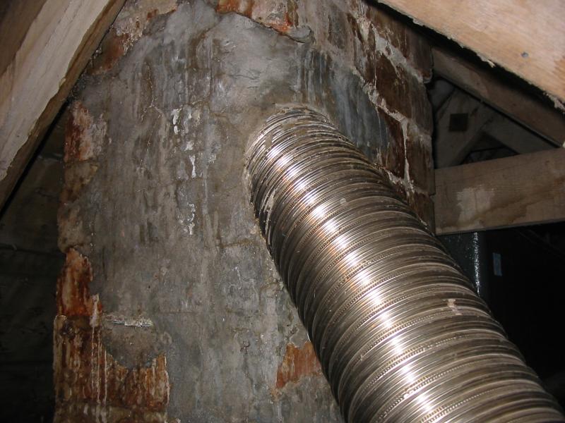

I came across this unbelievable stove installation when I was called to sweep the chimneys serving other solid fuel appliances in the same house. I explained to the homeowner one or two obvious problems with the stove installation :eek: and advised them never to use it. I posted out a quote to properly install the stove but have heard nothing back, oh well I suppose they know better.
Bet the loft is toasty warm. The spiders will appreciate it if nothing else :confused:
thats amazing.... flexipipe across a roof void intoa masonry chimney... dare I even ask what protects it up through the house?

You can see timber within around half an inch of the liner where it passes through the wall.
A flexi liner is for re-lining class one chimneys.......it's not to be used as a primary lining system. It should have bends no greater than 45 degrees...........it should be well away from combustibles.........
In 15 years time when that liner is buggered and it breaks in half an flops down to the ceiling it would most definately set something on fire.....thats if it doesn't in the meantime.
